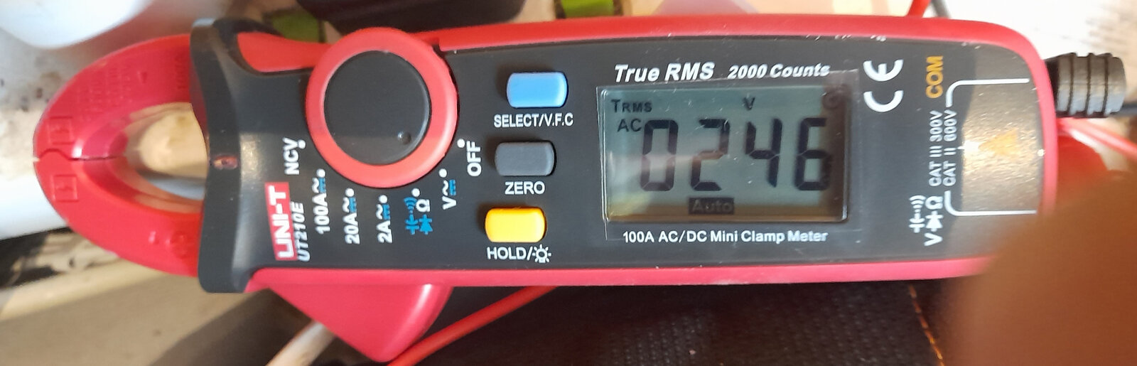

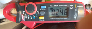

For many years I used a Durite meter which one held onto the cable it had two positions to place cable, one for charging and one for cranking, very basic meter, and not accurate, but did the job, today I have a clamp on meter Testing voltage.jpg but limited to 100 amp, so still tend to use the old one first. As to what a multi-meter able to read 500 amp would cost not sure, but really does not need to be accurate, Screwfix to get 400 amp DC looking at £81, and no data hold. So this 1673535137349.png type is to my mind good enough. But it seems Durite no longer market them.
