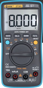

Settled on a 8000 count for under £19 from china. Given the price, I might get 15 day delivery. Getting this mainly for the MAX/MIN and greater precision than the meter I have. If I didn't need a better meter, I would have gotten a dedicated battery tester that has absolutely everything for the job.
From what I could see, most meters have sampling rates of 2 or 3 samples per second. This means MAX/MIN may not always pick up the right readings. Still, having this is batter than trying to pick them up manually as I am doing now.

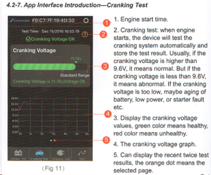

Although one can pay a lot for bluetooth battery monitors which have all sorts of bells and whisles, there are also a lot of cheap ones out there, many of which use a cellphone 'app'. Given what you have said of your interests, I thought that one which did something like the pic below might suit you. It comes from a US ad for a device which currently costs $29.95 (a bit over £25).
Also, in view of your previously-voiced concern most of these things seem to claim a current consumption of about 2 mA (about 0.024W at 12V), which you might find reassuring.
China tool is better: load test, IR, CCA, MIN/MAX, graph, volt meter, and it doesn't need additional devices to be used.

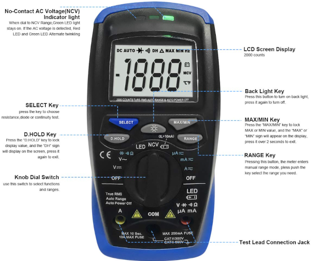

China is slow at processing my order. So, I jumped ship to amazon for cheaper and 3 day delivery on a 2000 count. They also throw in the batteries, all for £14.25. The money saved goes towards a set of carbide grout removal bits.
