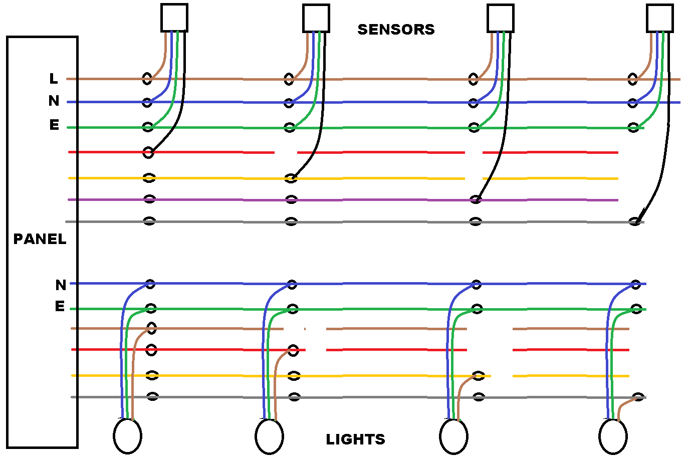

Hi and thanks for all of your advice, (y)!
I think your post is agreeing to most of my idea with the following changes...
I will split the lights and sensors into 2 circuits as you suggest, thanks, this will allow for a circuit fault without losing all lights / sensors and will also allow me to isolate from the relay enclosure one of the circuits.
I will ensure that it is very clear as to which are on each circuit to avoid any confusion.
I will use multi coloured multi core cable and label accordingly.
I have detailed below each JB and the enclosure details which I believe should be OK if I am OK to join into the multicore as described to minimise joins?
So for each circuit....
Sensors..
1 good sized JB per sensor mounted in an accessible position in the loft.
1 T&E cable in a radial circuit supplied from the relay enclosure (appropriate MCB) for the sensors, (permanent live, neutral and earth), hence 3 x 4 port (a port spare) wago type connections per JB.
The multi core (now just 4 core due to splitting into 2 circuits) I was planning to use only for the switched lives and I was going to only join into the appropriately coloured core for each sensors, hence 1 x 3 port wago (port spare again).
So 2 cables into and 3 cables out of each JB and 4 wago's per JB.
Lights...
I was going to use 1 good sized JB per relay mounted in an accessible position in the loft.
The multi core (now just 6 core due to splitting into 2 circuits) from the relays / relay enclosure I was planning to use as per your post and I would join into the earth and Neutral and appropriate switched live only, hence 3 x 4 port (1 port spare) wago's.
So 1 cable in and 2 cables out per JB and 3 Wago's per JB.
All JB's numbered and a folder containing Info about each one.
The relay enclosure would then have..
1 T&E from the CU coming in.
2 T&E going to the 2 sensor circuits.
2 multi core coming in from the sensors carrying the switched lives.
2 multi core going out to the lights carrying carrying the switched lives, neutral and earth.
Thanks again for advice and in advance for hopefully more ;)

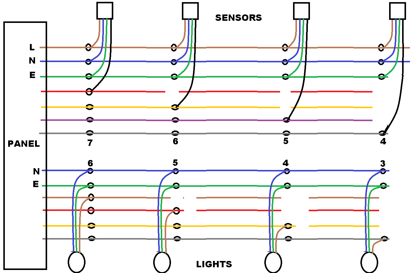

Installing 16 junction boxes sounds like a bit of a faff to me when all of those connexions will exist in the control panel.

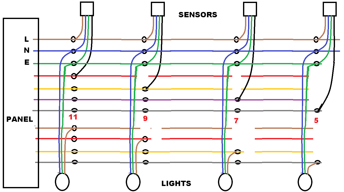

At each sensor you will require L, N, SL & E. At each light you will require SL, N & E. Having noticed the error in the number of wagos required i sort of switched off and didn't read all of the post. Therefore I'm not sure if you listed all, but for 4 sensors it's 7 cores and 4 lights it's 6 cores. If you are going for multicore there is no reason the sensor and light wiring can't be in the same cable, you'll see from this the neutral and earth are duplicated and can be combined if you have suitable cable, You'll also notice an amount of unused cores.
The switced live in the lights circuit should be in the same cable as Neutral to reduce interference (LED lights do tend to generate interference due to the PWM current control and keeping the L&N in very close proximity in the same cable helps to reduce the associated radiation). The same is technically tru for the sensor circuit but with the lower currents involved there is a lesser issue.
Personally I'd still be looking at running indivudual cables back to the panel. Realistically the amount of cable involved between the 2 methods won't be much difference but you'll be saving on cost of JBs.
Hi Sunray,
Thanks for detailed info - much appreciated.(y)(y)
I see what you have done by combining the LNE and NE into the multicore and this is something I will try to do for the reasons you have given.
Number of JB's not a problem to me as I have to have 1 for each of the lights anyway as they are supplied with pre-wired cable.
Also would rather do the sensor joins in a JB rather than the sensor itself, the boxes are only £1.24 each at CPC so not a great expense.
Not sure I got the number of wago's wrong per JB as I think it agrees with your diagram, 4 wagos for the sensor and 3 for the lights, all 4 way so as to leave at least 1 spare connection just in case but if I have got it wrong I will find out soon enough!:LOL:
So thanks again for all of your help.
Mark.

Unless I'm drawing something different to your plans I make the number of joints per box up to 7, I've added numbers to the sketch.
Or combined:
