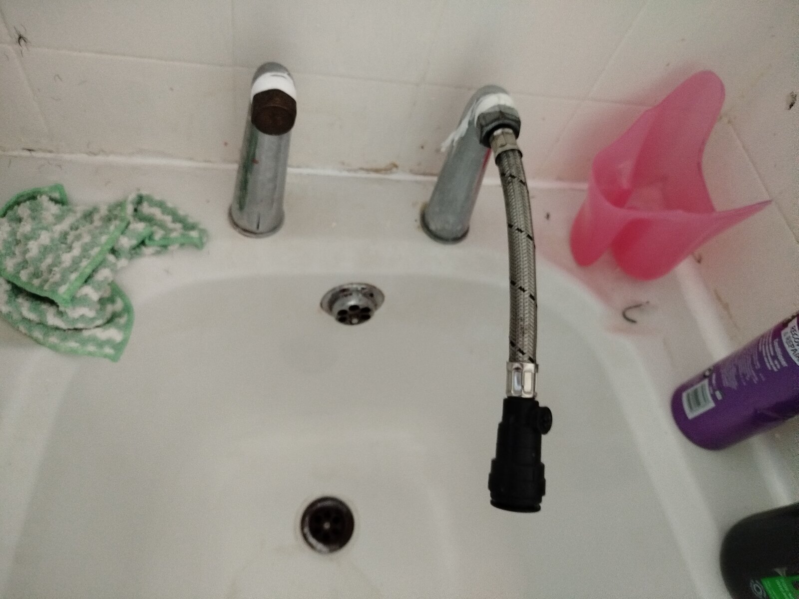

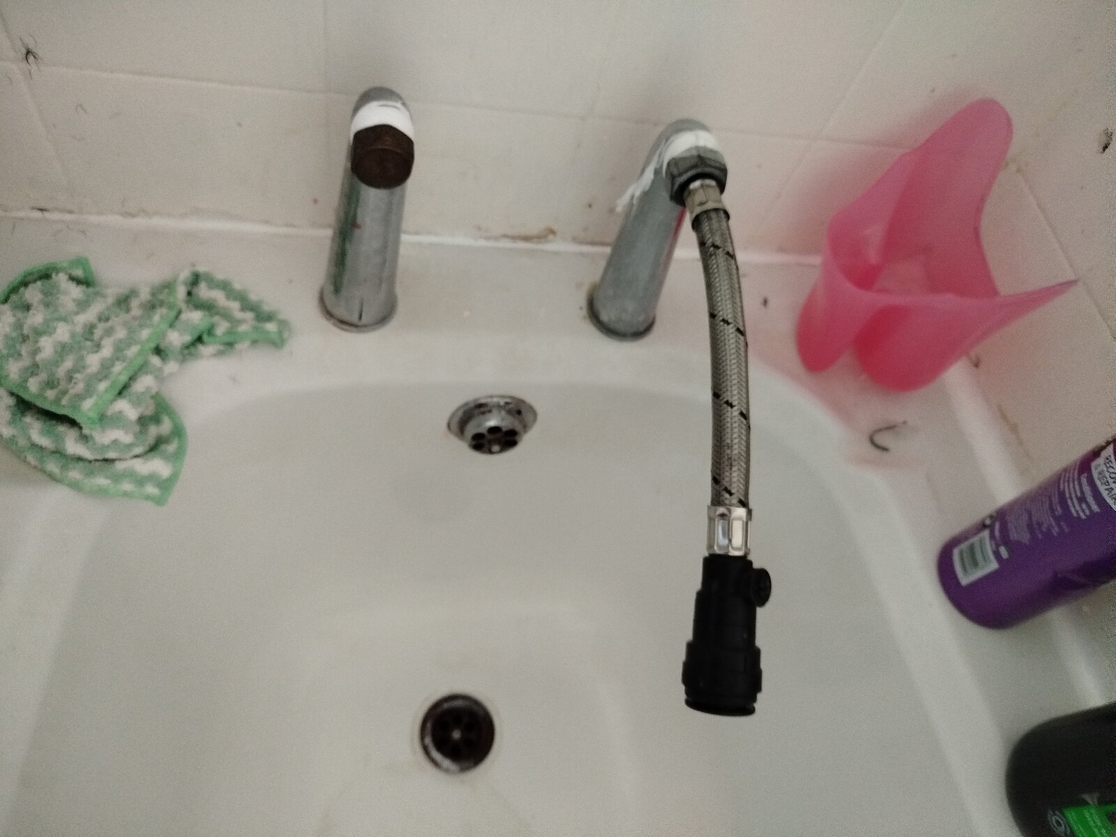

My hot water tap was leaking for a while, plumber came to fix it but the taps we ordered didn't fit, the plumber said that the previous guy has put them on the wrong way round , resulting in a 6.5inch gap between them rather than the usual 6inch
He says it looks like an awful mission to get under the bath to replace the actual taps, and he set us up this temporary solution, but now he does not know what to suggest as to how we go forward

I don't understand, those upstands don't look new. What was attached to them before? Please send photo of the new taps

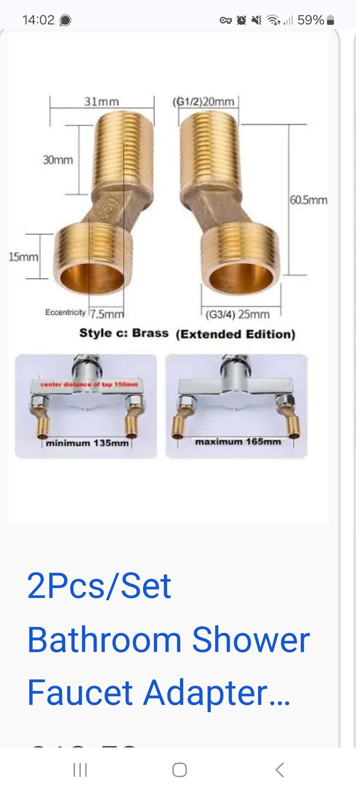

Get some female to female adaptors, fit the cranked threaded tap/shower valve connectors, then your new tap should fit on. Bit of a contraption but then at least you can use what you have and don't need to redrill the bath
No those upstands are not new, he removed the tap/shower that was attached to them but left the stands because he couldn't get under the bath

Pre drilled bath tap holes will come as 180mm centres for a standard deck or raised bath tap - those bent upstands usually bring the centres into 150mm and then a mixer/thermo bar tap can be fitted. Those upstands look almost straight and were bespoke for the tap that was previously fitted, so they will probably need to be changed but I don't see what his problem is, can he not get in under the bath? Is the bath panel tiled in? if so then it's hammer time and a new panel needed.
