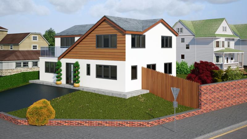

Andy kindly sent a message this week asking about the style of the house. I had been saving these in case the house doesn't look anywhere near as good but here goes. I was unsure quite how the design would look as it is reasonably unique. I had a good idea in my head but there were a few parts of the design I was not sure about and I didn't want to change my mind once it was built. As such I convinced myself it was worth spending a few ££ now to get some 3d renders done to see roughly how the finished article will look. I used a chap on line based on the other side of the world and it didn't cost much and was well worth doing.
I would encourage anyone in a similar position to do something like this. To give an example on how it can help I was unsure of the colour render to go for. Now the rendering will cost me circa £8500 for the whole house and for these images I can make amendments for £20 a go once the design has been done. To me its a no brainer, I will go with the lighter render and know it will look ok once done. Anyway enough typing, here are the pics.

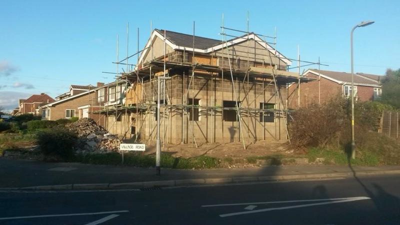

Ok so I have a few minutes free so wanted to update the blog. We have now had weeks 18, 19 and 20. In the last 3 weeks alone the new builders have made incredible progress doing probably 3 times the amount of work in 3 weeks than the last builders managed in nearly 4 months.
It all went so quick I haven't managed to put a day by day account of what happened but this is a basic overview of what has been done so far.

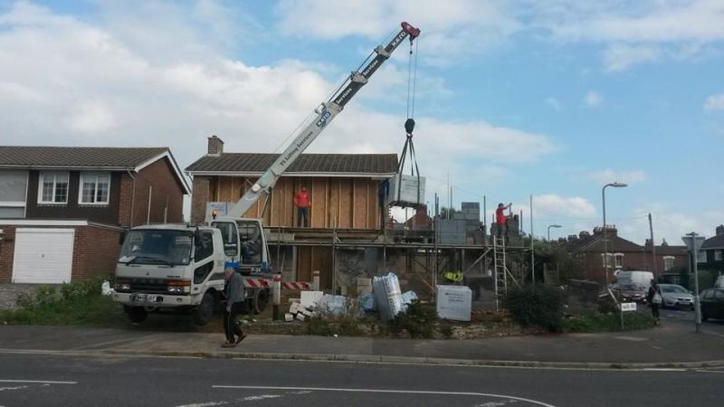

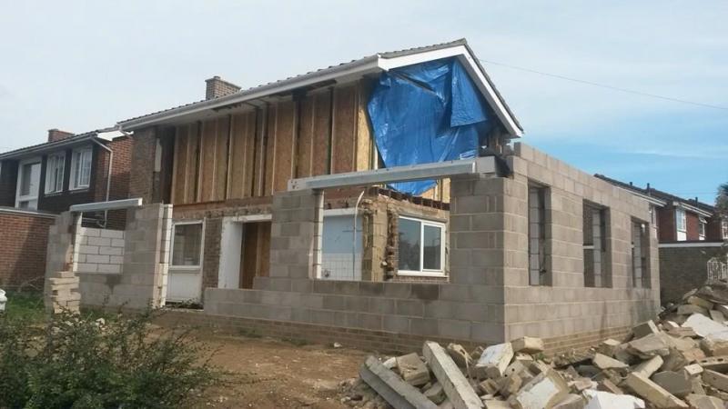

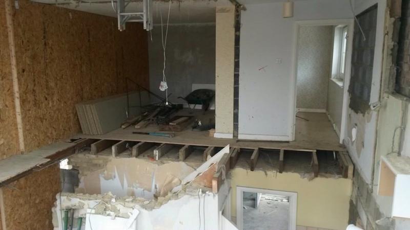

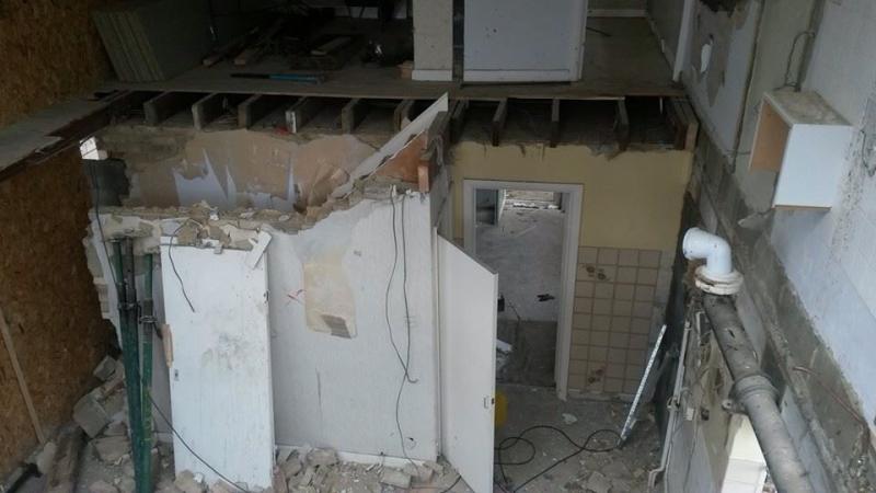

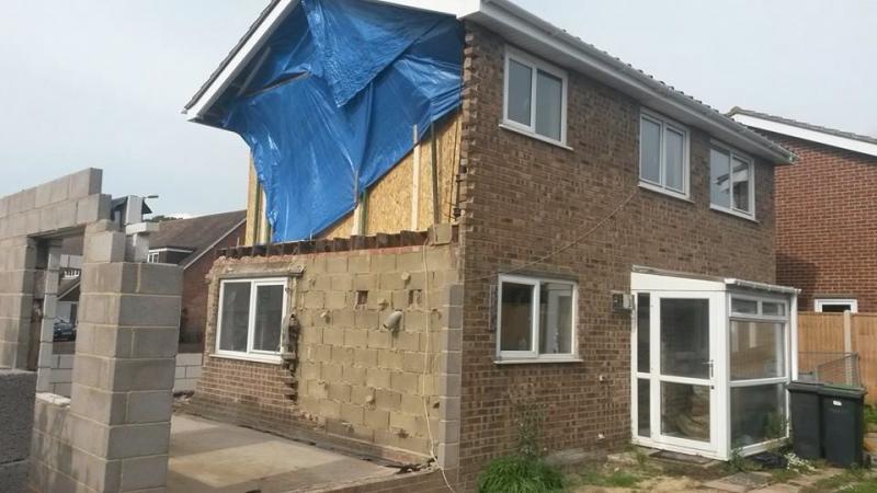

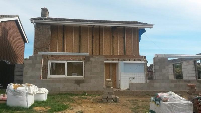

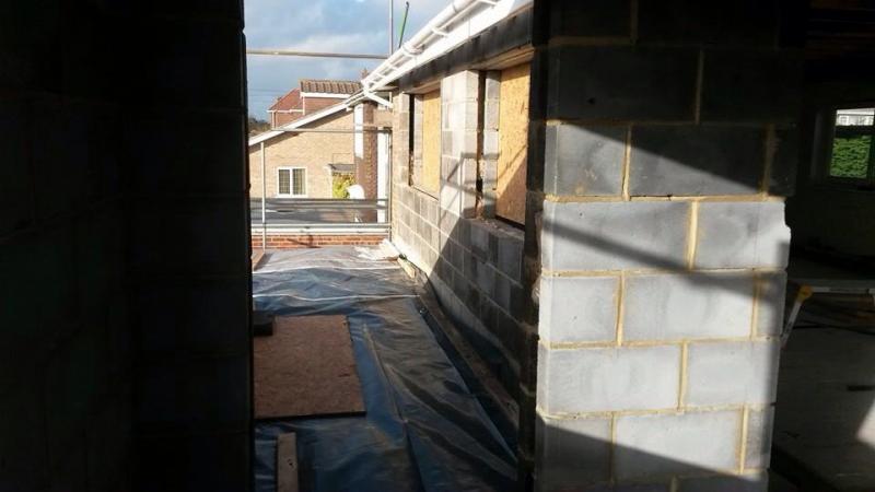

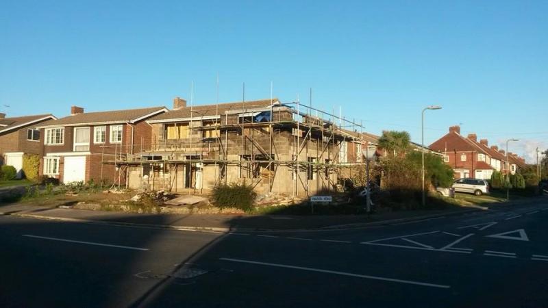

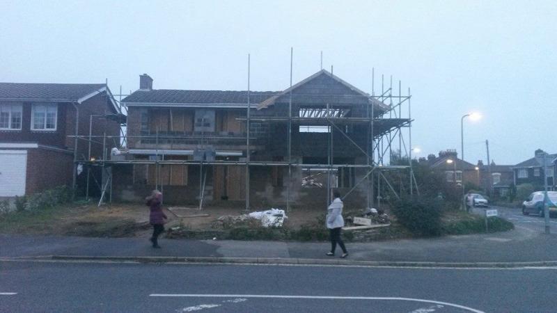

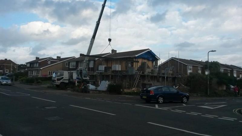

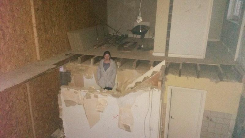

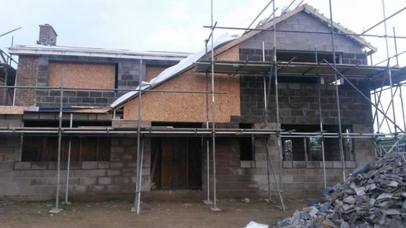

So to start off the builders decided it would be easier to remove the upstairs walls of the house as there were 2 big steels to go in. One which run the entire length of the building and one the entire width. There was also a new wall which needed to support these steel beams. This was by far the scariest part of the build and a lot of trust in the builder to be able to put it all back together.
The crane came and lifted the blocks onto the scaffolding and with the help of a lot of men the steels were slowly inched into place.

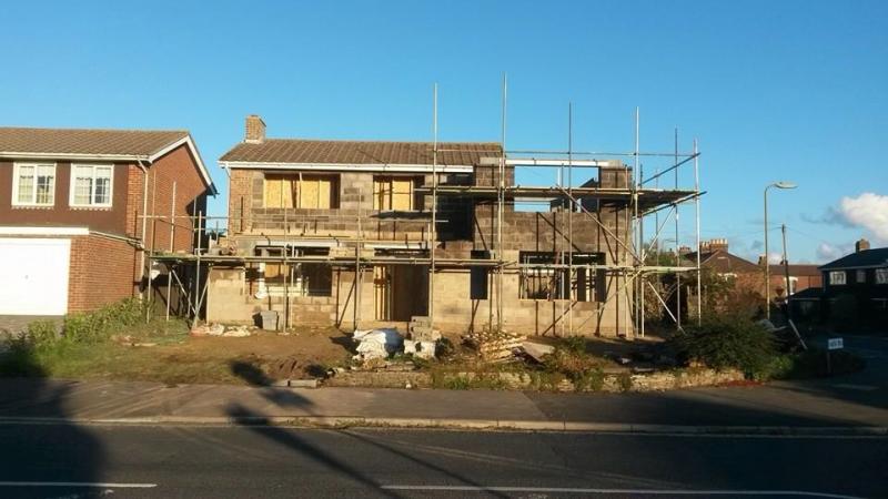

The block work continued and it didn't take long until it started to take shape

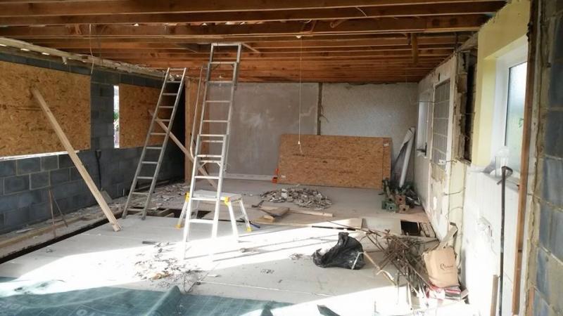

Inside the new floor joists and flooring went in to the new extension. After that half of the existing house had the floor joists removed as new ones were needed. This is because we were changing the layout of the stairs and the existing joists were then not long enough.
To continue here are a few more pics.
Firstly my lovely misses (now 20 weeks pregnant) trying to work out what's happened to her beloved house. She doesn't come to site quite as often as me so normally is a bit shocked by the progress.

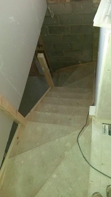

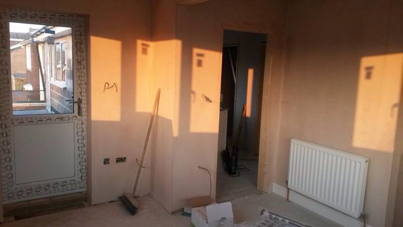

Upstairs internal. The chipboard flooring is down over 2/3rds of the house. There is a slight difference in floor height between old and new and the old one is not completely level. I am unsure how we will resolve this yet but there are a few options so will decide as we go.
The door to our balcony (without the door)

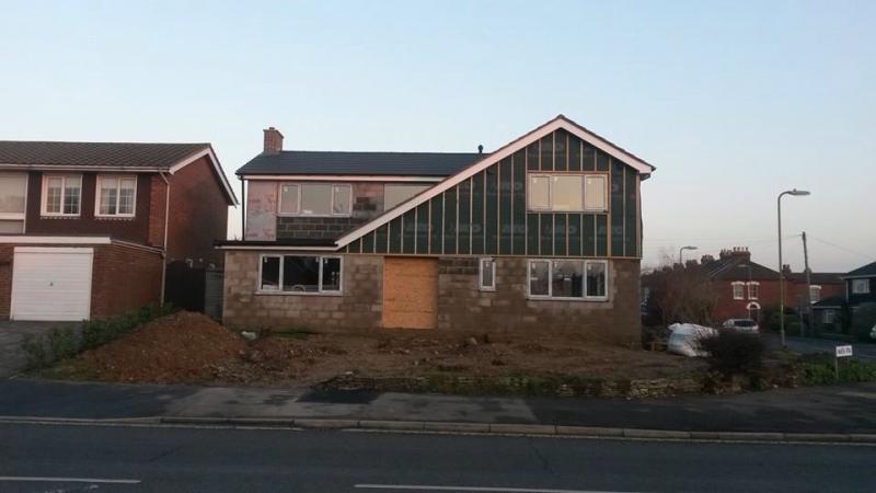

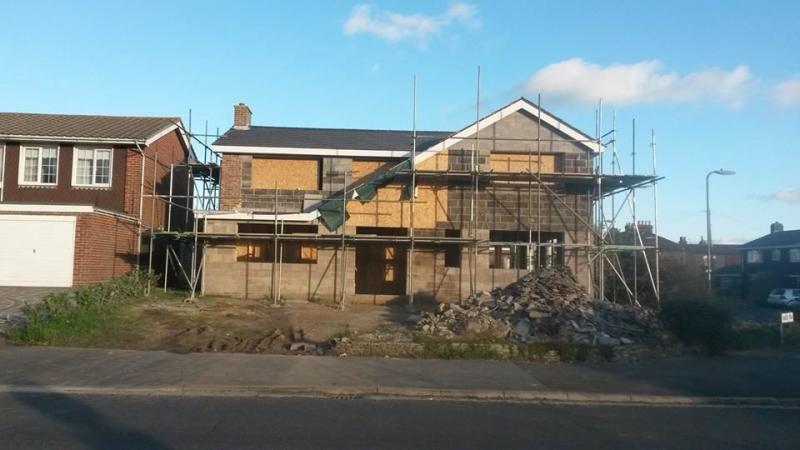

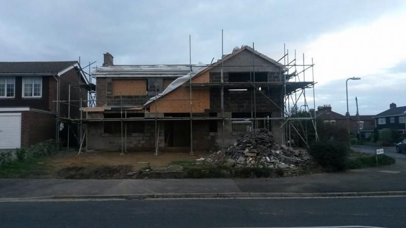

The roof which follows down to first floor height was made out of timber and OSB board which will be made ready for the cladding. This was one area I was concerned about as was not sure how the design would work but so far it's turned out reasonably well so panic over. As I think I may have mentioned earlier on the design of the house was not my first choice but unfortunately we had to get something through planning and this was a design I came up with which the council officer actually liked.

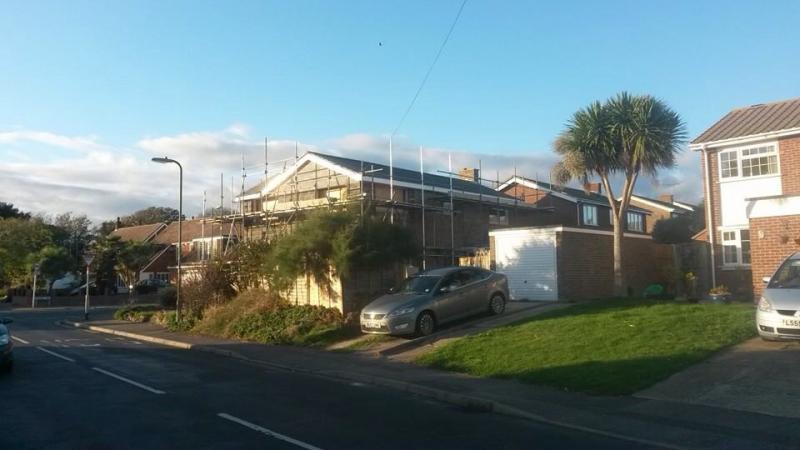

In the last few days the house has had new facia and soffit installed. The builders have also completely stripped the old roof. I decided whilst the scaffolding was up it made sense to replace the roof felt as the old lot was falling apart at the ends where it was exposed to the sunlight. I got a bit carried away but thought if they were having to take the tiles off to replace the felt I might as well go the whole hog. The roof was re felted, new batons and then re tiled with some marley edgemere tiles. These are very similar to marley moderns but quite a bit thiner and not too much more expensive.
And that is about where we are up to excluding the internal studwork which I have forgot to take photos of.

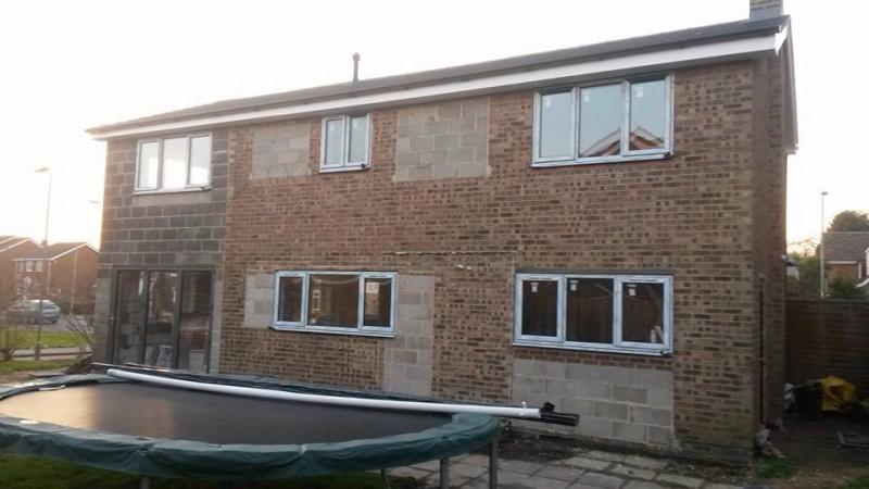

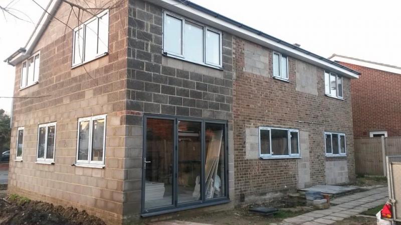

The rubber roof for the balcony is on and the front has been battened ready for the cladding. Over a number of weekends we managed to get all the windows in. Now the only thing missing is the front door. We went with a hormann tsp700 after seeing one on someone else's project on this site. Unfortunately they are all made to order from Germany which means there is a few months wait whilst they are made and shipped over. It should be here in a few weeks time.

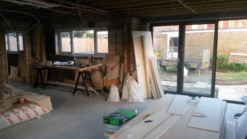

For the back of the house we were going to go with upvc bifolds however found a local company who do aluminium ones for a reasonable price. We viewed the factory and we're happy so we paid a bit more and went with these. The quality is great and it's definitely a decision I'm really happy with. We would have liked them bigger but unfortunately given the way the house is structurally supported this wasn't possible.

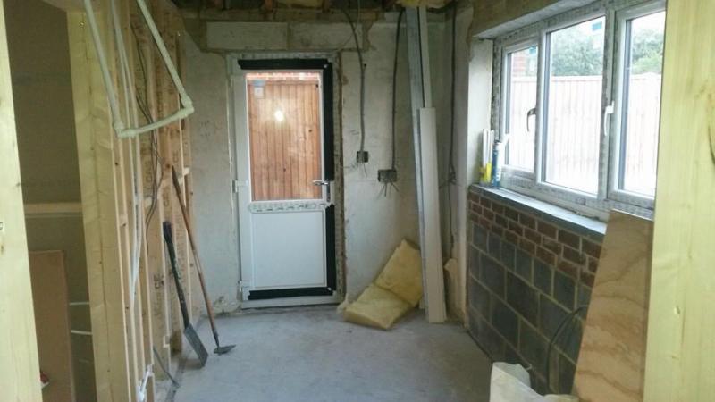

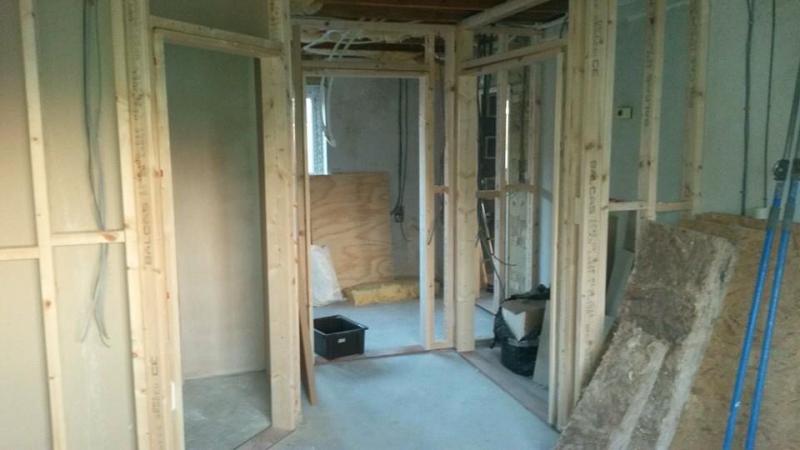

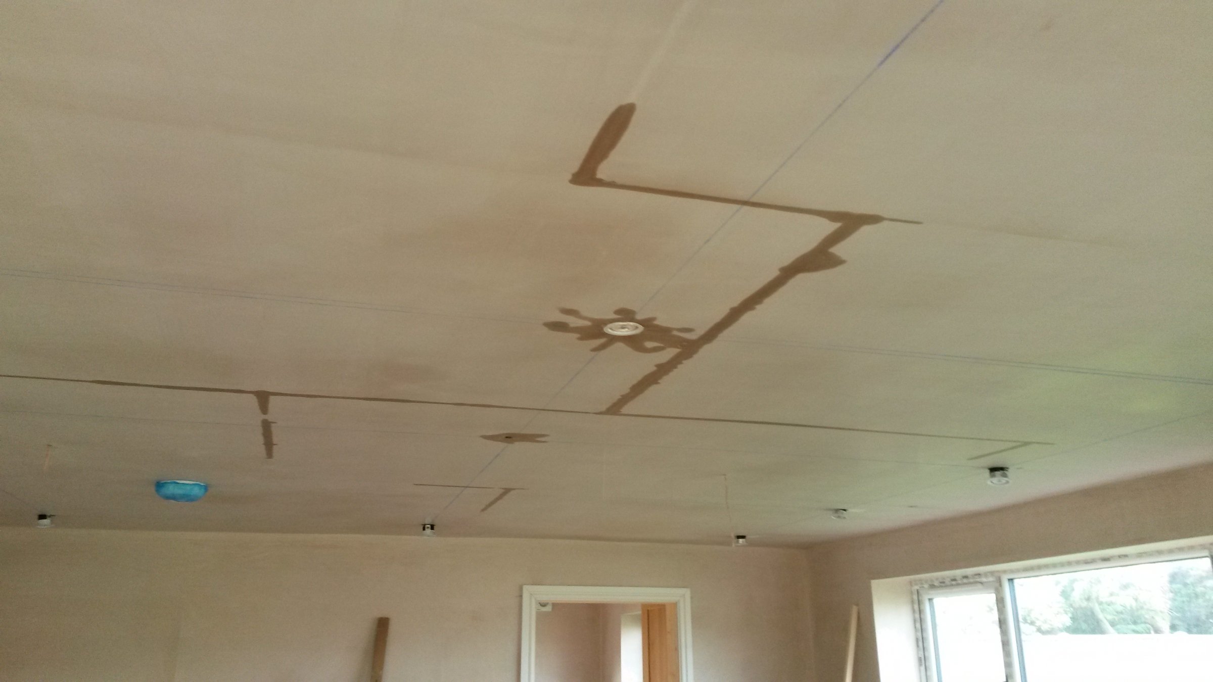

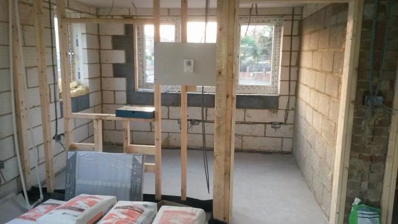

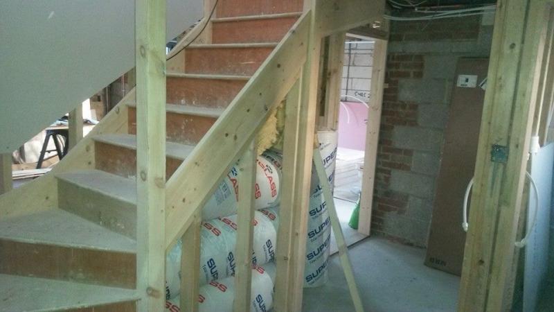

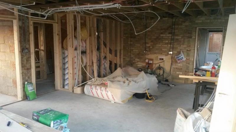

Internally we got all the first fix electrics done. We ended up getting a company in which is owned by an old school friend of mine. It didn't take too long however there are wires everywhere. Certainly something which would have taken me weeks.

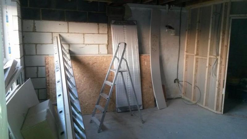

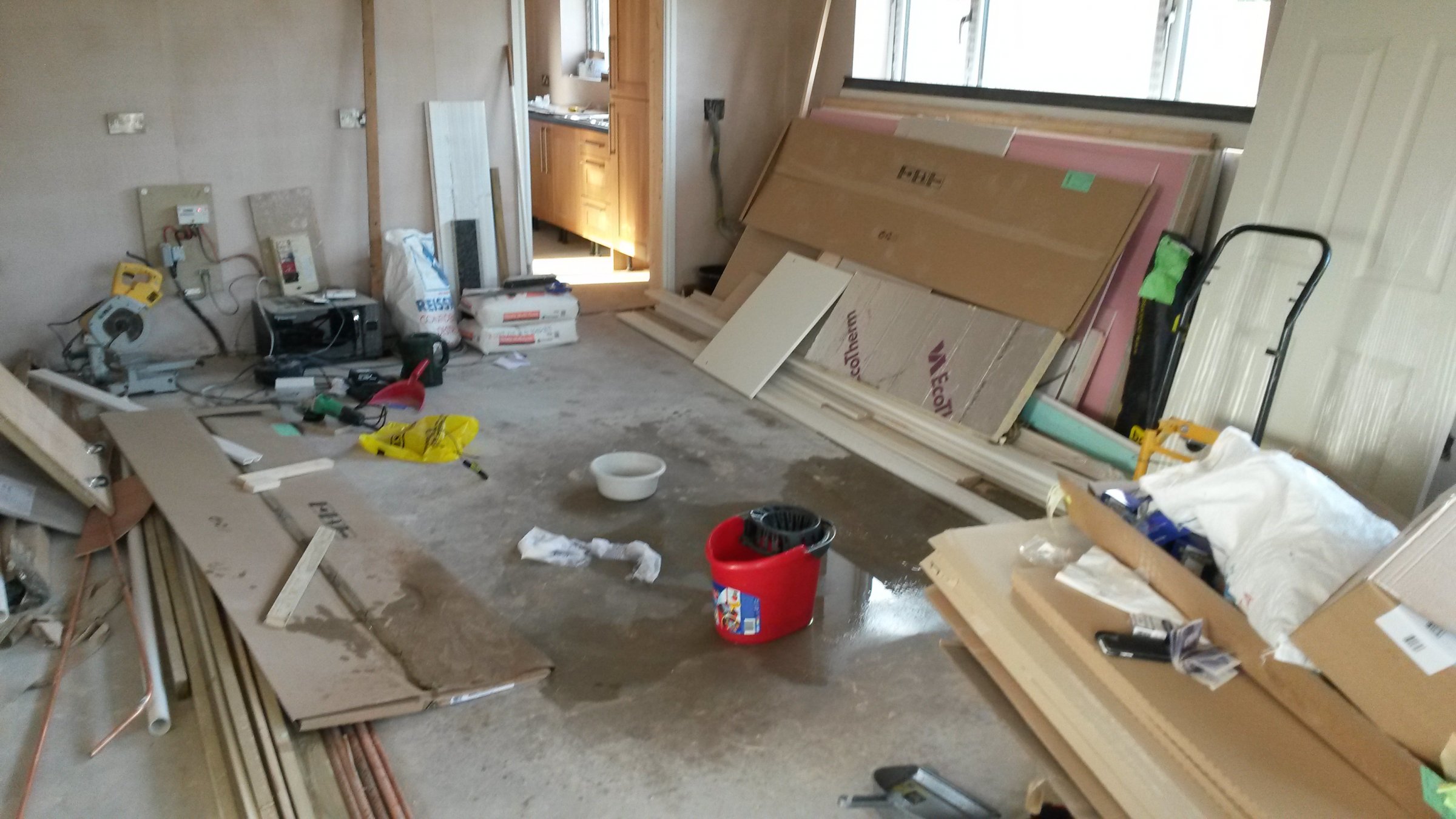

We have a plasterer who is a friend of my partners. He pops in and works Saturday's so progress is slowed down a bit. To be honest this is great as everything has been going at a hundred miles an hour up until now.
Downstairs
Upstairs

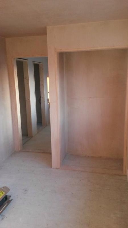

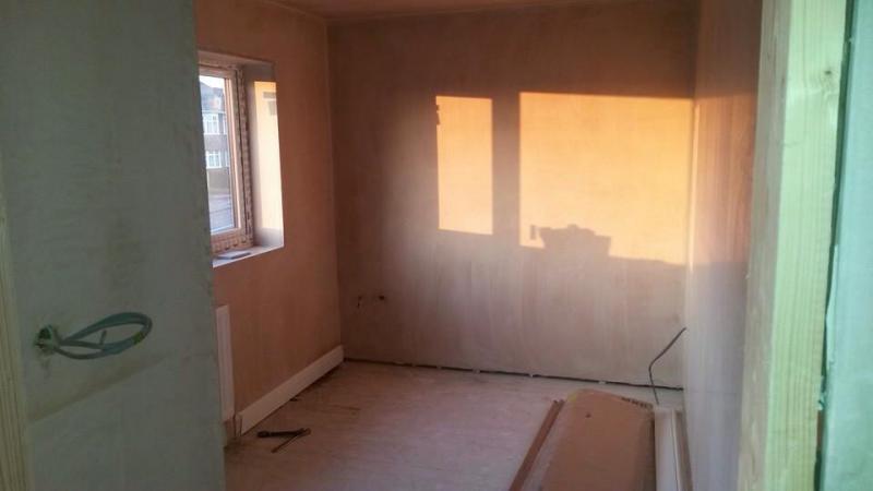

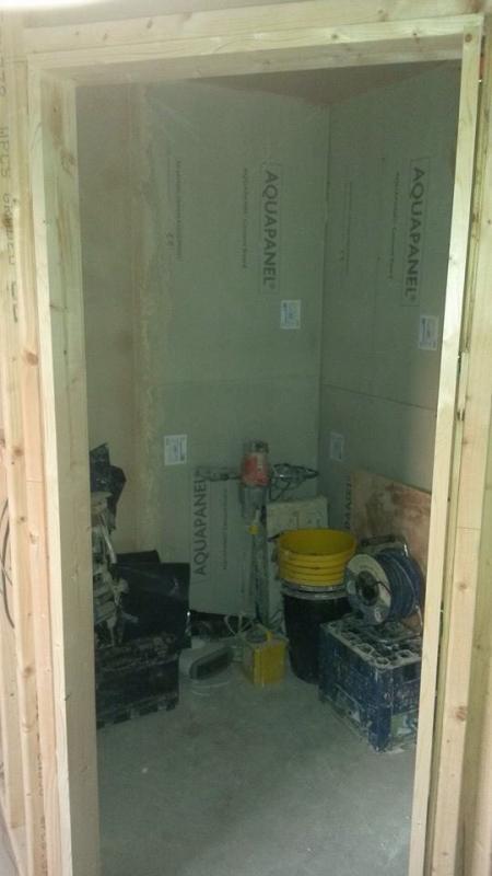

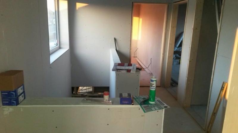

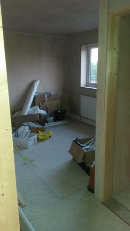

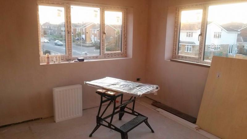

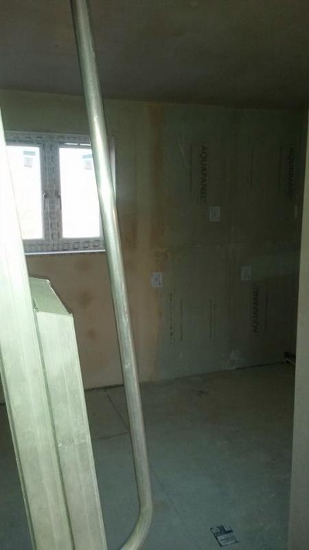

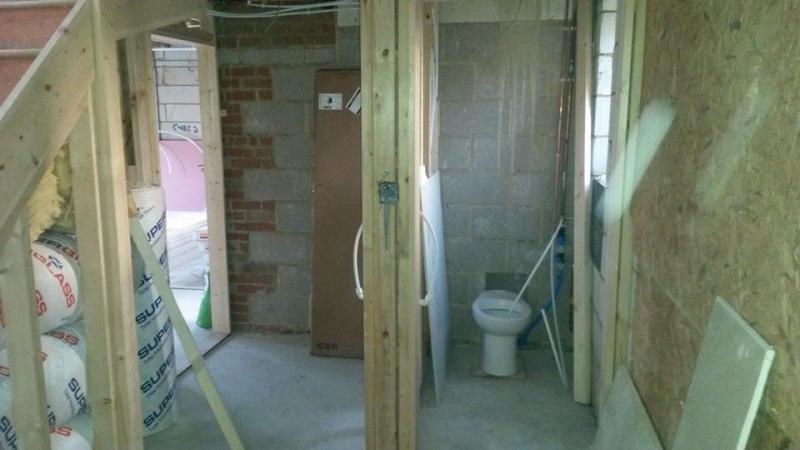

We have most of upstairs plastered now. It really starts taking shape when the boards go up. We made a slight change to the plans and added an en suite in one of the bedrooms. Now it's there we are really happy with the decision and hopefully it will mean I can have somewhere to go when the girls take up the bathroom in the mornings.

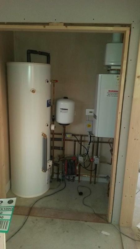

Heating. We have installed a new heating system - so far just the upstairs radiators. We used plastic pipe with push fittings. Just some advice here. We used stuff called floplast from screwfix. Please don't ever use this, it is complete crud. The pipe doesn't flex and the connectors are near impossible to de mount and occasionally are just as hard to push together. We changed when we were 80% of the way through, we used Hep2o in the end and it's definitely a far superior product. If you are about to embark on a project just pay the extra and use this from the start. It will save you in time what it costs extra for the pipe.
We fortunately got a voucher under the green deal home improvement fund when it first came out. This gave us £1600 back towards a boiler install. We used a company called the warmer group. Really nice guys to deal with and highly recommended for anyone living in the hampshire or surrounding areas. Great thing is the boiler after the cash back cost less than we could have purchased the parts for. Got to love a bargain.

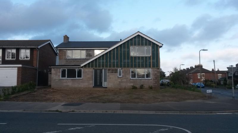

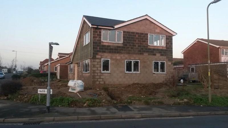

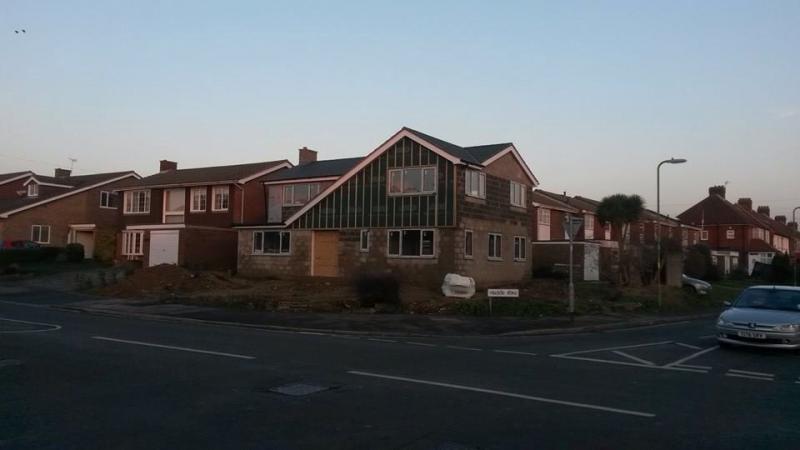

So this update is just on the outside, I will do another on the inside over the next few days.
The outside of the house was full with trenches, piles of soil and rubble. We got a man with digger in for a day and not only did he dig out for the drive but also did some reasonable grading of the ground.
You will also see that since last time we now have a front door. It's a horman tps700. Really happy with the quality and look of it. Only downside was the 3 month or so wait for it but as they say, good things come to those who wait - did I really just reference a beer commercial?

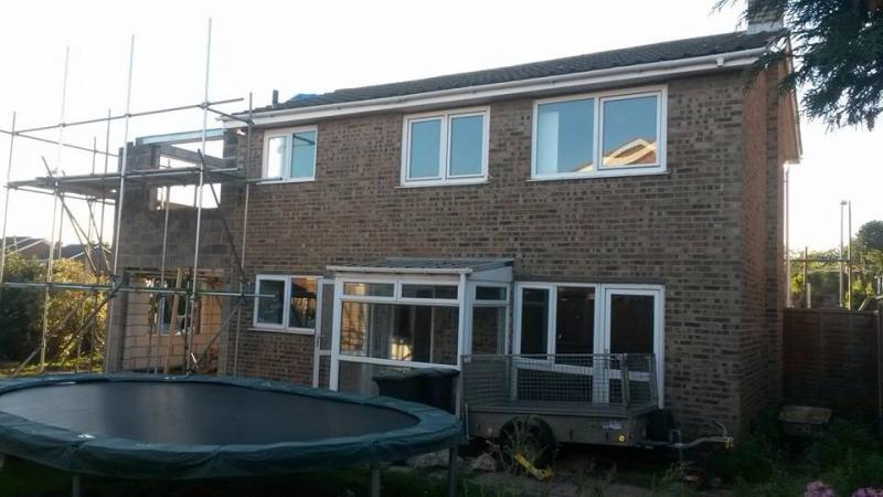

Out the back of the house we removed the small upvc porch and also all of the paving slabs. The ground was very uneven so the digger also helped level this up. Once roughly levelled we ordered 5 ton of topsoil and spent about 3 days with me and my dad using a rake and roller to try and get it close to smooth. Really we needed a lot more soil but given the cost of it decided to try and make do with what we had.

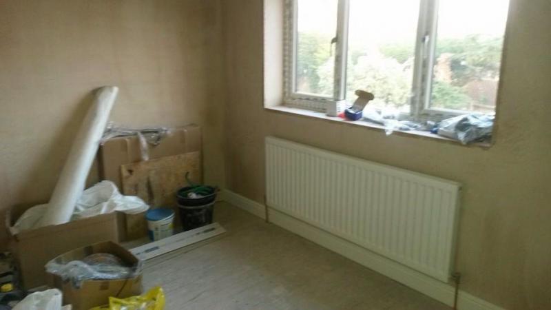

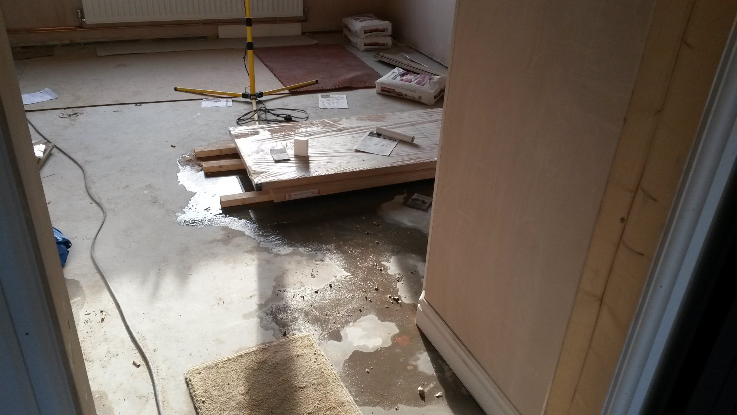

Just a heads up before I start. I'm sure this is common knowledge but if not and you are considering using chrome plated copper for your radiators my advice is this.. Only do it if you are using compression fittings. I used mostly push fit for my heating system and wasn't aware these don't grip chrome plated tube properly. A very frustrating mistake to make. I have since had to cut holes in walls by a number of radiators to change the push fit fittings to compression ones. Unfortunately these are the consequences of not doing so.

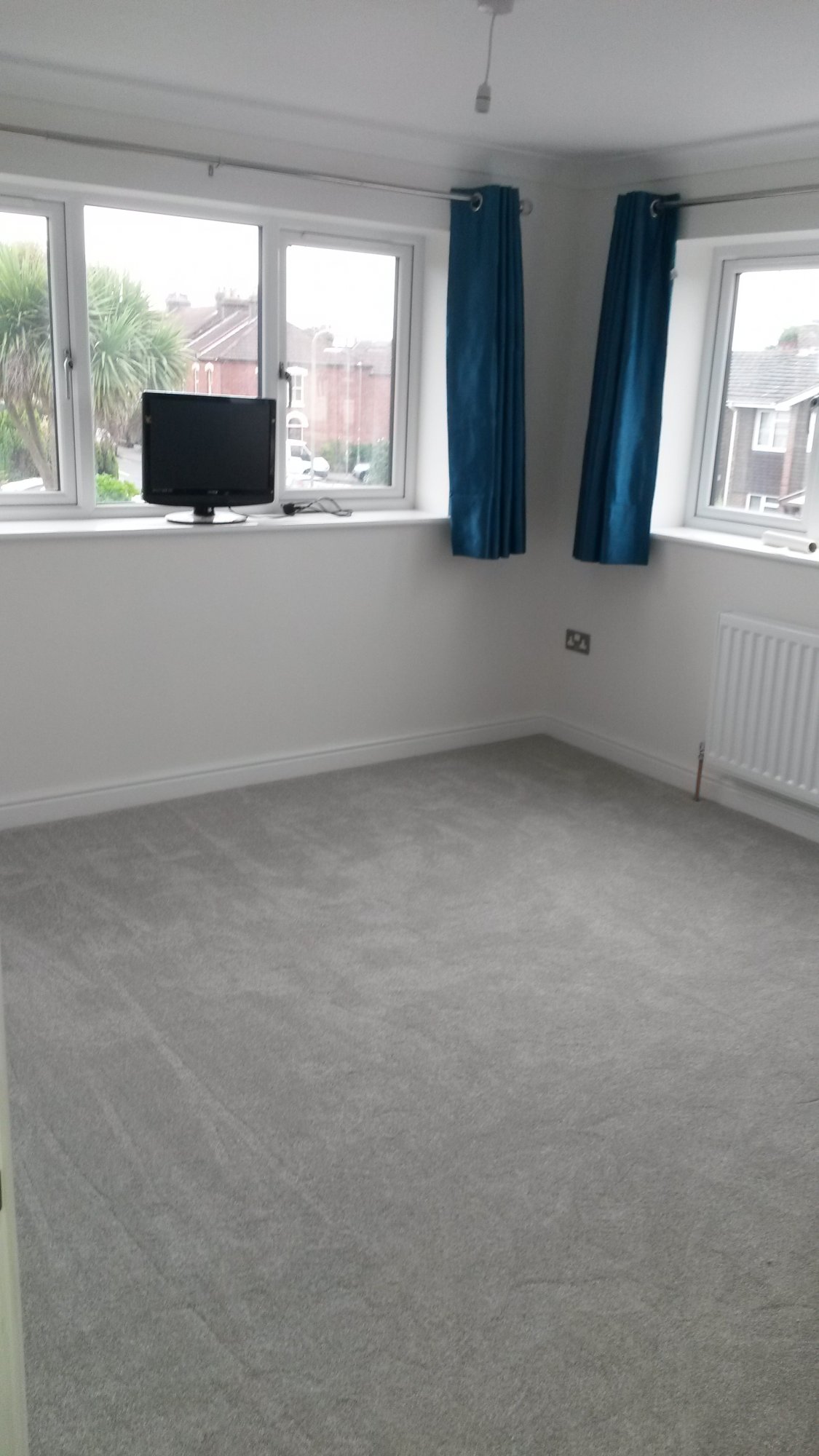

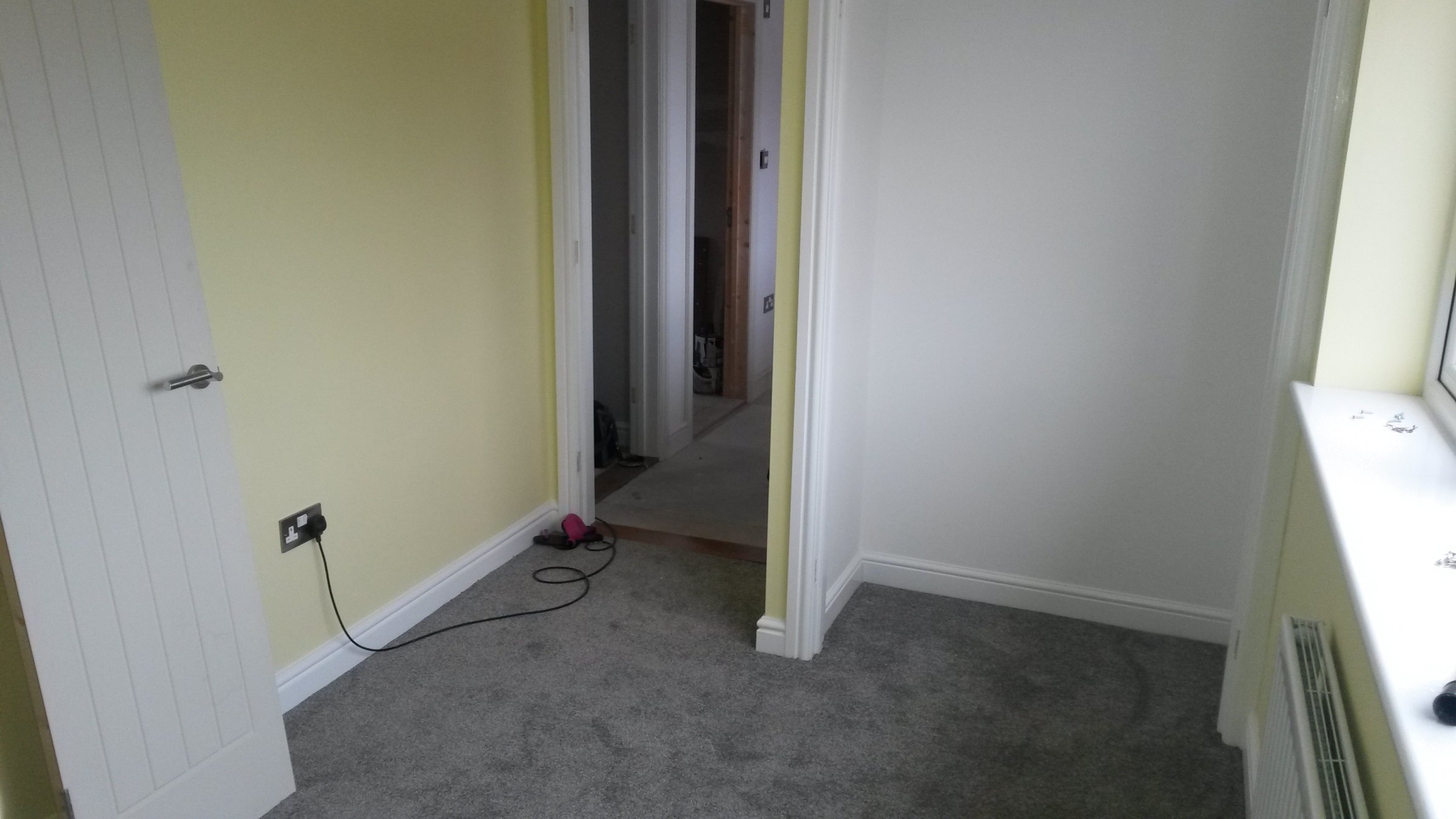

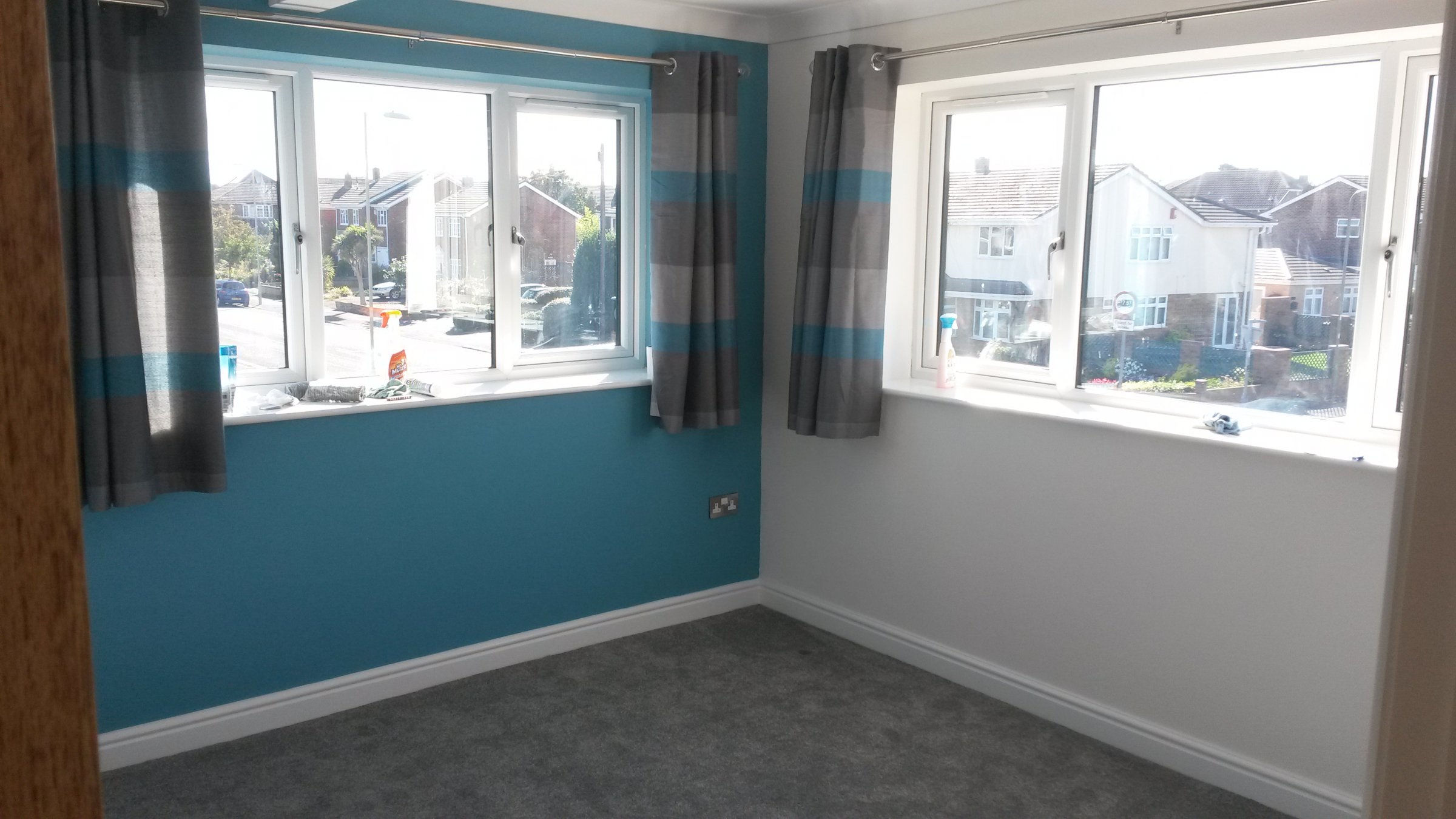

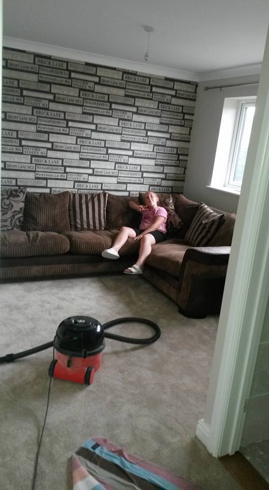

So onto the positive. There are a few rooms upstairs which are finished.

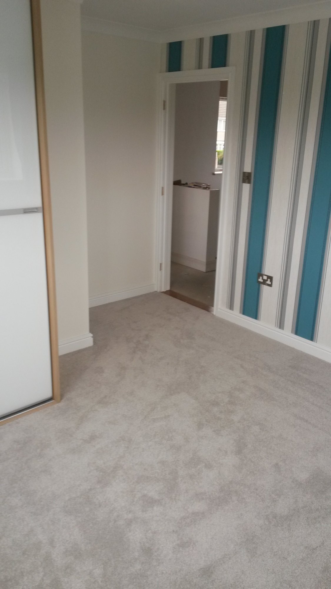

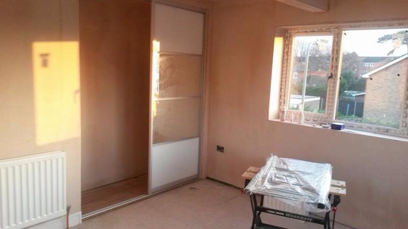

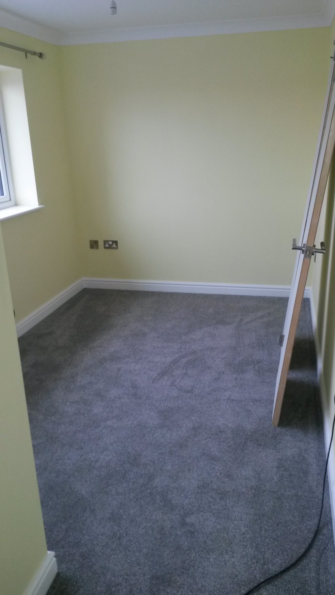

My step daughters room was first
We then went onto my little boys room. I'm sure he will love this as he has massively outgrown his Moses basket and I'm sure will love a room of his own. This is actually now furnished but I can't seem to find any pics of it.

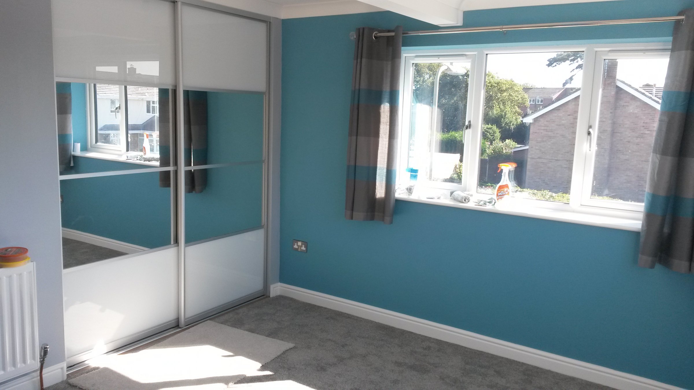

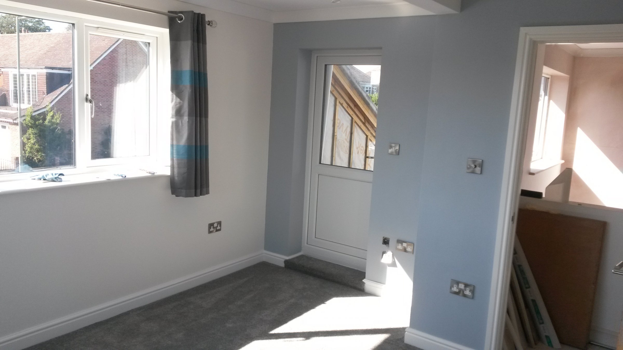

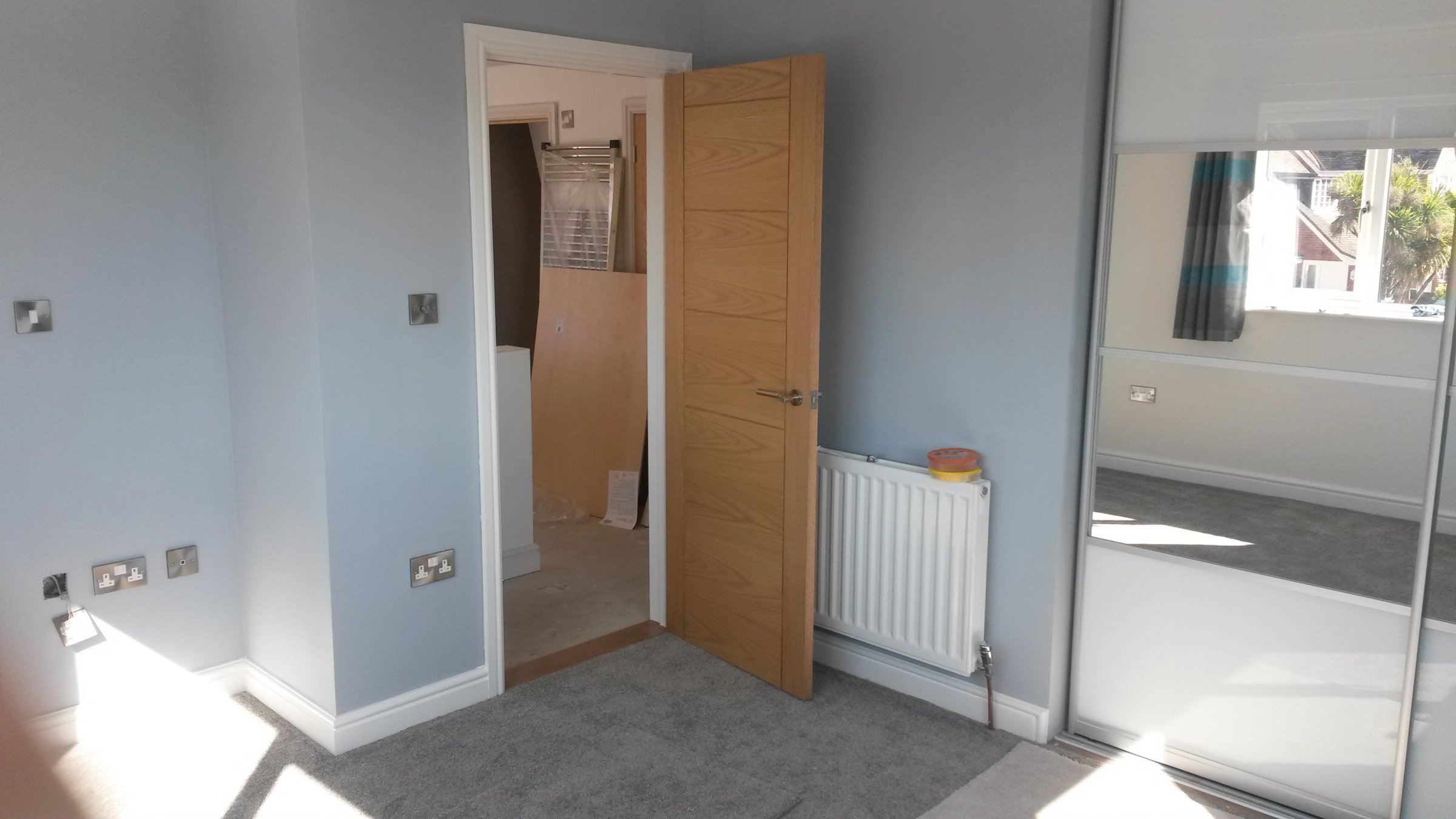

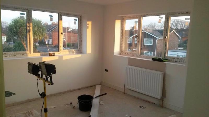

The we have mine and the girlfriends room. It's not huge but has dual aspect Windows plus has direct access to the balcony.
Rather than having a spare room we decided to have a snug upstairs but got a sofa with pull out bed. Hopefully it will be the best of both worlds as can be used all the time but we still have space for friends to stay when they have had a few too many. This is smaller than originally intended as we put in an en suite which wasn't in the original plans.

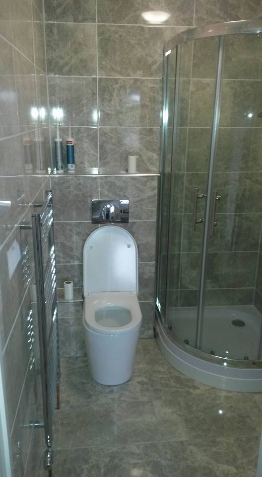

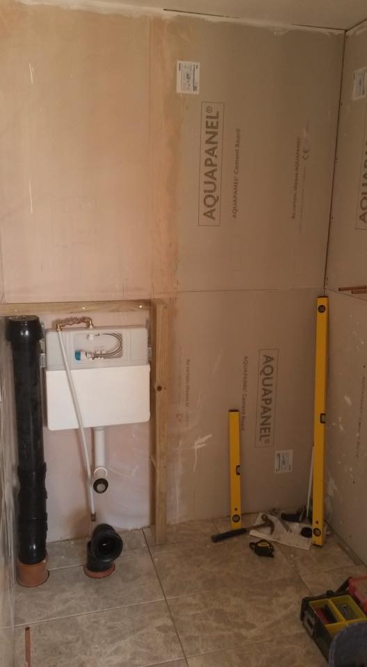

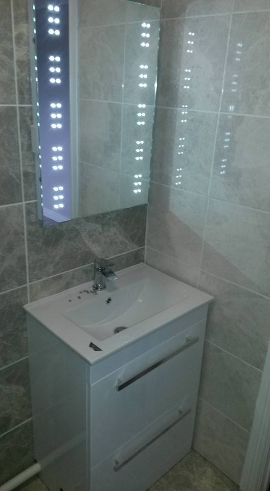

Lastly is the en suite. Originally I thought the room looked tiny but it's amazing how much you can fit into such a small space. It works really well and doesn't feel too cramped. It also didn't cost to much in the end so I'm really glad we put it in.
