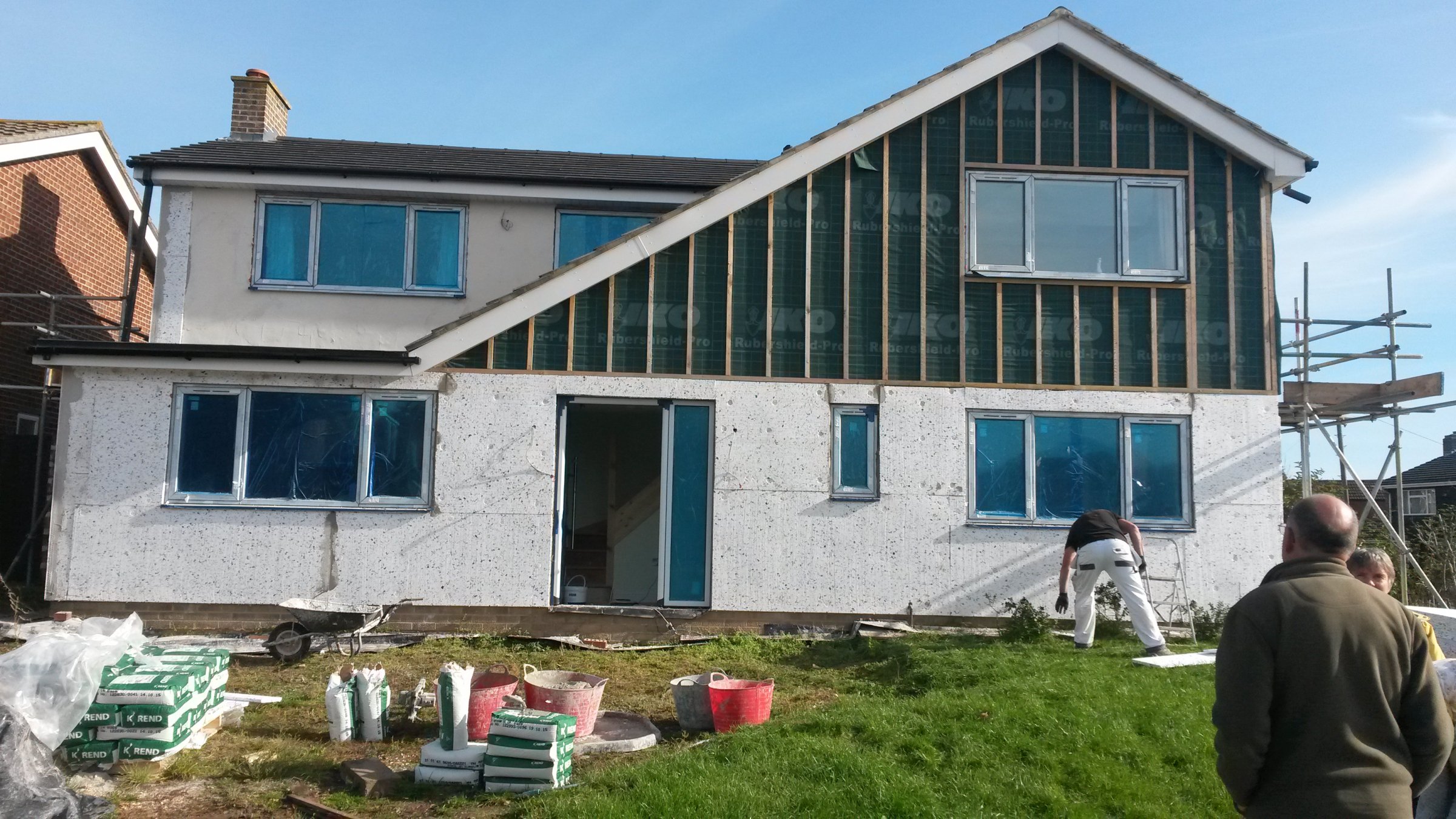

The chap we chose gave us the option of externally insulating the house. It came with a few plus sides. Firstly we didn't need expansion joints between the old and new parts of the house and meant cracking was less likely. Secondly With the thin coat it is also easier to repair than the normal k rend so if we do have any cracks it is possible to fix it without redoing the whole side of the house. Thirdly some of the blocks which were used to build the house had what appeared to be rust spots. Apparently these will eventually show through the render but obviously by having the insulation it will prevent this. Lastly it will make the house more energy efficient. It was only around an extra £2k so we decided to go with it and are really happy we did.
The only issue we did have with the render is it seems to be a bit hit and miss as to how long it takes to dry. Unfortunately our house being not far from the sea does have a side which takes a bit of battering. This lead to the side being ruined before it had time to set. Fortunately the guy we used was very good about it and re did the whole side again for us.

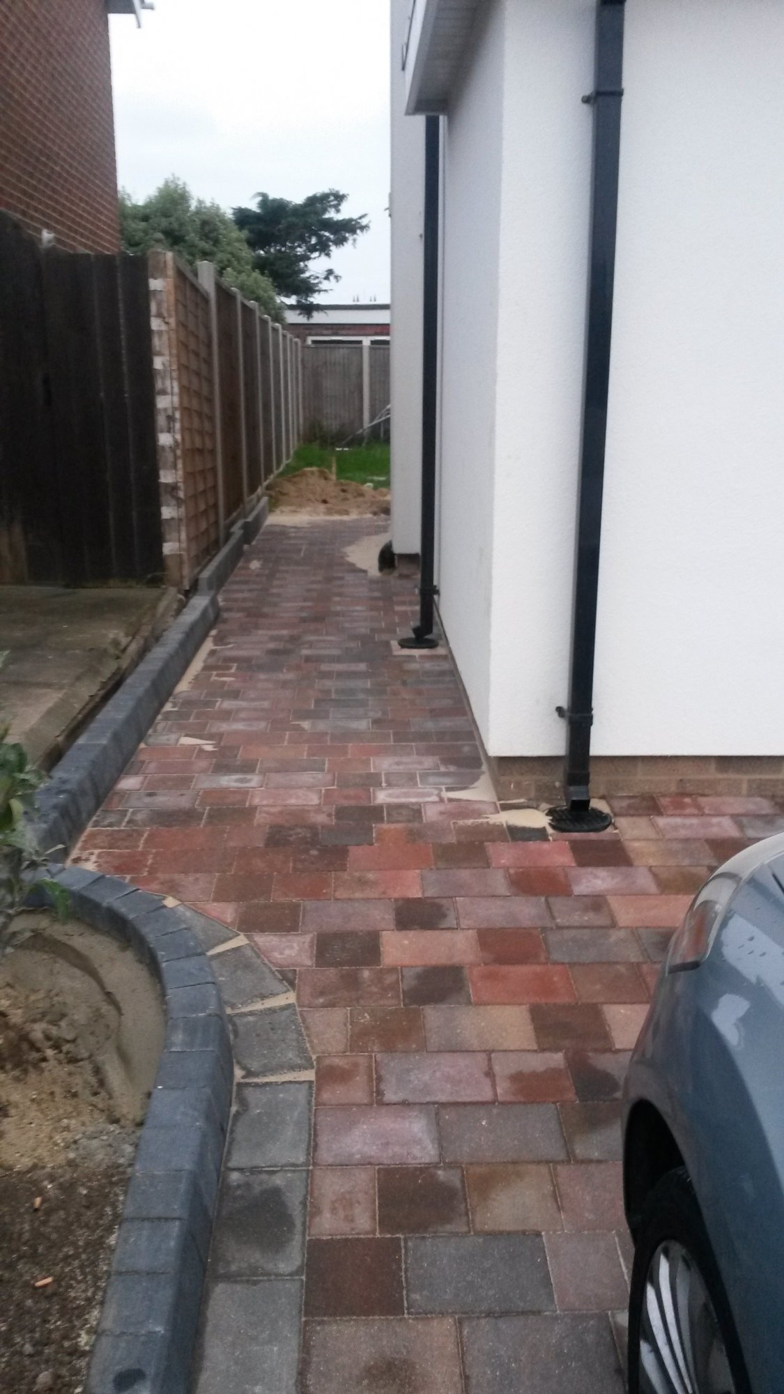

Onto the update and I will start with outside. We have had the lights installed and the driveway done. Here are a few pics of the driveway.
Overall im really happy with how it has turned out. I went away from the original plan of grey pavers as wanted to add a bit of colour to the curently black white and grey house. The guys did a fantastic job. I ended up buying the materials myself and just paying the guys for the labour. It cost around £1700 for the labour and the total all inc was about £4500 and there was about 70sqm in the end. We did have a bit of an issue with a gas leak but this was resolved and so far no bill through the post :-)

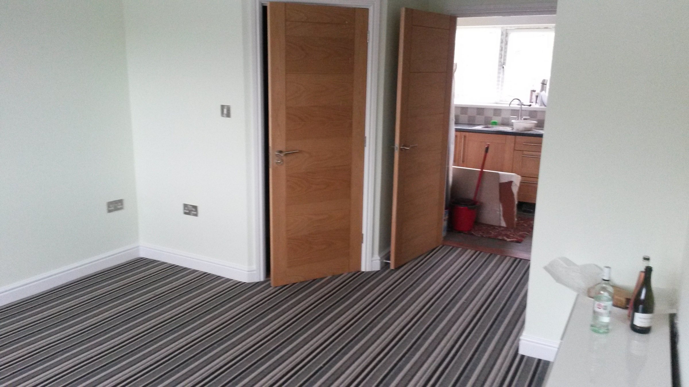

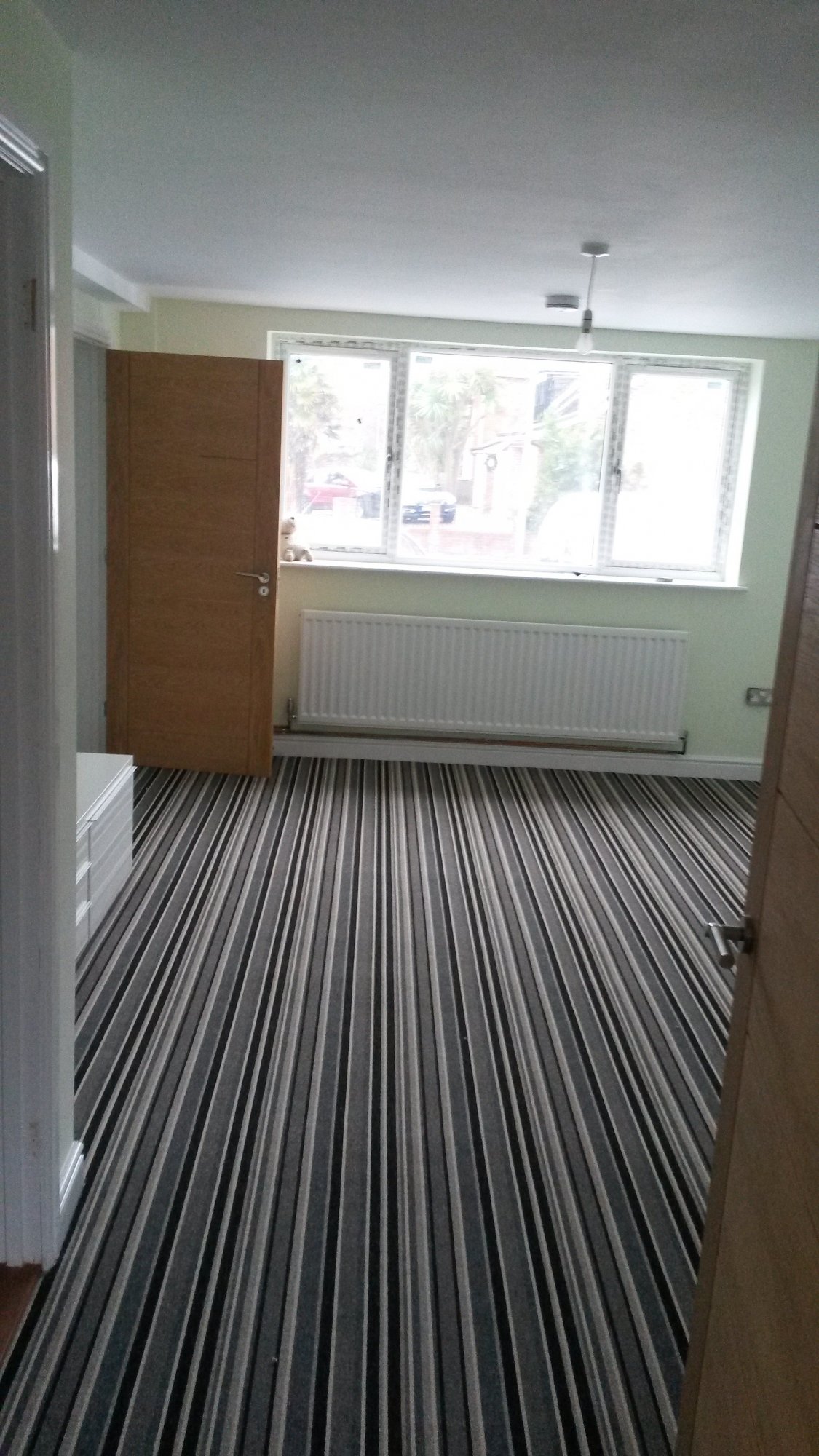

The studio is nearly finished, I just need to get the wall bed up and operational and furnish it. Went with stripey carpet which has made it look bigger.

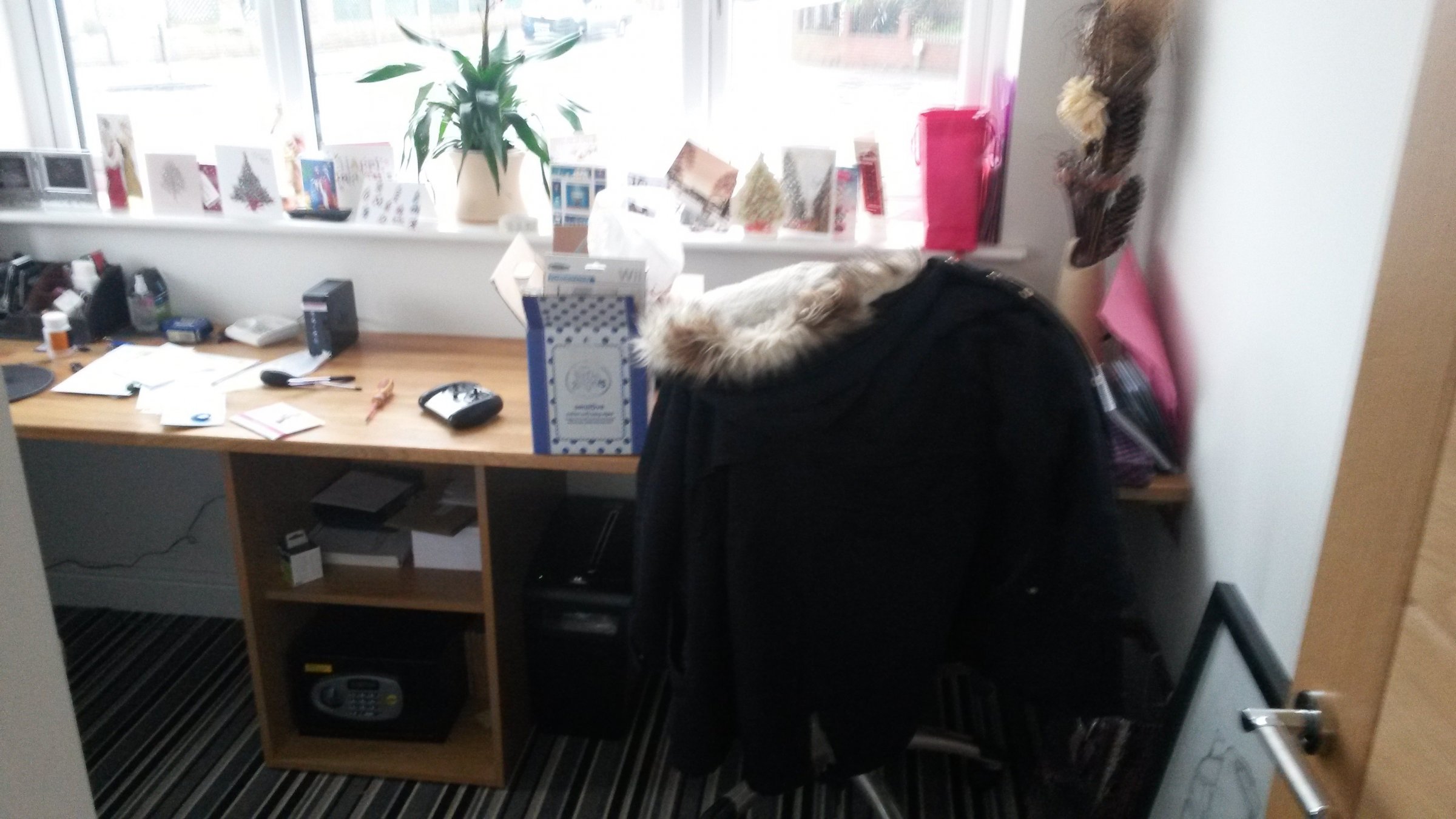

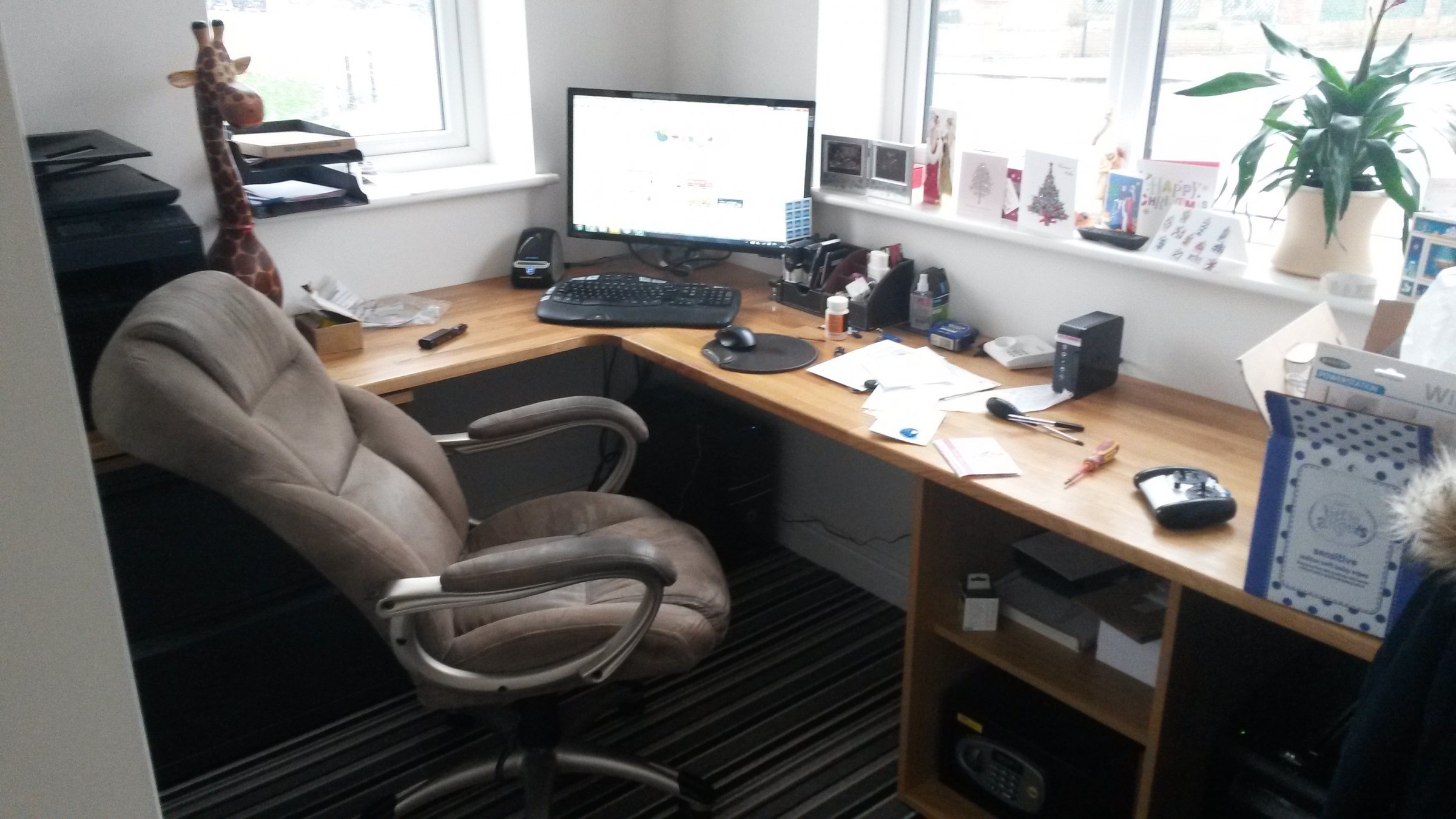

The office which I originally thought might be too small has worked out to be perfect. We custom made the desks out of butchers block oak worktops and again used danish oil to finish them off. I used a kitchen base unit with bits of wood underneath as feet to lift it slightly from the floor. Will put a kitchen door on it when I get around to it. Just enough room for 2 of us and is a lot better than working from out lounge which is what we previously did in the old flat. excuse the mess.
