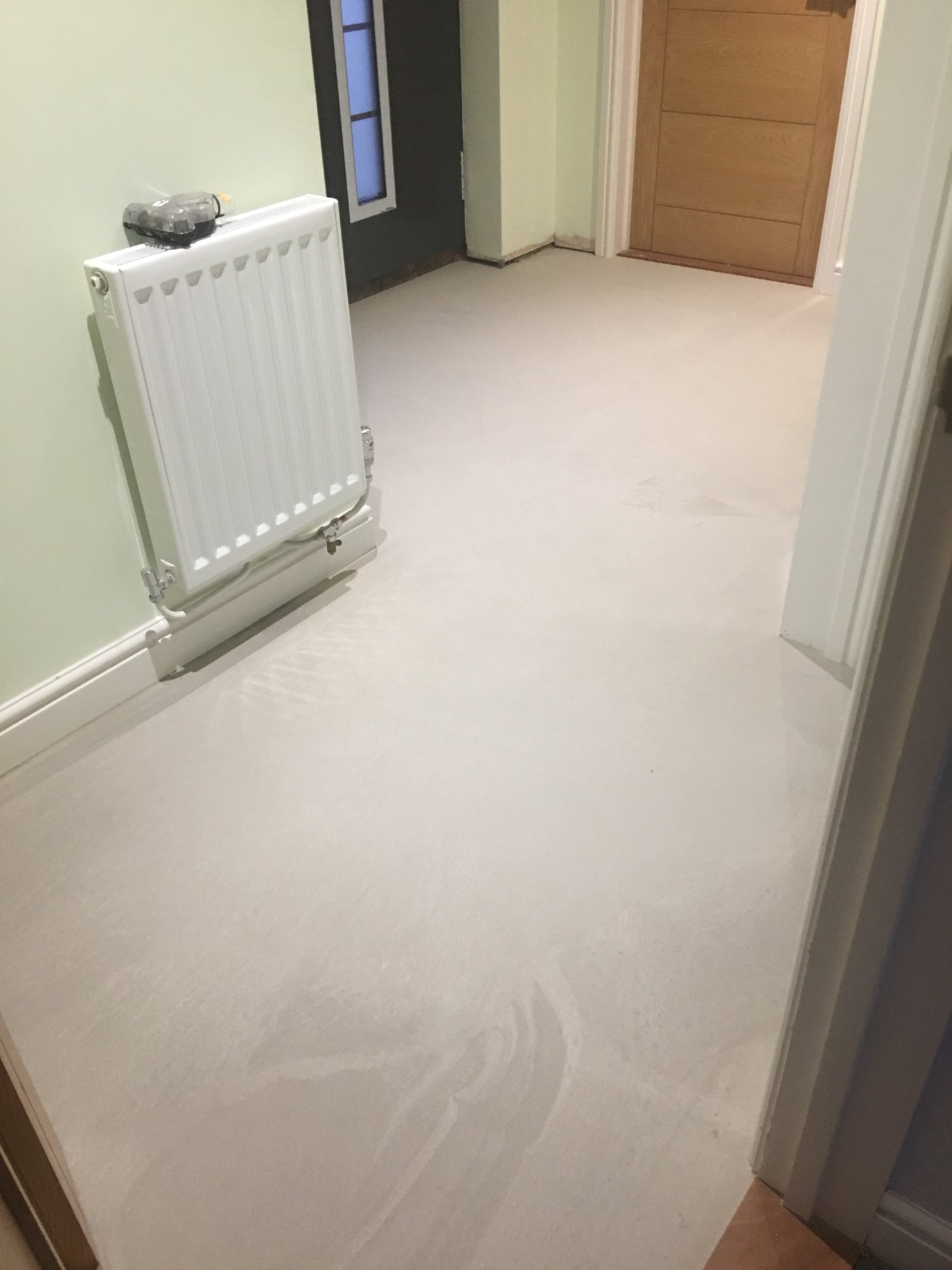

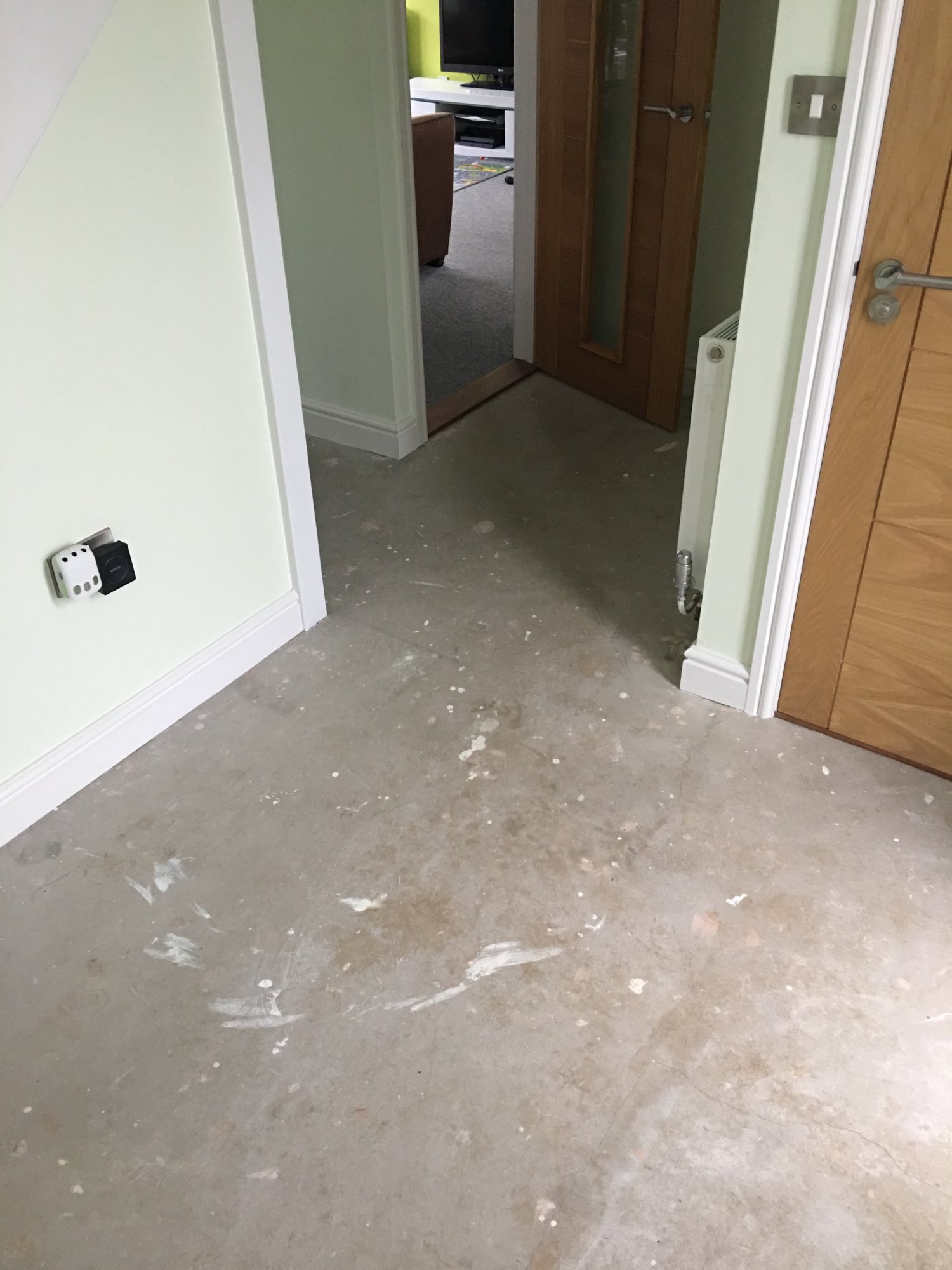

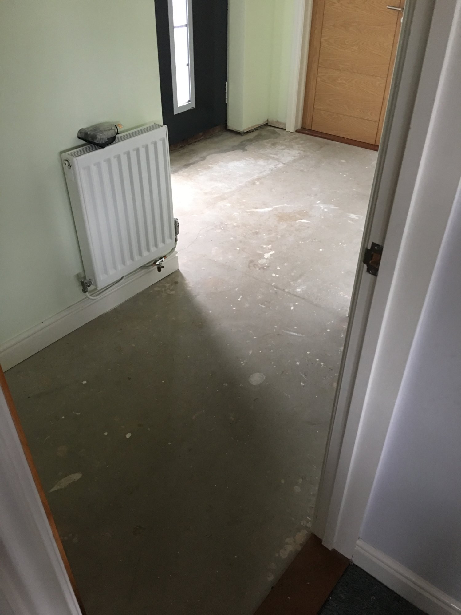

So onto the latest update. the first part is the downstairs hallway. Up until now the floor has been a nice concrete slab. I wanted a wooden effect flooring and as the hallway isn't huge I wanted a smaller thin plank. Like the rest of the house we ended up going for a grey colour and chose Karndean. I went with a single plank border with a contrasting trim and then had the planks set at a 45 degree angle. Here are the before and afters.
After re screeding

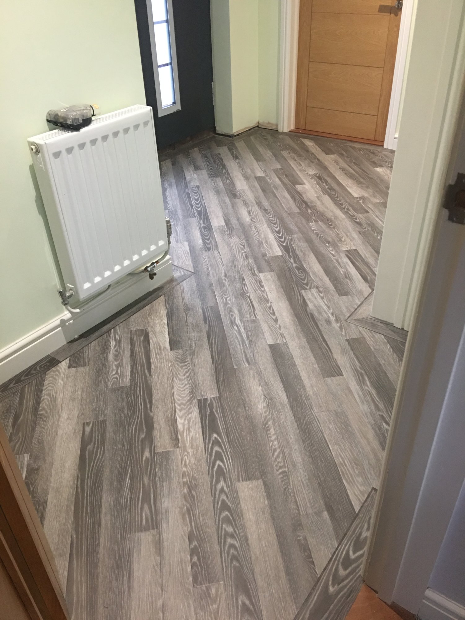

And the finished result

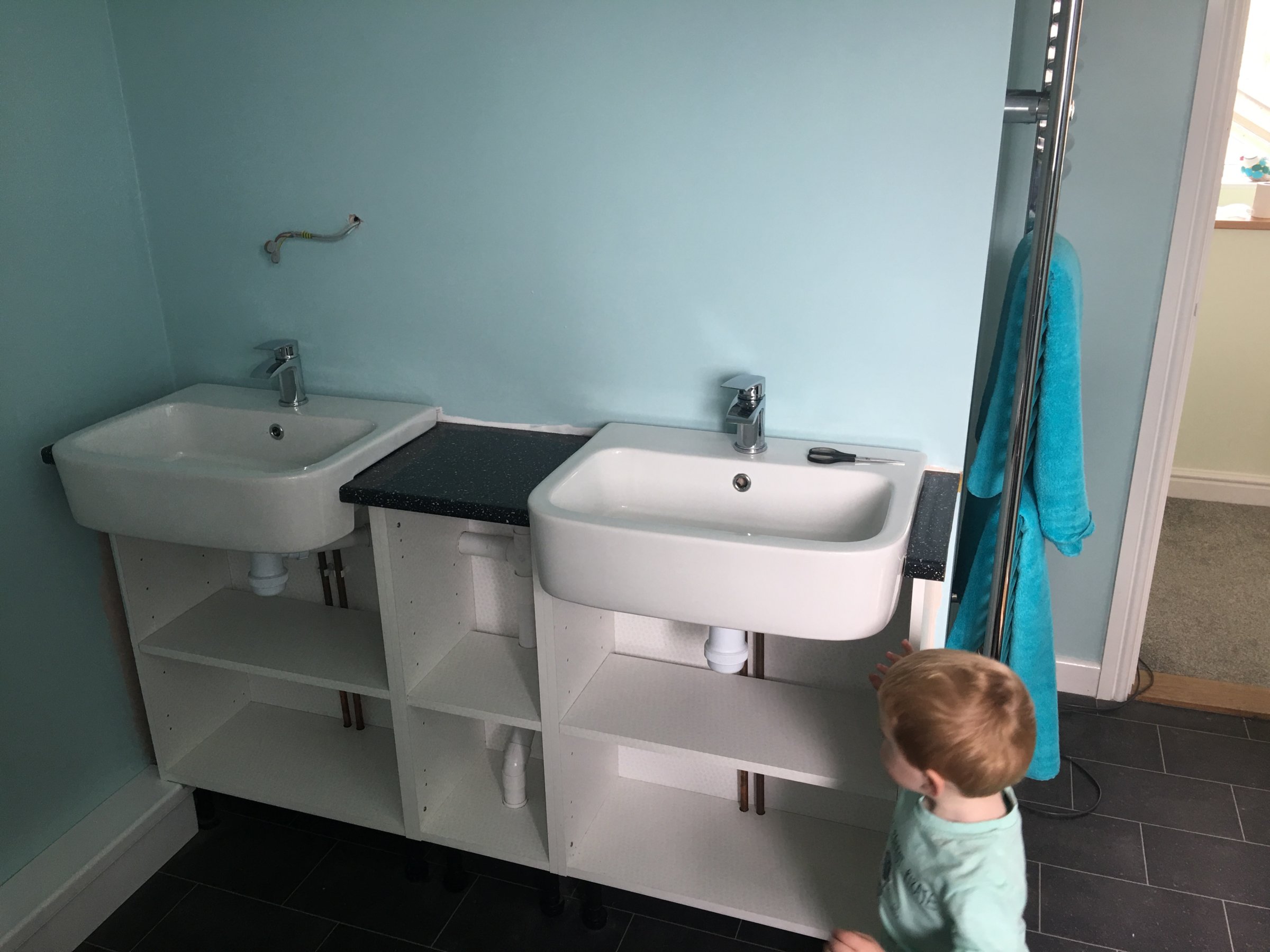

Next was back upstairs to the bathroom. If you have read through my previous posts you may remember we had custom made a double sink unit. We hadn't got around to finishing it off with doors, mirror etc.
We ended up going with acrylic doors with a metal effect edging from a company called Benjamin J kitchens. All arrived ok however the only slight issue is their standard sizes are a couple of mm too small for the b &q carcass. The gap isn't massive but still noticeable. The mirror was purchased online and imported from Poland I think. Finding large bathroom mirror made to measure in the uk is hard. The first one received was smashed to pieces in transit but they were good enough to remake it. Lastly we put in an acrylic splash back which given that the wall was a little uneven was probably a better choice than glass.

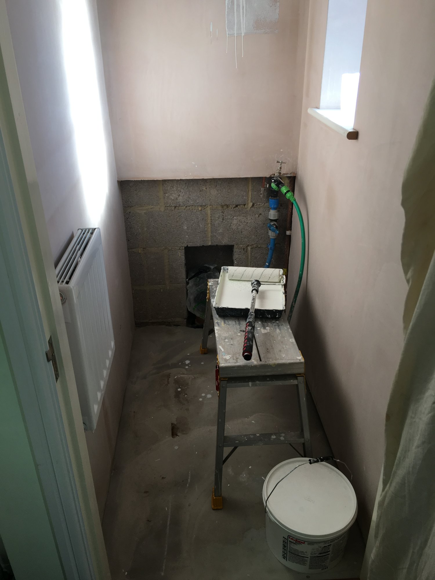

On to the last item of progress was out downstairs loo.
We went with some fancy tiles (which Kirstie fell in love with and twisted my arm to get). Personally I think they were maybe a little too Over the top, and at over £100psm it didn't sit well with the side of me that loves a bargain. Having said that I'm pretty happy with the style and I think they give the room a bit of a wow factor.

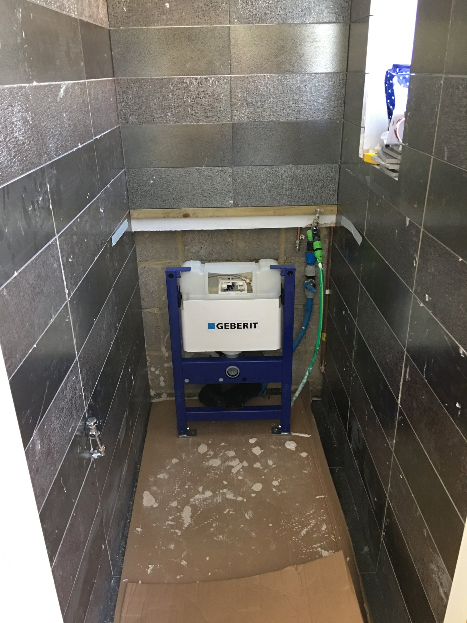

The room is very small so a lot of planning went into how we could fit in a sink. We decided rather than have a tiny one on the side that you have to squeeze pass we would put one above the toilet. There wasn't many good examples of this online but we decided to give it a go anyway.
We went with a hidden cistern and used the space above it to create a shelf. The toilet is wall hung so your feet can go under it making it easier to get to the sink. For the shelf we went to a local stone manufacturer where they had a lot of offcuts and for circa £90 got a made to measure quartz shelf. There is a bit of grouting / finishing off to do. I think we will probably put a mirror / cabinet above the sink at some point to give us a bit of storage. Anyway here are the nearly finished pics. It works really well, I just need to work a way to bring a bit of colour into the room.

Looking good. I like the way the floor goes diagonally.
Did you screed the floor yourself? What product - self levelling?
Also, hope you don't mind me saying so but to do those tiles justice, it would look great with a chrome towel radiator.
Hi bodgitnscarper. Thanks for your comments. The floor was screened by a guy who completed the karndean. I certainly couldn't have got it that neat. I think he used a stopgap screed, it certainly did the job.

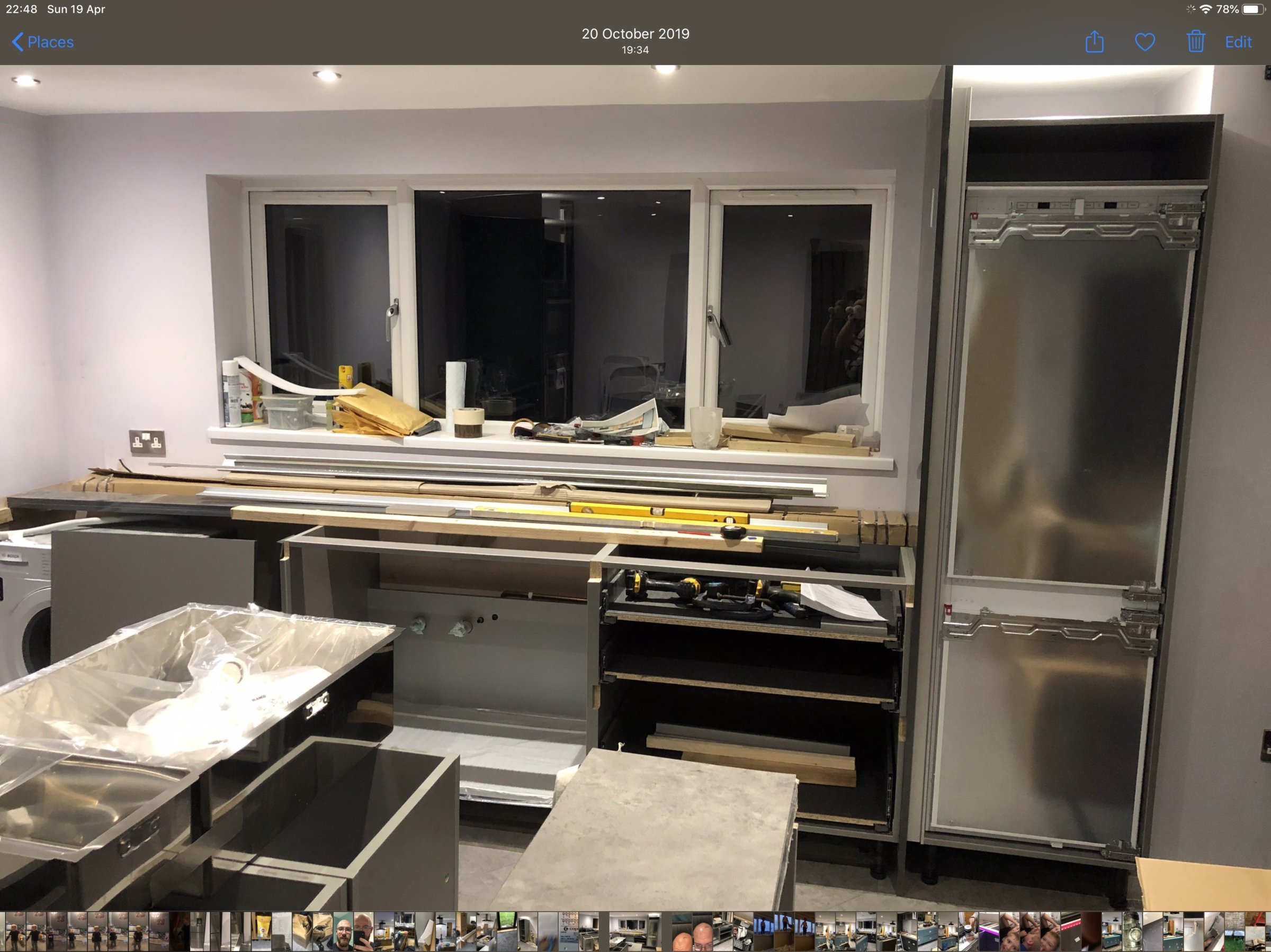

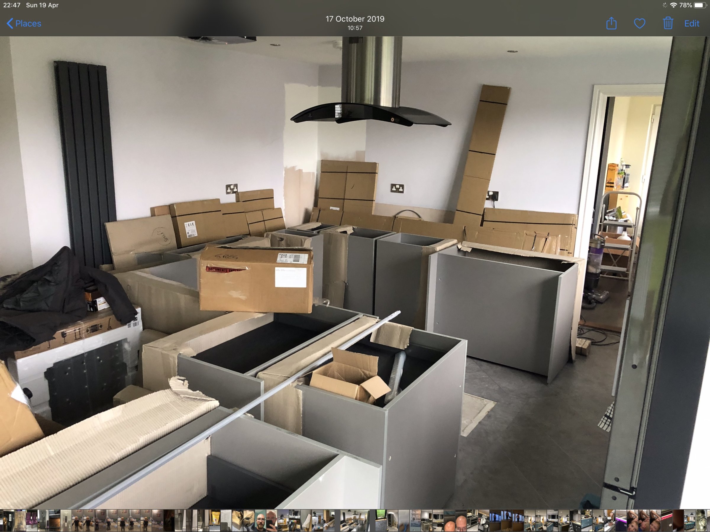

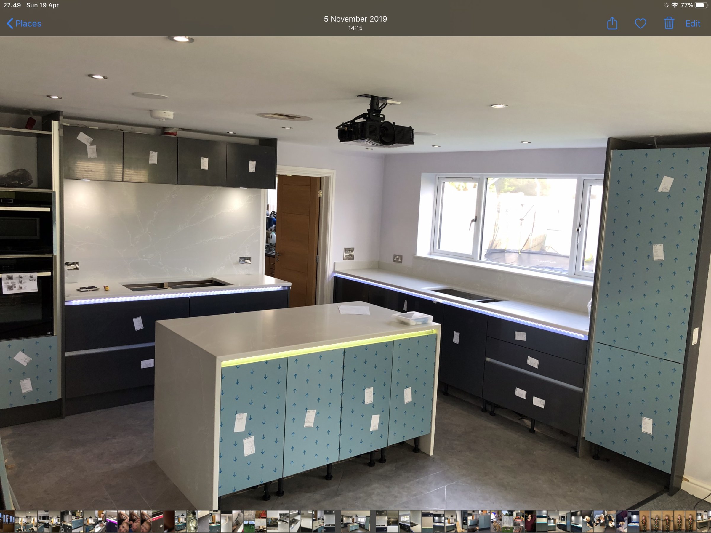

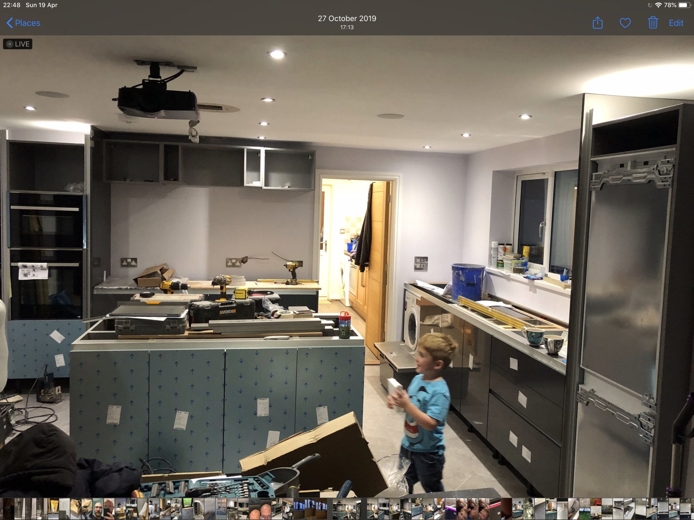

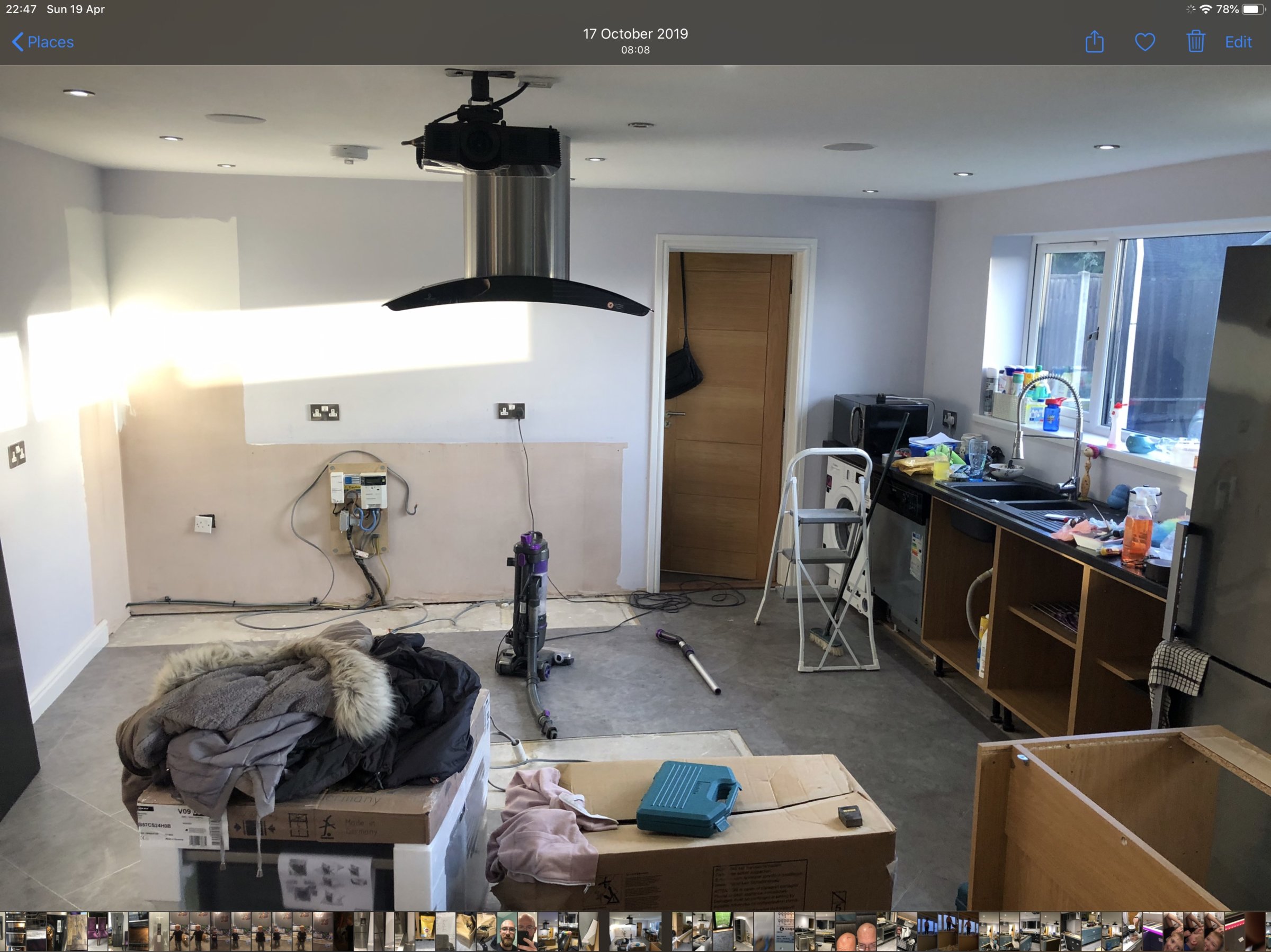

This post is an update on our Kitchen. It was finally completed just before Christmas and we are really happy with it. Anyway onto the pictures.

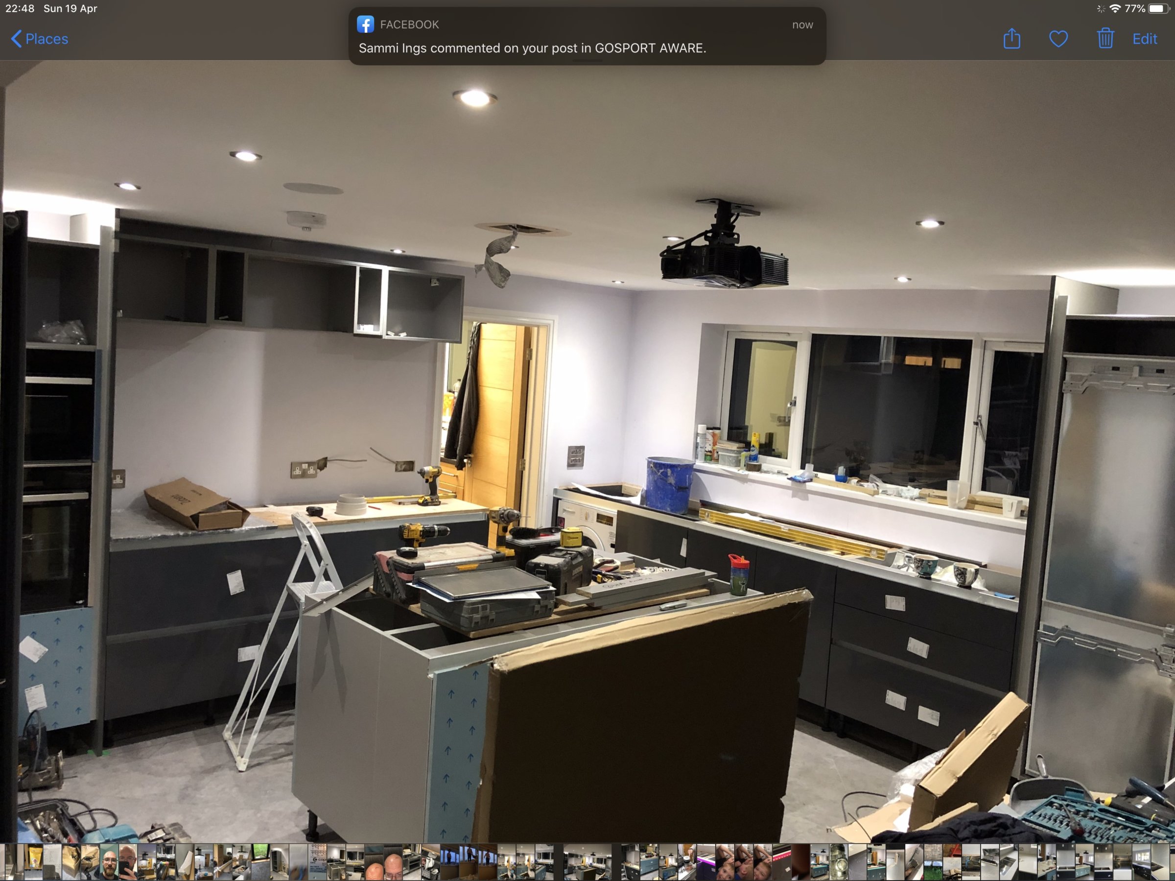

We lived the past 4 years with some temporary b+q cabinets without any doors. Originally we were going to put a new worktop on these and put some doors on. As the project evolved we decided that the cabinets didn’t give us exactly what we wanted so they were removed.
The new cabinets arrived. We went with a silver / grey colour. They were all made to measure and purchased from Benjamin James Kitchens - a really really top guy by the way. Really well priced and he never seemed to get annoyed with my phone calls, questions or changes. Thanks a Ben!

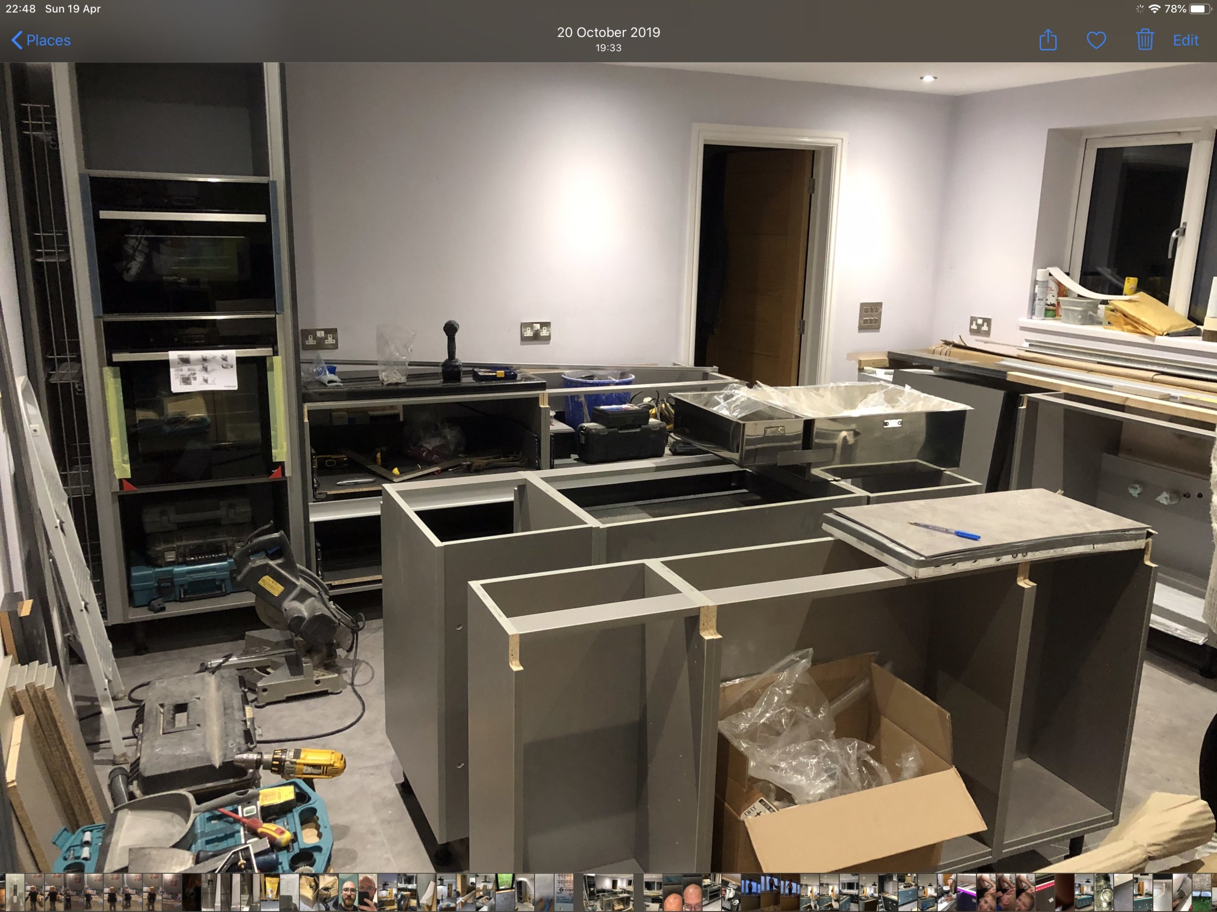

Getting the cabinets into position. You will see they are all notched out at the top. This provides space for a handleless rail design which we went for. You can get the rails built into the doors but this version gives a great continuous finish.
The cabinets were fully assembled including all the drawers which I’m sure saved a huge amount of time. We also got the cabinets made slightly deeper than normal ones. I think we added somewhere around 8cm to their depth. Although it doesn’t sound like much it really makes the workspace feel a lot bigger.

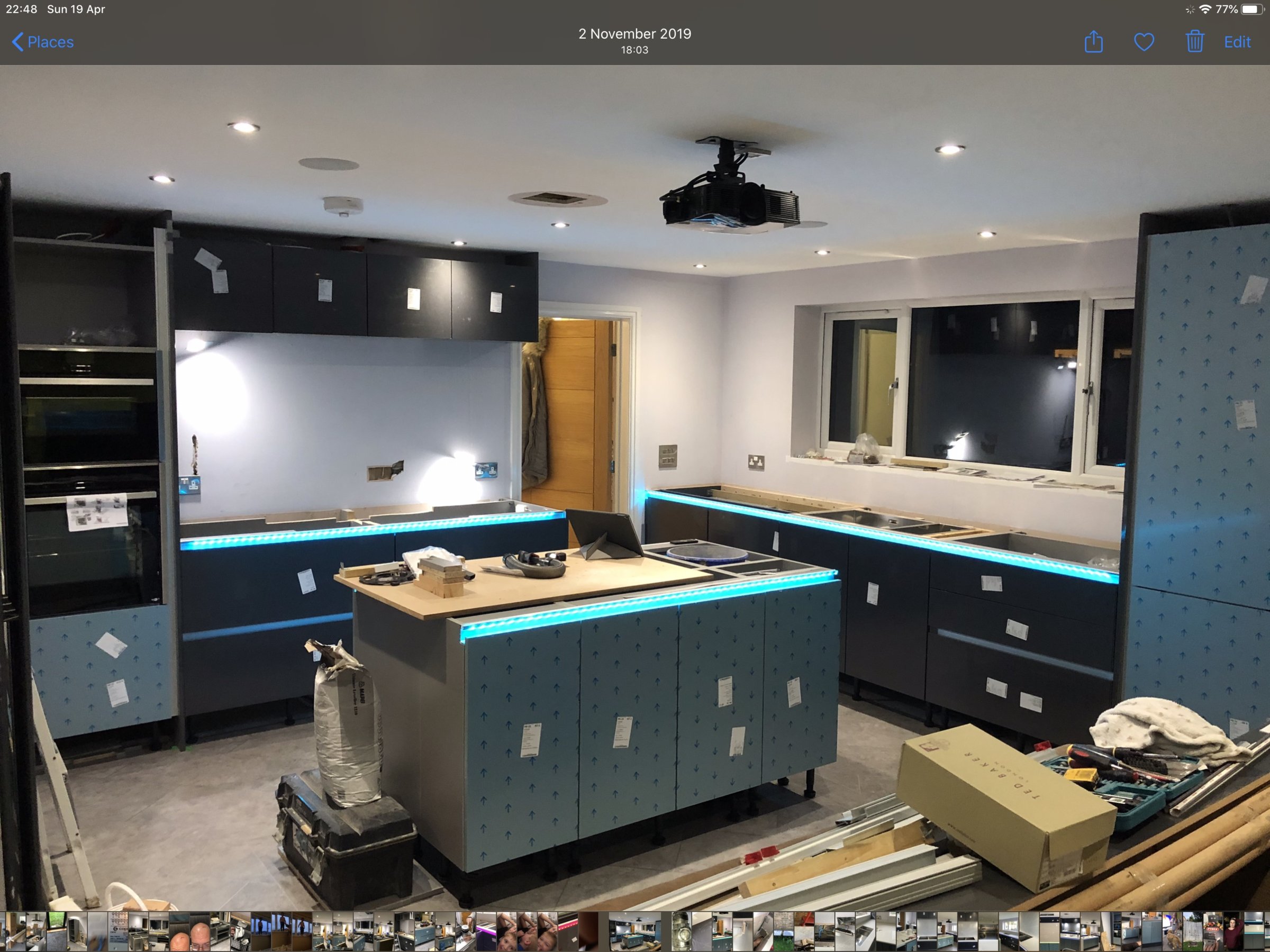

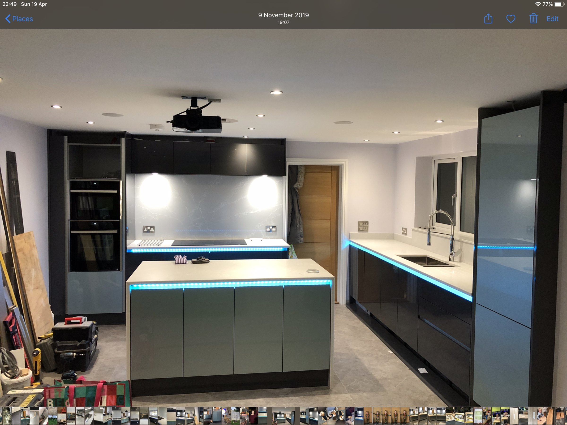

As we went with the handleless rail system it gave an opportunity to put in some LED lights. Make of them what you will. Some people think they look a bit tacky. I love them :-)
We ended up keeping as many appliances as we could integrated. This keeps a minimalist look. We were planning on keeping some of the original appliances but ended up getting all new. I managed to break our lovely job getting it out of the old worktop - note to self don’t silicone them in.
Everything about this project started spiralling but we were keen to get our dream kitchen and didn’t want to have any regrets at the end. A big part of the cost was the worktops. I’ve never had stone worktops before but my girlfriend really wanted them and my arm was twisted. Originally we were just going to get the worktops done but when I looked into the cost of glass splashbacks it wasn’t loads more to clack the backsplash in quartz. A decision in the end we were really happy with.

How is the floating design butchers block supported? Also can you show how you did the led lights in detail, might just have to steal that off you
Hi Apacheuk
thanks for your message and sorry for the delay in getting back to you. The butchers block worktop is supported mainly by the two uprights at each end. We cloaked it over the quartz by around 5cm and that was glued into place so the whole unit can’t move forward or backward. Where the worktop joins we just used standard kitchen worktop bolts underneath and it has worked well.
For the LED’s we used a standard Hafele set which excluding the power are wireless. This made them great for connecting up to 1 remote. You can just stick the strip under the worktop but often see these come unstuck and we wanted the light to be more uniform. The other issue with this (if you’re being really picky) is that if you bend down slightly your looking straight at an LED. I ended up getting a light diffusing profile for the LED’s to sit in. These are a band new profile from Sensio and they are perfect. https://www.sensio.co.uk/Kitchen-Lighting/profiles/ContourProfile.html
I’ve attached a photo which is probably easier than explaining the benefits. Firstly it’s not a clunky rectangular profile which you hit your fingers on every time you open a drawer. Secondly the front of it is blacked out so no light shining straight in your eyes if you bend down. It angles the light straight into the handless rail, just where you want it. Ps. No I don’t work for Sensio ;-)

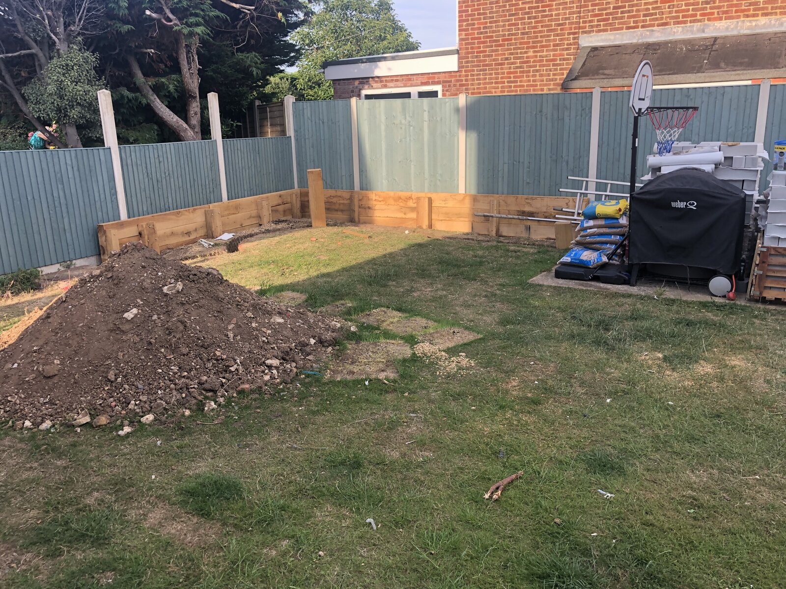

Some exciting news. Summer is here so I decided to get on with the next project, the garden. It’s a pretty big project so wasn’t sure if I should keep it on this thread or create a new one. I know quite a few people follow this one so decided to keep it here.

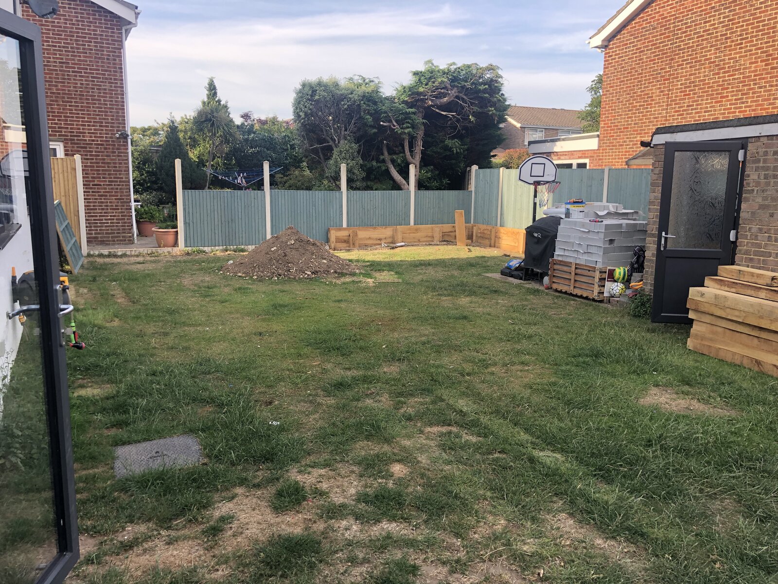

The garden has been a Little unloved for the past 4 or so years and is essentially a rectangle with a load of weeds, broken fence panels and garage which has seen better days.
This is what I’m working with. You will see in the background of the second picture there is a small makeshift fence. This is just to enclose the garden so the crazy silly dog doesn’t escape. The other side of this is a reasonable bit of land I intend to use as part of the garden. The garden is higher than the paving so this will involve a reasonable size retaining wall (phase 2).

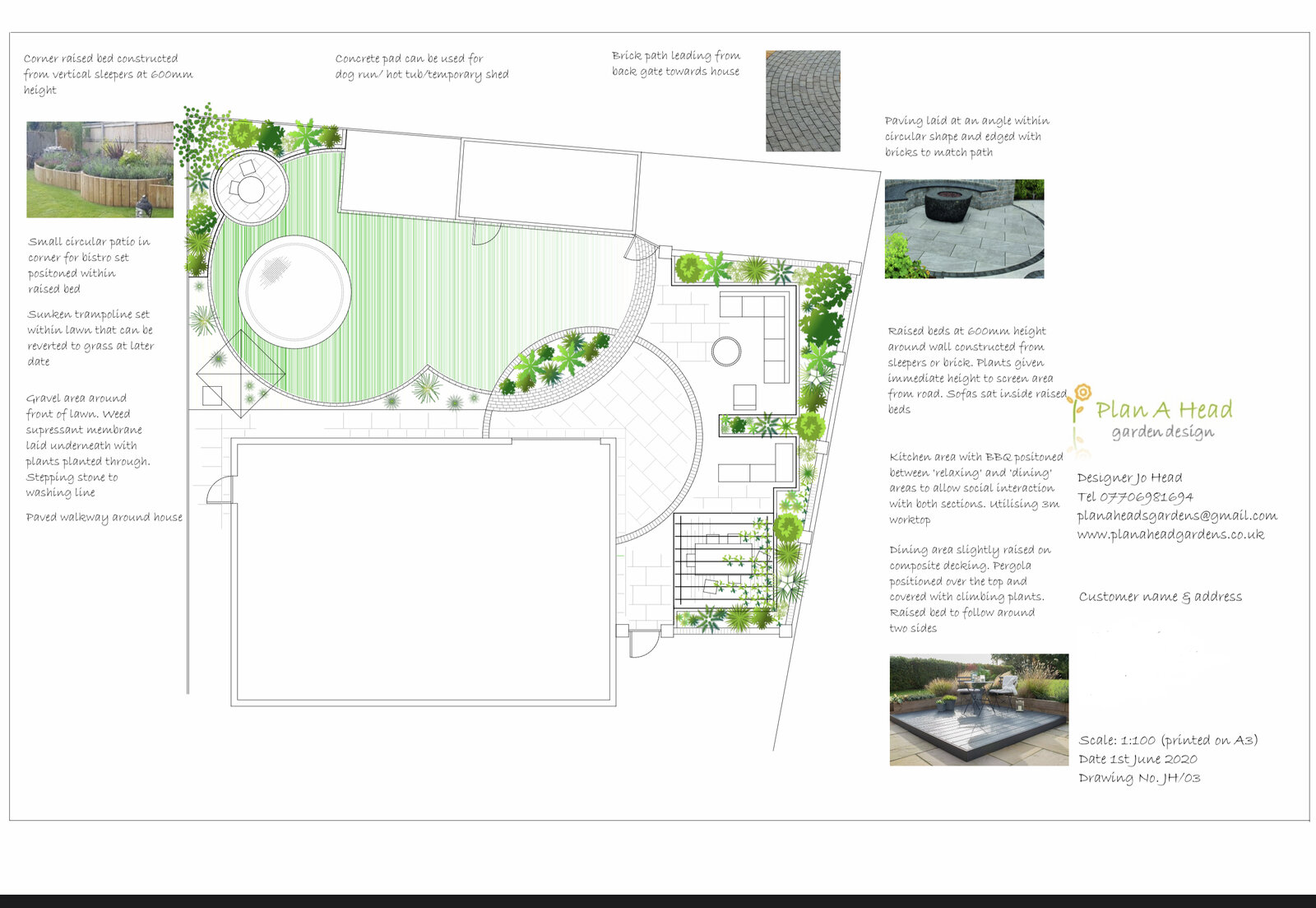

We made the decision to get some outside help in for the design of the garden. For all the work (and money) invested into getting the garden done we thought it would be worthwhile at least making sure we had a design which would incorporate everything we wanted but also include a bit of “style”. The lady we went with is local to us. Her name is Jo and she runs Plan Ahead Garden Design. Her website is https://planaheadgardens.co.uk/ and she is worth checking out as I have been really impressed with her approach the whole way through. She offers a remote design service for £250 for gardens up to 250sqm and is really thorough in understanding what you want from your garden. We had quite a big list of “wants” and she captured everything really well. In particular we didn’t want a rectangular garden. We asked for lots of curves and she delivered. There were a few revisions but this is what we agreed upon.
I’m sure as we progress there will be some minor amendments but for them moment we are happy with everything. We are now about 4 weeks into the garden (evenings and weekends) with the help of a skilled friend who is laying the paving.
marking out with my little boy. If you have read the blog from the beginning he was not even born when we were ripping down the original house. Crazy how fast they grow up.

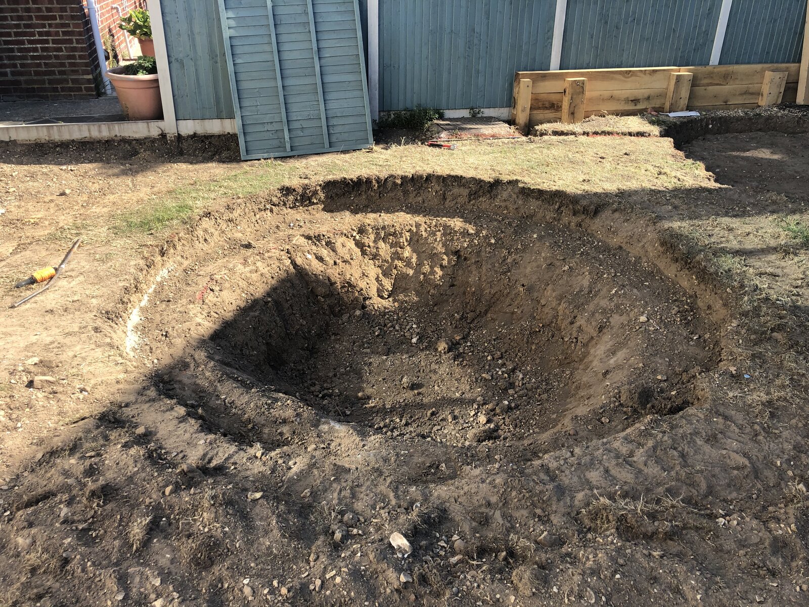

We dug the first trench by hand but then quickly realised a digger was a good idea. You will also see in the background we replaced all the fence with some heavier duty panels. We also got them lower with a trellis for the side with our neighbour as we get in really well with her and thought it would be nice to say hi when we are in the garden.
A giant hole for the trampoline
