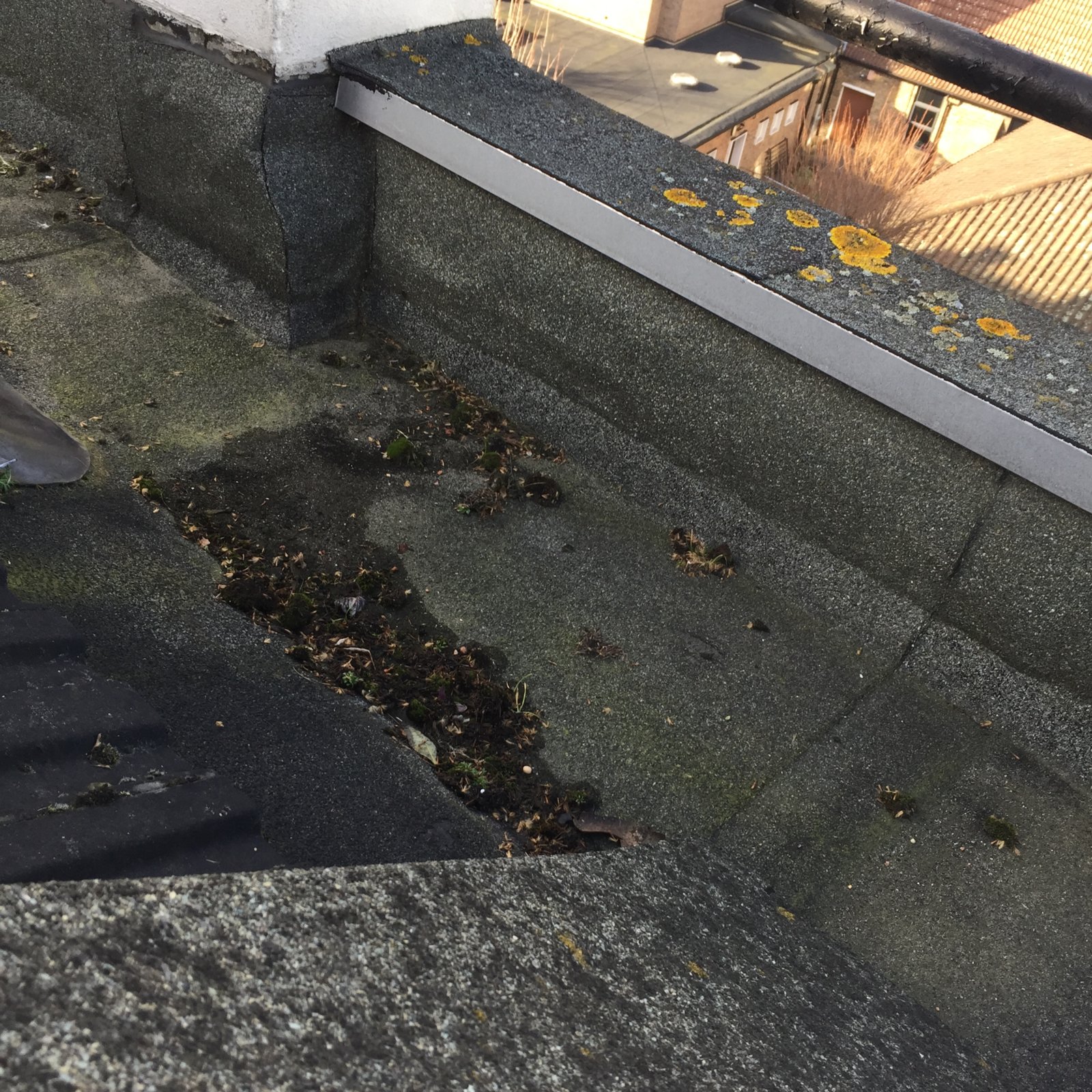

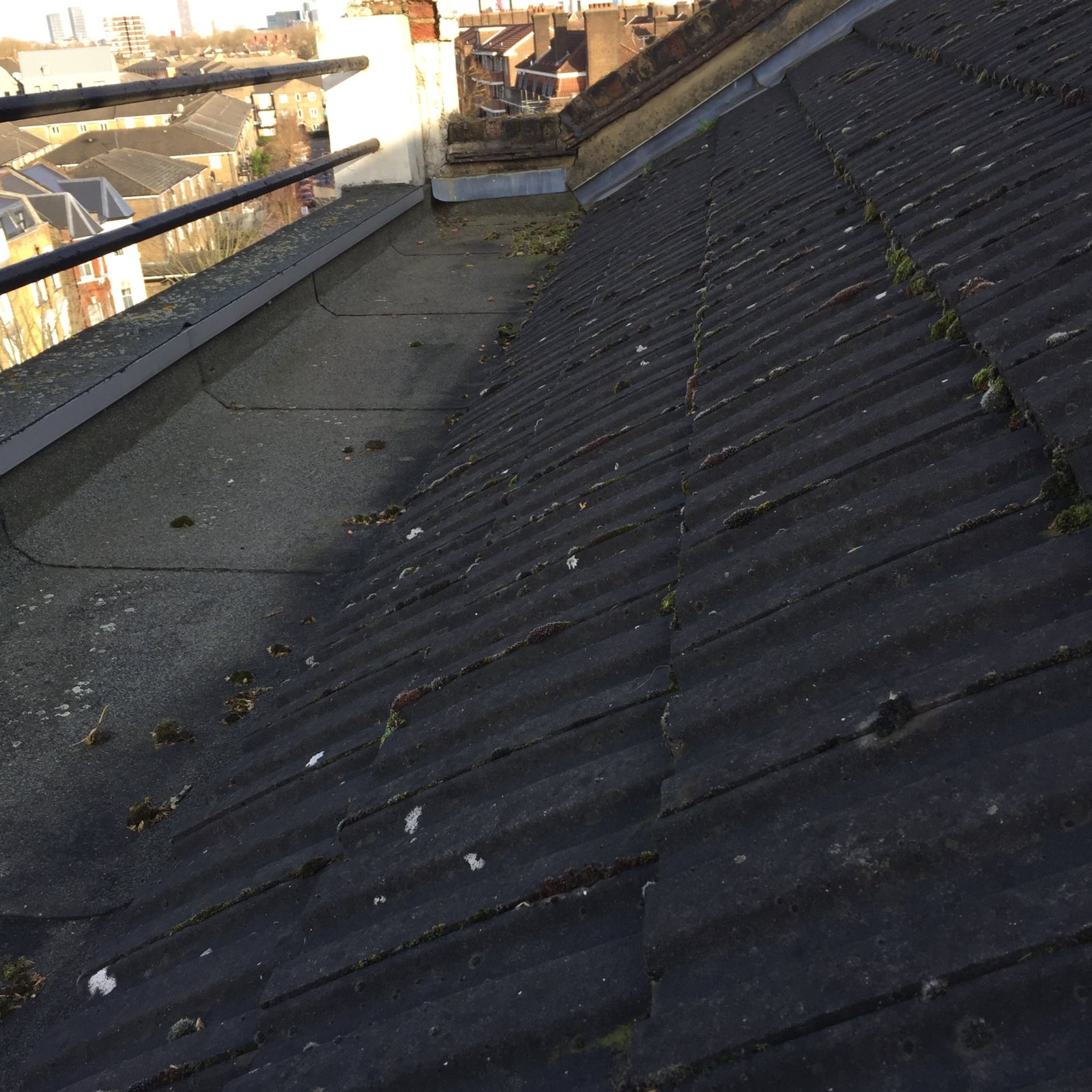

I’m trying to get to grips with a water damage problem on one side of a 4 storey late Victorian house in London. There’s a flat area - looks like a trough - in front of the sloping roof, so presumably when it rains, all the water goes into there. But from there, how does it drain? There’s no gutter. And lots of problems with water cascading down the side of the building in rainy weather. Something’s not right...
(a couple of photos attached)
Can anyone shed any light on this please? I’m a bit ignorant I’m afraid.

Do you mean where it looks a bit wet in the middle?

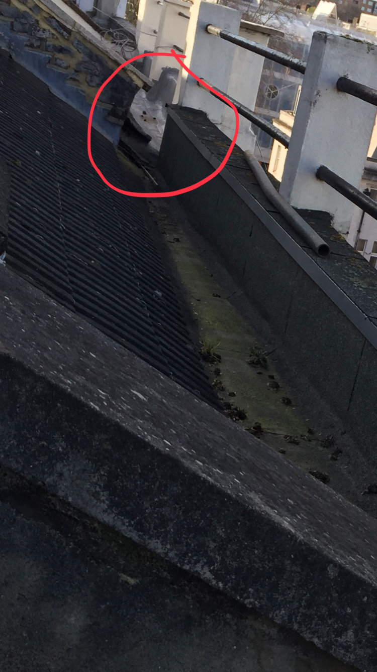

I’ve just noticed a gap at the other end - is that relevant here, do you think?
(another photo attached)

you appear to have a parapet roof, common in and around the City of London after 1666
There should be drainage from the "trough." Sometimes the downpipes are concealed or boxed-in, with an ornamental pier or fake pillar, but you might see a hopper. Might be one at each end. Drainage is prone to blockage by leaves, or by slush during a thaw. Keep a yard broom handy.
I would have thought the covering was originally lead or perhaps asphalt, and you have a recent economy repair in felt. If you can afford a better job, there are sure to be roofers in your area familiar with the technique. I see a railing. Perhaps this is part of a fire escape.

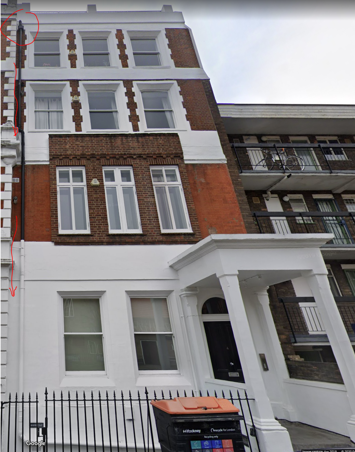

If it helps, I've uploaded a photo of the front of our house and also the front of a similar house a few doors down. Ours has no downpipe visible at the front, but the other house does. Why one does and the other doesn't I'm afraid I have no idea.

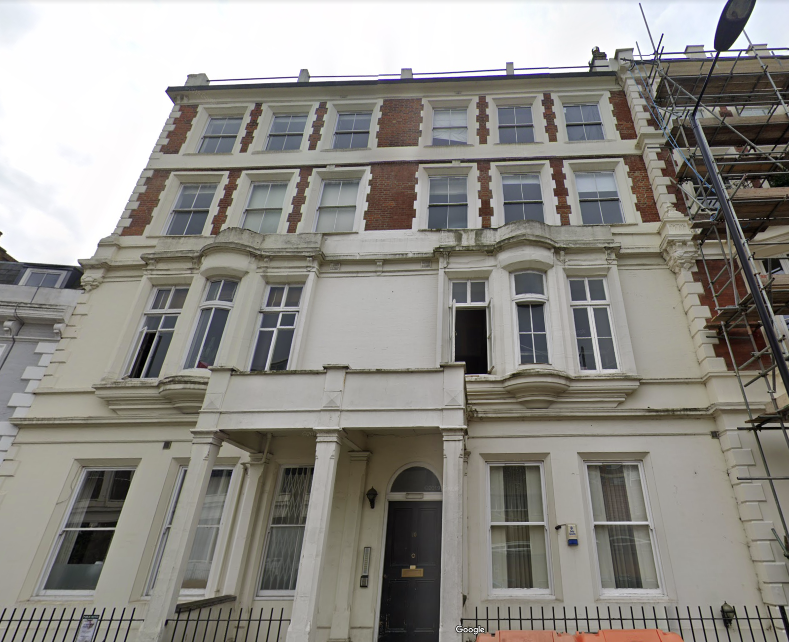

Are we getting our wires crossed...our house is the wide one shown in Capture2.PNG and the other house with the downpipe is the narrower one shown in Capture.PNG (I wanted to swap the order of the pictures around to show ours first but I couldn't do it)
clean up all the damp looking debris in the second pic, and dispose of it - a dry, large scrubbing brush will work.
as above observed, there might be an outlet in that area.
while your at it, totally clean up all traces of debris anywhere on the "trough" - it will prevent debris blocking any outlet or chute, or even blocking the down rainwater pipe etc, and perhaps reveal any cracks or holes in the felt.
there will be some kind of outlet for that "trough".
whatever is happening at the "gap at the other end" doesn't show - more detailed pics of that area needed.
the trough is draining towards the gap end of the roof.
if you go into the street and look up you can photo the facade of the building, and more drainage details might be revealed?
pic 2 shows the felt upstand on the parapet wall pulling away here & there, and opening up at the inside corner.
on the LH side of pic 2 lead flashing and felt flashing(?) are briefly shown where the main roof tiles terminate - mixing flashing materials often indicates previous repair work?
can you pic that flashing in more detail?
please show where the "water is cascading down the side of the building" on a pic of the side elevation?

oh, the house with the cream render on ground and first floor.
No sign of any downpipes on the front elevation. Tap the "stone" quoin in case it is hollow. On the RHS it looks like it might have been added after the house was built, it isn't neat in the brickwork.
Whoops...twice I talked about water running down the side of the building when I meant to say down the front of the building!
Some of the older property's used to drain rainwater through the attic to the back of the property to eliminate the need for drainpipes at the front.
Yes, on further inspection there is a downpipe inside the attic space! Where it goes to from there is a mystery...but it all seems to be working ok anyway.
I think the main problem here seems in fact to be the little flat "roofs" on top of the two bay windows (circled red in the photo). Would you call them roofs, or something else? Anyway a lot of water hits those when it rains, and it just sits there...and there are damp problems in at least one of the two bay windows. I suspect the flat roofs are quite old & knackered, and perhaps just need replacing. But should there be some kind of guttering there as well to channel rainwater away safely?

I have seen bay windows of that period with an 1 1/4 lead pipe for drainage into the cellar before now.
Nothing like that here unfortunately. There's a slightly bigger bay window on the house next door, and that has a proper surround on it and a little gutter coming out of the side. Result: no water damage! Need to get someone to come and have a look at ours and advise I think.
