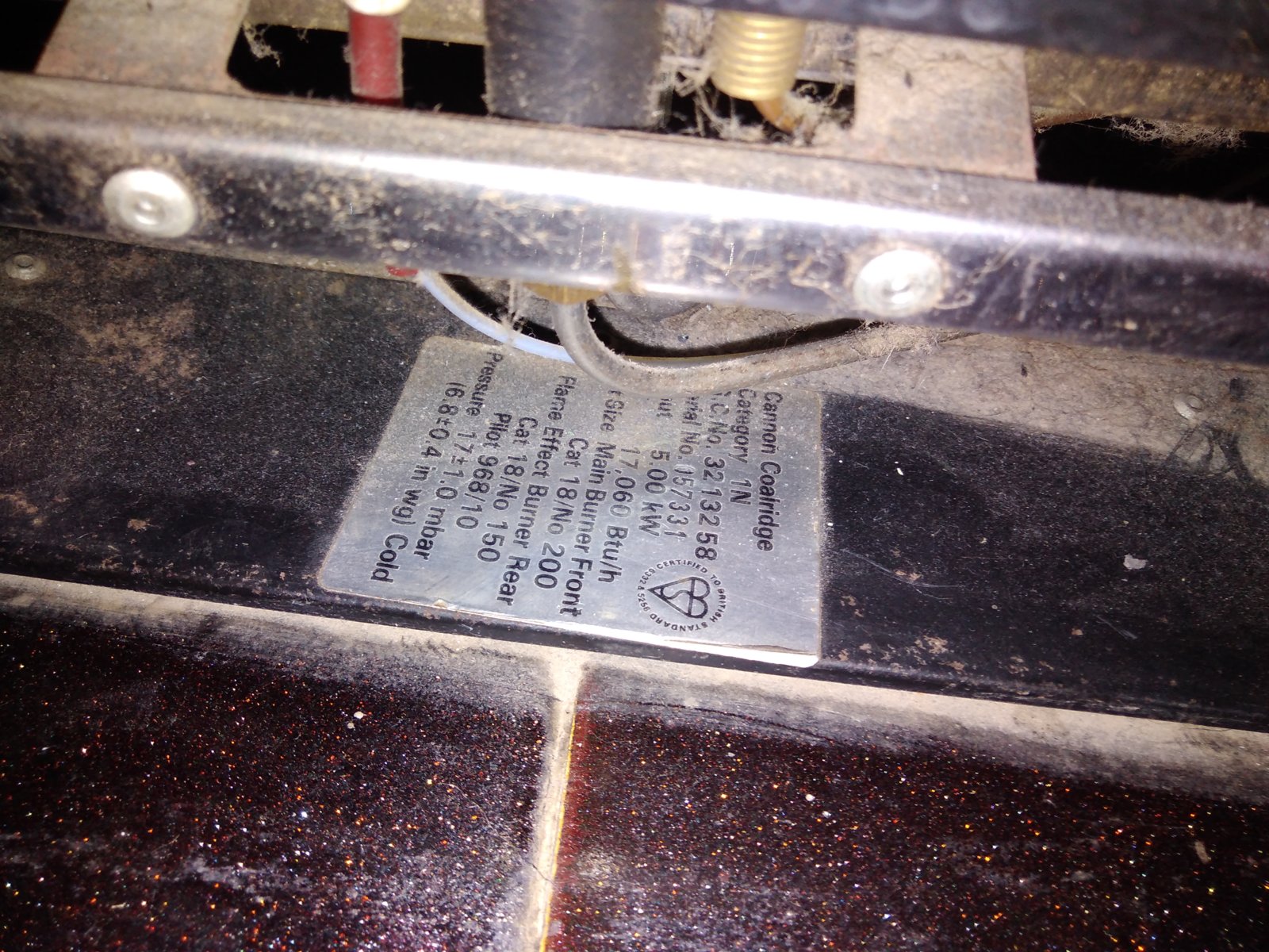

Hi,
With a recent house purchase, I have inherited an old, knackered, gas fire "Cannon Coalridge category 1N fire (GC# 3213258)".
I am having major work done on the house, and, as part of this, I am having this fire replaced.
Basically, I need to know if this is a type 1, type 2, balanced flue... etc etc fire/chimney, so I can buy a suitable replacement fire, can anyone advise please?
I'm (obviously!) not doing the job myself, I just need to know what to order for my gas engineer to fit.
Thanks,
Colin

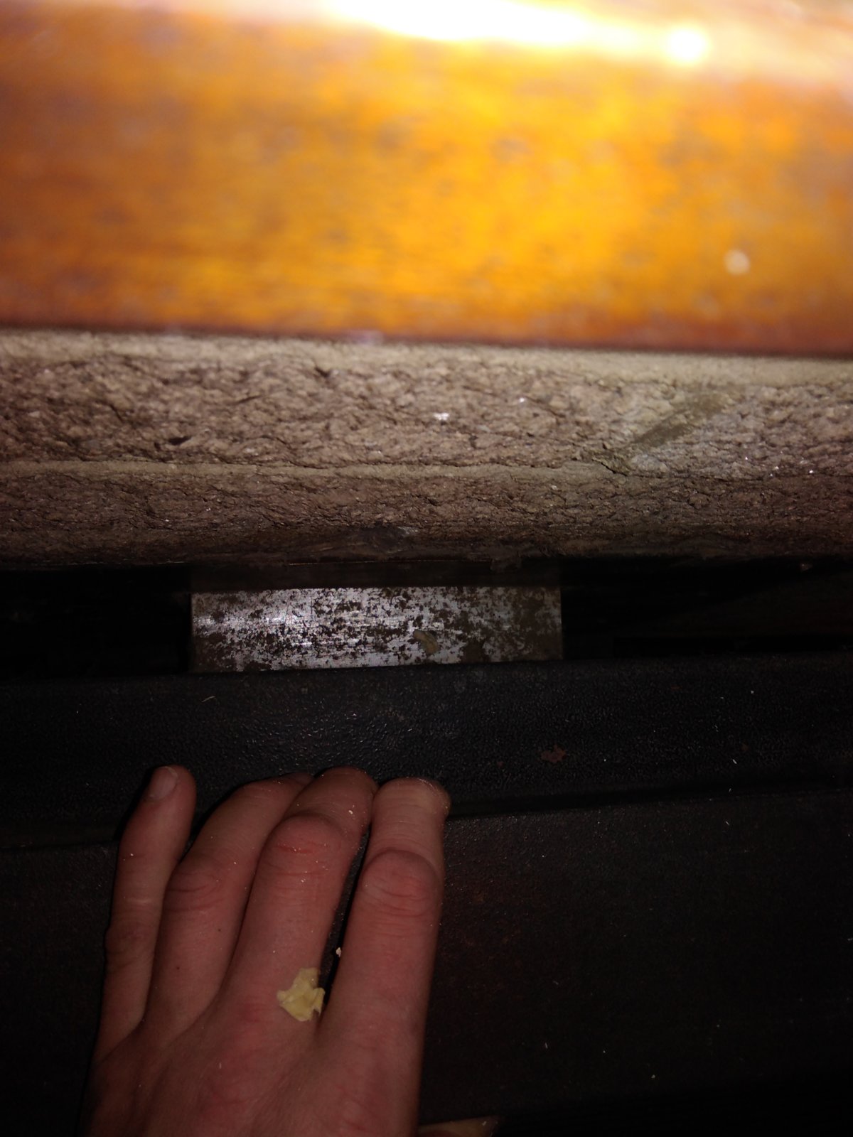

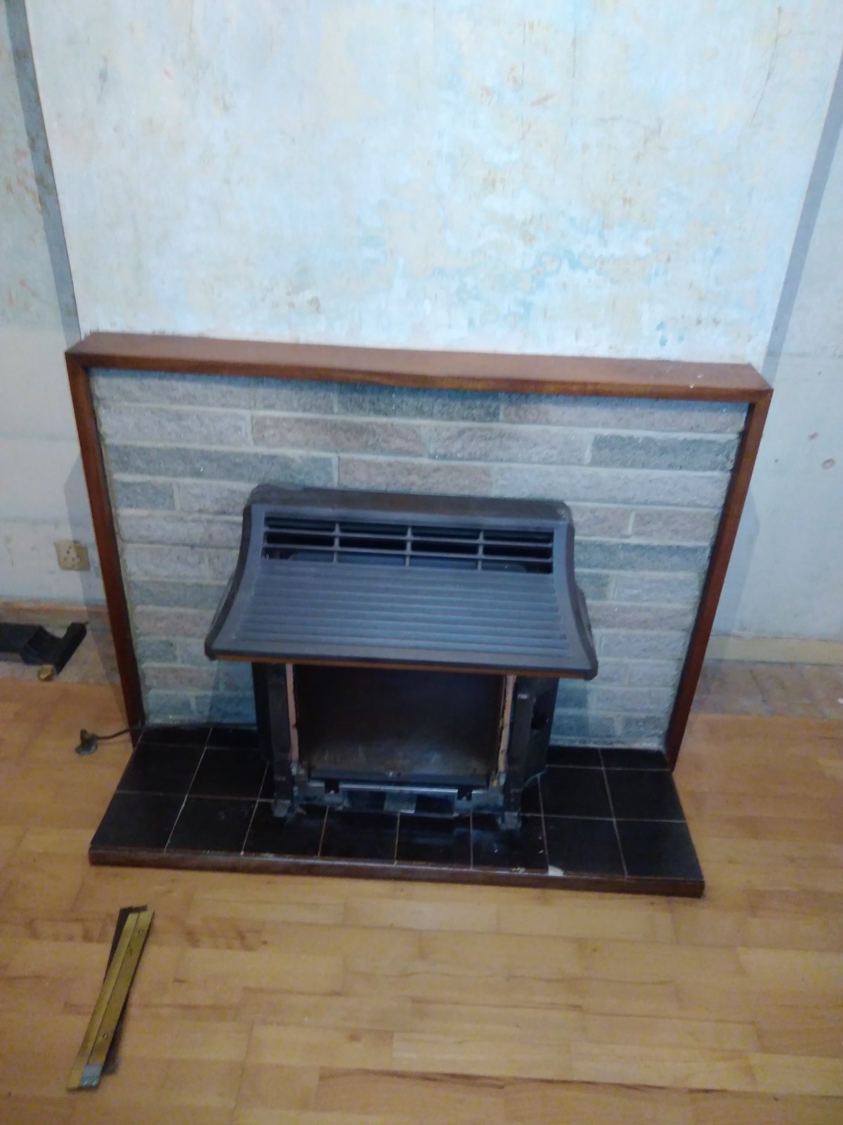

Hi, please find below a couple of pictures of the fire as requested.
One thing I did notice is that it is not fixed to the wall in any way, and can be lifted away from the wall of the fire-place, outwards into the room...!
Does the rectangular bit at the back look like a balanced flue - I'm not sure.
Thanks,
Colin

That's an open flued appliance fitted into what appears to be old fire opening. There will be a chimney above it outside on the roof. Only an inspection by a RGI will confirm the flue is ok for a new fire.
Thanks, yes, I'm going to get my RGI to have a look before buying anything - I may end up with a new electric fire in the end... haha.
It's a surprise to see it like that though, I would have assumed that the flue should all have been sealed.
I'll let you know what the outcome is - thanks everyone for the help.
