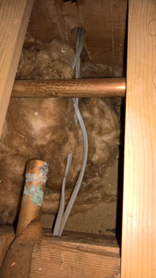

Ok guys bad news for me. I looked under the floorboards and the wires for this run into the bedroom next door. So I would have to lift planks nailed in to view it. Trouble is I have the carpet fitters coming to do the bedroom tomorrow!! So worst case scenario can I just leave this wire in a terminal (placed under floor) and it should be relatively ok? What are the major downfalls leaving it in the terminal if its been like that for years?
pic of the wires. Are these grey ones used for anything specific? Cheers

What do you think it is heading towards in the bedroom? Sockets maybe? Other junction boxes?
Unscrew any sockets and see what you find. How many cables going to them, for example.
You said you used a mains screwdriver to test with.
Can you tell which size circuit breaker or fuse at the consumer unit serves the old junction box?
It should be noted these mains screwdrivers are for guidance only and must not be relied on as they can give misleading results.
I think the white cables go into the plug sockets. My best guess would be this grey feeds into another round junction box in the bedroom under the nailed down floorboard. There are three double plug sockets only in that bedroom. Maybe they all feed into that? I'm thinking of lifting the board before they come, though cutting it as its a nightmare to put back again. You guys really think its that bad to leave the wire there?

I just did a test with screwdriver. Read as live current, then switched off sockets on circuit breaker and the screwdriver didn't read anything. So definitely connected to plug sockets. It has to be via junction box no?
Could be, might not be.
As mentioned above, it could be something to do with the heating system. This may be fed from a socket circuit via a fused connection unit. It could be something els entirely.
The major downfall is that if the screwed connection fails, they can do that over time as the copper material of the cable is softer than the brass terminal screw.
That means that your nice new carpet has to be pulled up whenever (whatever it is) fails, to access the terminal block.
That is the main reason why Maintenance Free terminals are mandatory in these situations.

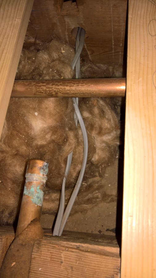

so would these wires feed directly into a socket or terminal junction? Here is a pic I took under the floorboard in the room. Down the bottom is where the wire is fed through the gap in wall. You can see some sort of white thing down there. Does it look like something?

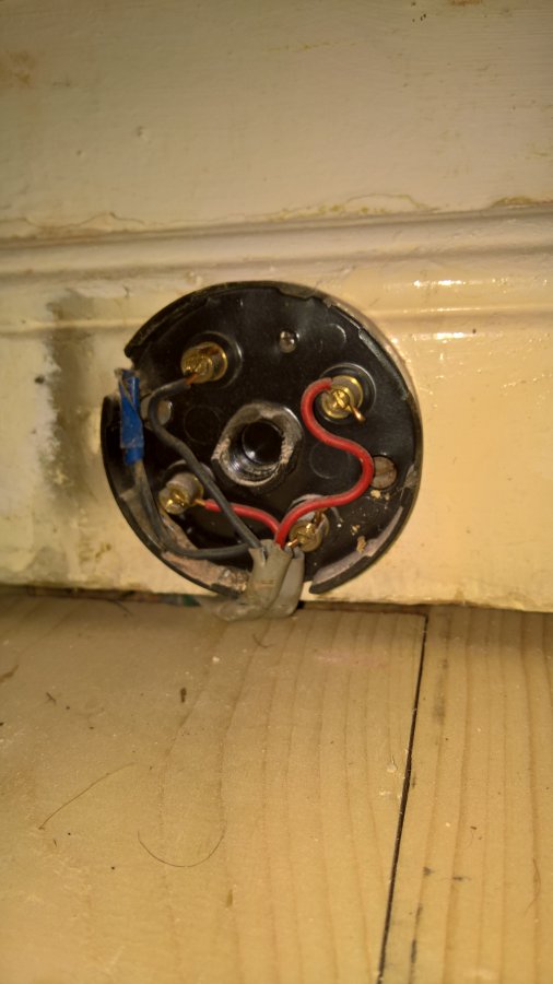

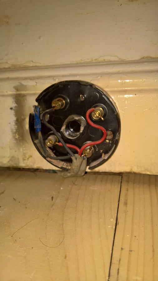

So I'm going to just replace the junction box and leave it under the floor. Though can anyone explain the wiring in this junction box? Why is one of the black wire (in blue tape on the left) left out and both the ground wires put in the screw instead? The bare copper ground wires should not be screwed in correct? How should I put these wires in the new junction box? Cheers

Cannot really explain anything, as you was instructed in earlier replies, testing of cable was required to establish what, where and why?
It seems that advise was ignored/overlooked.
There are a whole number of what could have beens, but without testing, everything else is guesswork.
I would say the black conductor has been taped to prevent it from accidentally coming in contact with other conductors to prevent any dangerous or potentially dangerous hazards.
As there was no other spare terminal. ideally this should have been terminated to a separate connector but still enclosed.
The bare copper wires are very very likely to be the circuit protective conductors (CPC, aka earth). They should have been sleeved green (back in the day) or green/yellow (present day).
And yes they should be terminated together so continuity is preserved of the CPC.
I hope you have not in anyway altered this for the worst, hopefully improved it?
It really should have been removed at upstream source, if possible.
Last Friday, before this all got so immediate, you were advised by Sparkwright
A maintenance free Hager junction box (20 amp) would be ideal.
Be certain you have safely isolated the supply to this old jb fully. If in doubt get an electrician in.
