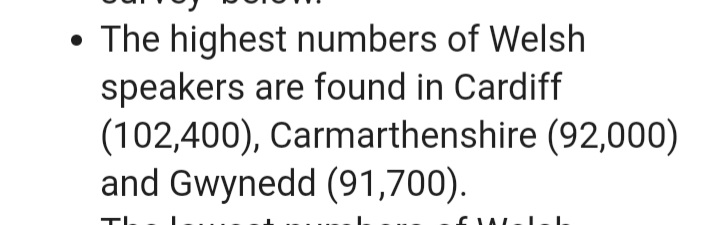

Clearly there are problems using the Welsh language, we see many examples of poor translation, and it does not help when they moved to capatial from Mac to Cardiff where few speak Welsh.
It would be interesting to issue an EICR in Welsh, clearly no Junction boxes!
