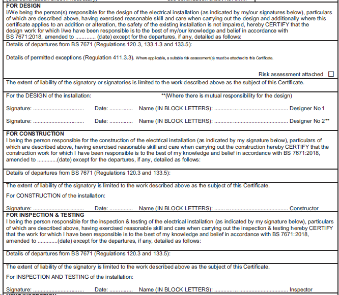

I knew I had it some where, so where the work is done by some one not trained to do inspection and testing no EIC will be issued, all you have or need is the completion certificate. It seems the certificate issued is not called an EICR it is called a "final certificate". This is where I found it there have been some changed I think now you need to pay for the inspection.
I think that you're really only telling us what we already know - that a BC body (e.g. a LABC) will not issue an EIC (because, as we know, it cannot, since it didn't carry out the work, and therefore could not sign the declaration) - but that's nothing to do with the question of an EIC being provided (or not) by the person who did carry out the work.
Looking back to the original OP, I think I've probably been misunderstanding the situation. I had been thinking that the work was undertaken by someone who could/should have provided an EIC, but who simply had 'disappeared' before providing one. Now looking back, goodness knows who did the electrical work, because I now see that the plan had been that someone else ("the Builder's Electrician") would 'certify' the work. Given that this other person did not do the work, there was clearly no way that he could ever have provided an EIC without lying through his teeth. That "Builder's electrician" is apparently now saying that he cannot issue an EIC because the work (which he only 'vaguely recalls' being told about) was carried out more than 30 days ago (not a consideration I've ever heard about), whereas the truth is that he could not, without falsifying the declaration, issue an EIC even if the work were completed yesterday.
frank999: You asked me "Without the EIC who takes the responsibility for this ?" but, to supplement what I replied before, can't you see how the answer to that is influenced by what I've written above? It seems that you would probably have been happy (that someone 'was responsible') if, as planned, the Builder's electrician had provided an EIC yet, since he did not (as I now understand it - is this correct?) carry out, inspect or test the work, that EICX would have contained a totally falsified declaration - and hence would be meaningless in law. I wonder if you (frank999) have actually seen the declarations which someone who provides an EIC has to sign? ...

So even if the builders electrician did issue an EIC since you know the electrician did not do the work, and the builder was not qualified if some thing did go wrong, the certificate would be worthless.
If you employ some one to inspect and test, and you think he has the ability, even if it turns out he hasn't, the the court is less likely to blame you.
They talk about reasonable steps, and an EICR is a reasonable step, so it would likely work as a get out of jail free card.

As it stands the owner would go to jail, as he knew the work had been done by a non skilled person. I was told in no uncertain terms when we took over a job from a builder who ran off, unless the electrician doing the work turns up in a sign written van, or presents paperwork to show he is a scheme member, it is the owner who must ensure the LABC is informed about the work, although a builder will often do it for the owner it is the owner who must insure it is done.
I am sure you remember the Emma Shaw case where the electrical foreman went to jail as he was the person in control, even though he never even visited the house, and all the faults were caused by skilled tradesmen, he had used an untrained semi-skilled person to do the inspecting and testing, who had fudged up some results, so it was considered the foreman should never have asked him to have done the testing.
If the person in charge, in this case the owner, asks some one who should have the skill to inspect and test, and he does what ever the inspector asks, then he has transferred the blame should some thing go wrong, so he needs to get the LABC inspector to either inspect himself or you engage some one to inspect it for him, and to issue a completion certificate, if the LABC inspector wants some thing exposed then he will request it, for the owner to try to inspect is pointless in this case, as like the electricians mate in the Emma Shaw case he does not have the skill. It seems from that case skill is required to plug in an impedance meter and press the button and write down the results.

I suppose it depends to some extent on the details of what the contract said, but if you engaged a builder to 'do everything', then I would have thought that you would have reason to expoect that all the work was done competently (by people competent to do it) and that all the necessary paperwork and legal/bureaucratic requirements would also be dealt with. That has clearly not happens - so, as I said, the extent to which the buyiklder can be held responsible depends upon the contract.
I have approached my electrician, and suggested that if new cabling is run, and accessories rewired, so in essence it is a new insstallation, would be then issue an EIC ...
To have any of the installation work "ripped out and re-done" would, in my opinion, be ridiculous. You really shouldn't have to do that, even if you can afford to.
... but has said he will still only issue an EICR, I am miffed why, I have told him their are funds available to get this all done, am I faced with simply turning to yet another electrician.
That makes no sense. If an electrician undertakes new installation work then, per BS7671, he must issue an EIC (or equivalent). Unfortunate though it may be, it does indeed sound as if you may need "yet another electrician" - but, as above, I really don't think you should be considering getting anyone to 're-do' the work, just because of this 'paperwork issue'.

Well, as discussed, if, for whatever reason, the person who did the work cannot or will not provide an EIC, then there is no alternative - inspection and testing 'by someone else' then has to be done, and that can only be an EICR (or equivalent).
