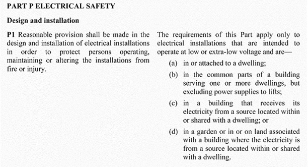

Well, my question was the opposite of rhetorical - whatever that is.
Part P says no such thing; this is Part P of The Building Regulations in its entirity:
That's it; there is no more.
To satisfy that, an accepted way is following BS7671.
Other things get called Part P this and that but they are nothing to do with it.
BS7671 The Wiring Regulations state that all work shall be tested and to record the results sample certificates are shown and may as well be used but are not mandatory in that form.
Anyone can complete the certificates for their work so there is no reason not to issue one.

Approved document Part P Building regulations 2000 said:
c. Where installers are not qualified to complete BS 7671 completion certificates
1.24 Where such installers (who may be contractors or DIYers) carry out notifiable electrical work, the building control body must be notified before the work starts. Where the work is necessary because of an emergency the building control body should be notified as soon as possible.The building control body then becomes responsible for making sure that the work is safe and complies with all relevant requirements in the Building Regulations.
1.25 The amount of inspection and testing needed is for the building control body to decide, based on the nature and extent of the electrical work. For relatively simple notifiable jobs, such as adding a socket-outlet to a kitchen circuit, the inspection and testing requirements will be minimal. For a house re-wire, a full set of inspections and tests may need to be carried out.
1.26 The building control body may choose to carry out the inspection and testing itself, or to contract out some or all of the work to a specialist body which will then carry out the work on its behalf. Building control bodies will carry out the necessary inspection and testing at their expense, not at the householders’ expense.
1.27 A building control body will not issue a BS 7671 installation certificate (as these can be issued only by those carrying out the work), but only a Building Regulations completion certificate (the local authority) or a final certificate (an approved inspector).
I knew I had it some where, so where the work is done by some one not trained to do inspection and testing no EIC will be issued, all you have or need is the completion certificate. It seems the certificate issued is not called an EICR it is called a "final certificate". This is where I found it there have been some changed I think now you need to pay for the inspection.
