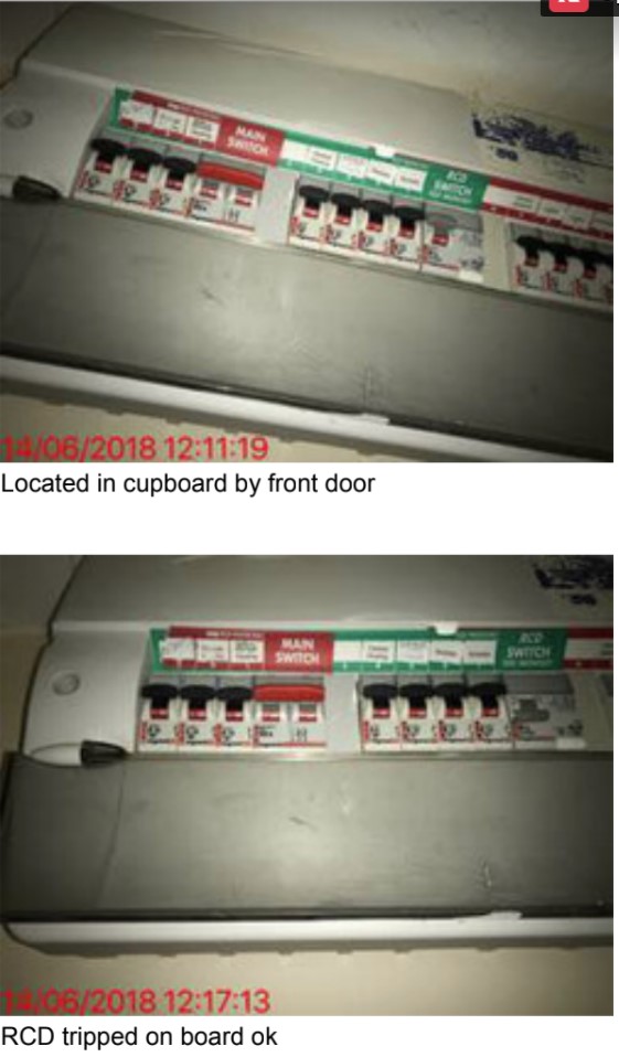

Post a photo of your Consumer Unit, you might be able to get RCBOs for it which you could get an electrician to install for you.
Thanks, pics attached
Hi Sarah,
The Lighting MCBs could be moved onto the RCD module easier enough and the Storage heaters? (circuit 9) don't necessarily need to be on it. I'm sure a half decent electrician could reconfigure that for you at a fairly reasonable price. Probably have New Mains powered Smoke detectors too.
Chivers

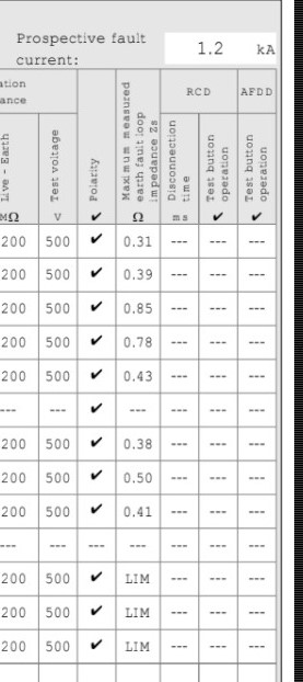

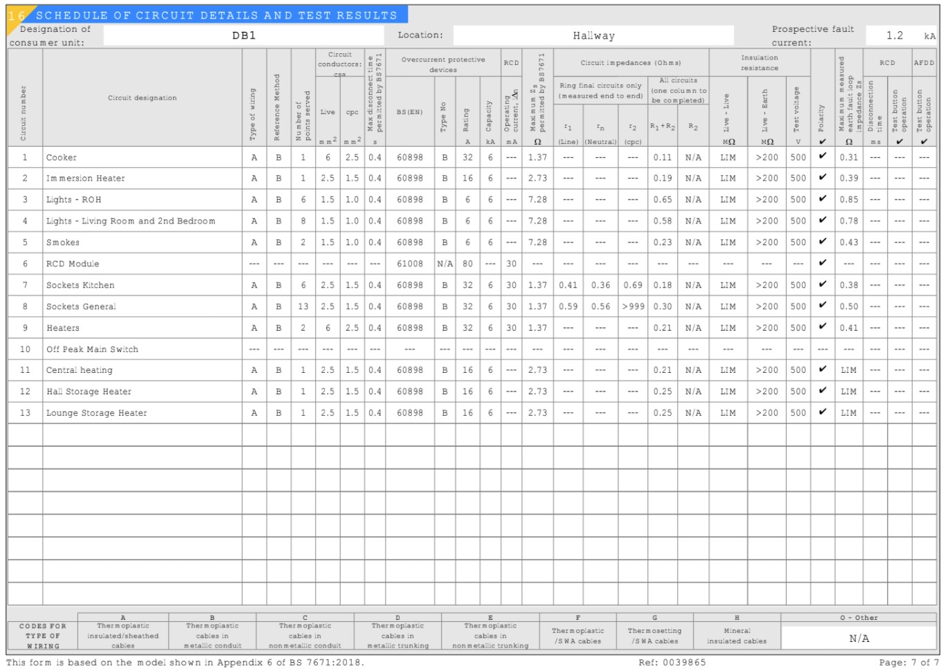

BTW have you got a clearer shot of the Cert as there appear to be no RCD disconnection times.
Thanks for the reply.
Is that the 3rd column from the end? If so, it does not have any disconnection times (is that odd?) which is from the current failed report. The photos of the CU are from a passed report back in 2008, as it's all I have.

However the schedule of results has some odd things Live to Live insulation resistance LIM what the heck is that? Same entered for ELI for the off peak, it shows 3 circuits RCD protected with a 30 mA RCD but no tripping times, so why?
