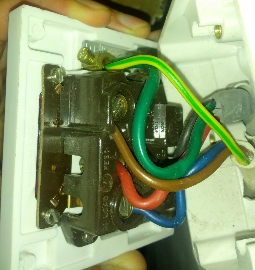

One of the bedrooms has a cupboard with a combi gas boiler.
The boiler is connected to the mains via an isolation switch, which is mounted on the wall inside the cupboard.
I've bought a somewhat bulky wireless printer and thought the cupboard would make a good house for it. As there are no sockets in there, I'd have to fit one.
I have a socket, a surface mounting box, isolation tape and plenty of cable. I've heard terms such as ring, radial circuit and spur, but I'm not sure what they mean and what I need here. Can someone please advise on how to wire it, in terms of what wire connects to what, and whether I need to buy anything else (fuses for example...?)
I might use the socket for other purposes than the printer, but they'd all be low-wattage.
Your first job is to find out if the feed to the isolation switch is on a ring final, or a radial circuit.
A photo of the wiring to the back would be useful.
PS, does the boiler isolation switch have its own fuse?
Here is a photo:
The boiler is on its own circuit according to the card on the fuse box (although there are 2 cables coming out of that slot).
The isolation switch does have its own fuse.
Next questions, then.
1. What is the value (in Amps) of the fuse or MCB that is protecting the "boiler" circuit.
2. Can you post a photo of your fusebox as new sockets need a special type of protection, called an RCD, need to know if you have one.
3. It sounds like something else is also powered by the "boiler circuit" if there are 2 cables attached to the fuse in the fuse board. What also stops working if you turn off that MCB/remove the fuse of the "boiler circuit".
I am trying to determine if you could just hang another socket off the back of the boiler isolator switch, or if you need to other things too.
16 Amps
I haven't found anything that would stop working beside the boiler. It's possible that the other cable is not in use anymore (?).

What sort of cable?
I have 2 cables, one 1.5 mm2, the other 4 mm2. Both are Twin & Earth.

You will need two things. A length of cable - you could use the 4mm, but it may be too big for the terminals. The 1.5mm² is just (but only just) within spec. For me I would use a length of 2.5mm².
You need to connect to the L,N and E of the FEED terminals on teh boiler isolation switch.
You will need an RCD protected socket. The RCD in your fuseboard is 100mA trip and that's not correct. Sockets must be protected by a 30mA RCD.
One of these will do you.
Thats all you need.
