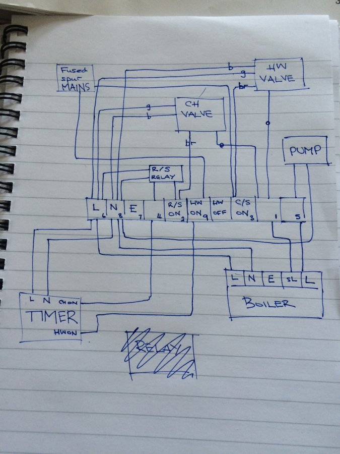

I currently have an Ideal Logic Heat 15 boiler installed on what I believe to be an S-Plan system. The boiler is located in the basement, the hot water tank is on the first floor and the header tanks are in the loft. I currently have a Honeywell relay unit wired into the junction box and a wireless thermostat located on the ground floor. The system is controlled by a Honeywell programmer.
I have purchased a Nest thermostat and, depending on the answers I get on here, would like to install it myself.

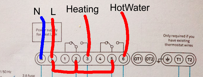

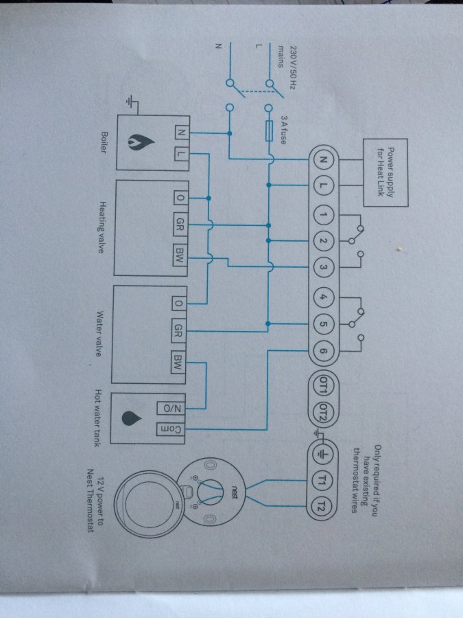

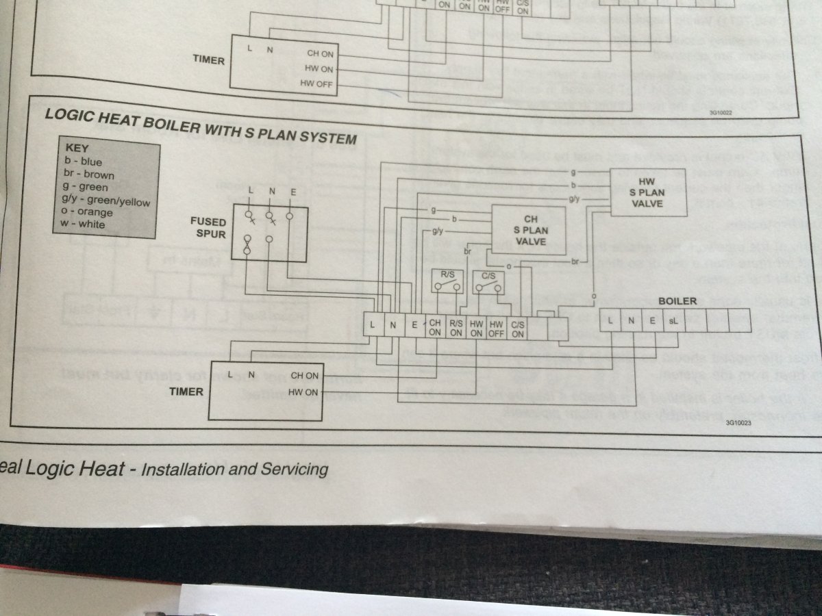

I have included the Honeywell wiring diagram, the wiring diagram I have done of the current installation (trying to keep it as similar to the Honeywell as possible) in an attempt to highlight the differences and the Nest S Plan wiring diagram.
I have traced all the wires in the junction box to the timer, valves, boiler etc and in the main the system is very similar to the Honeywell installation diagram. Where it differs, or where I don't quite understand is the wiring on the hot water system which is slightly different from what I can make out.
I can soon take the timer out of the system and feed the L and N straight into the junction box and onto the Nest Heatlink, I also presume that I can take the existing Honeywell relay out and wire the Nest into the heating valves wiring from the same connections. As I mentioned, where I am strugging is the heating side of things. If anyone can help I would be most appreciative.

Your diagram shows 'fused spur mains' which has the wiring for the cylinder thermostat.
Other than that, the Nest box replaces the timer, the existing thermostat relay is removed and a link installed instead (between 4 and 2).
Nothing else changes.
Many thanks for your quick response, I actually meant to remove that label as I didn't hadn't figured out that wire at the time as it disappeared off with a collection of mains wires, hence my note so I knew what I was marking up. I also didn't include any Earth wires to try and keep the diagram clearer.
So, I'm thinking I remove the timer wires from 4 and 9 in my junction box and remove the relay from 4 and 2 in my junction box and then wire from 4 and 2 to the Heatlink terminals 2 and 3 (does it matter which goes to which?) but what do I wire into 5 and 6 on the Heatlink and from where, can I ask?
Just realised I screwed up in what I wrote. I am struggling with the hot water, not the heating! Sorry about that.
Brilliant. Can't thank you enough. Just to be doubly sure, I just link the live to 2 & 5 as shown as well?
Many thanks to flameport and echo the husky for help. Apart from struggling a little with the tiny wiring terminals in the Heatlink, everything went as suggested and it's all working perfectly. There's some great people on here. Cheers.
