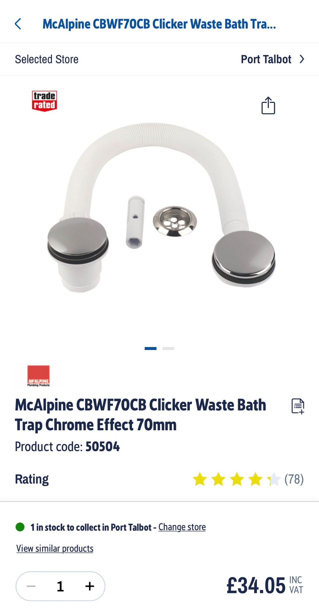

I also have a good quality McAlpine waste/overflow but in the past I've seen the overflow holes on baths differ to the fitting itself.
This is the overflow I have -
Any advice guys?

Bath looks decent enough, the McAlpine waste is also good.

How do I know the McAlpine waste overflow hole fits the bath listed?
I have read with a decent bath and one of the best McAlpine wastes/overflows silicone is not needed.
But in every video they ditch the thin white foam 'seal' and use silicone??

Fitted the mcpine waste and used alight smear of LSX.
Tightened by hand using the supplied plastic part but the bottom part/drain underneath bath was still very loose.
So give a nip up with chisel on the metal flat bit instead of using the supplied plastic'spanner' amd it cross threaded the plastic in it.
I don't think I like them tbh.
So used to cheap ones that at least have a metal thread and u can tighten until there is no movement!
Or am i missing something.
Never using one again.
McAlpine products are generally excellent, better engineered and more solid than cheaper alternatives. Never saw a bad one.
Can't imagine what went wrong in this case; dare I suggest user error?
