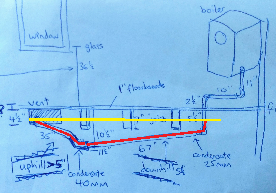

Hi, just had a new Worcester 2000 condensing combi put in my old ground-floor flat replacing an old non-condensing combi. Within a few days I started getting errors up (227, 2951) relating the installer thinks to the condensate. The flue outside was gurgling away and no ignition.
They plumbed the condensate pipe under the floor and outside into the waste pipe (drop of a few feet, couple of meters long), but the drains here are not the best. He said I could try disconnecting pipe from the boiler and blowing down it in case it were air stuck inside due to heavy rain. I wiggled it a bit and could hear water being released down the pipe allowing the boiler to get into ][ 30-minute refill mode. But the next day after a bit went into lockout again. I was worried it might backfill up the pipe toward the boiler.
However looking under the floor myself and feel like he's made an a*** of the pipe out. To get it under the floor joists (7" below the floor) it goes down to about 11" lowest point, but the vent it's going through outside is only max 5" under. So it has to go uphill about 6"? I don't think that's ever going to work by gravity, is it?
Initially he'd tried going through the stone wall straight out but gave up because his bits all broke. I'll be getting him back out to look, but interested in some confirmation of what I'm saying.
I've no knowledge of air-breaks either, but from the installation manual it seems to suggest you want a small pipe into a big pipe outside rather than just straight into the drainpipe? Does that mean just a tight join between them, or a gap for air to escape? https://www.worcester-bosch.co.uk/p...pipe-is-terminated-into-a-rainwater-downspout
I'm guessing that might be different if he gets through the wall instead, as it'll be horizontal into the drainpipe rather than down to the waste pipe as is.

Going up hill does create a problem. It creates a double trap.
An air tight connection into the drains is not good as any air pressure changes in the sewers ( as when a toilet is flushed ) will affect the boiler.
An air break between condensate pipe and drain will prevent pressure changes affecting the boiler but will allow sewer gases to vent

Going "uphill" is not a problem other than the pipe marked red will always be filled with water.
Id say thats a problem...... Its a bloody shabby job..... Op has paid good money he should get them back to correct.
Aha, I see how it could potentially pump out for a while then, but maybe trap air? In the manual it doesn't even want it to run flat however, never mind incline. They had it running fine for a few hours during install, and likewise it was error-free for the next day, but began churning and locking out next morning.

That installation is completely wrong for your boiler will have to be changed immediately, your installer has not read the Manus instructions for that boiler
1. It is a requirement that the condensate drain is installed internally. 2. If external disposal is the only means of condensate discharge, then the CondenseSure siphon or a condensate pump must be installed

Going "uphill" is not a problem other than the pipe marked red will always be filled with water. When the boiler puts more condensate into the pipe then water will over flow out at the far end.
Yes it is a problem. It means the appliance is double trapped and the boiler trap will airlock and the condensate will back up into the boiler

The WB200 has specific requirements for condensate discharge, they must be followed, the rest of the rangecan be installed as normal but the 2000 can not be run outside without a pump, the condensure is a condensate pump made by WB and fits straight onto the boiler, WB will void any warranty if a condensate pump is not used and it has an external run
