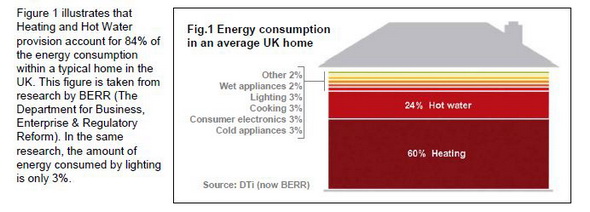

Whatever boiler is chosen it is worthwhile changing the system slightly so that the store is only used for the hot water and the boiler drives the rads separately.
That enables the ( right ) boiler to operate at a lower temperature so that it is most efficient as a condensing boiler is designed to do. At least Ray understands how these stores can be used!
Typically a boiler is only used for 15% of the time to produce hot water during the year. So that saving becomes significant.
Tony
Agile constantly makes these ridiculous sweeping statements , when challenged he crawls back into his shell..
..and so it goes on..
15% FFS..
Rather that broadly disagree with my figures, why not be more helpful and quote your own ( if you have any )?
