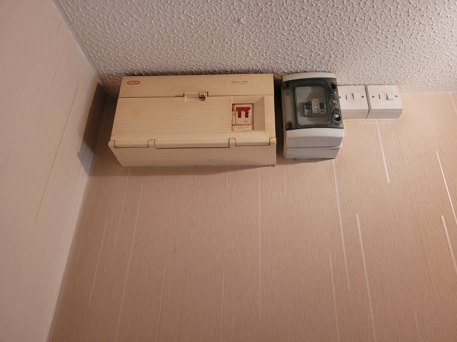

Photo shows existing c u will be having new c u installed problem not enough length on existing supply cables as modern units have longer dimensions to the connection
Can an extension box be installed in yhe loft above don't want all circuit cables extended if possible.
Electrician coming next week for look

Maybe theres a bit of slack to be pulled down, if not they could be extended in the loft.
What makes you think the existing cables will need extending if the CU is starting in the same place
Is that up near the ceiling?

The existing unit looks like it's shorter depth compared to today's units just need to know if necessary to extend cables
The existing wires will probably reach, if they don't let your electrician sort it?
The main power supply cable to the main c u switch may need extending how to do it?
The circuit cables ain't a problem that are top entry and are not effected
