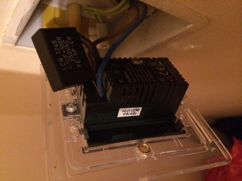

Sorry for the late reply everyone - I've only just got home from work - I spoke to one of my colleagues OH who is an electrician, he feels that it may be due to the minimum load (which on these dimmers is variable due to the vast difference between LEDs) is not being met
I don't have any 'normal' candle bulbs and forgot to pick one up on the way home - he suggested if that if it works then I require a Resistor to help increase the load - I've heard that for GU10 LED issues...
I read on Lightwave's compatibility notes, they don't mention Phillips anywhere so @RF Lighting may be correct in that they're not compatible, in their notes they mentioned the minimum load issue and that 2 resistors may be required
Do any of you feel that could be the case here? Minimum load not being met
I will be buying a full wattage bulb to see the outcome, I will also take up Bernard's suggestion of disconnecting the dimmer & wiring it up to a terminal block

It's not impossible, but I would personally doubt it. Failing to have a load which is at least as large as the minimum for a dimmer is a common reason why lights won't come on, or dimming won't work properly, but it's more difficult to see how that could cause the lights to be on when they are 'switched off'. I'll be interested to hear what others think.
BTW, I would have said that to use resistor(s) to overcome the 'not enough load' problem, if you had it, would not be a very good idea at all (even though it would work). Apart from anything else, you'd have to deal with some very hot resistors (and pay for heating them in your electricity bill). The only real solutions in that situation are to either install higher wattage lamps (to bring load up to the dimmer's minimum) or else replace the dimmer with an appropriate one (with lower 'minimum').

I'm not sure how many times I need to say it, but the dimmer you have only works with incandescent lamps. Faffing about with resistors and or suppressors will never cure this problem.
RF- I appreciate your help and advice, along everyone else's on here as I've already mentioned previously, however I cannot agree with your comment that the dimmers I am using ONLY work with incandescent bulb
Yes there seems to be a compatibility issue with the bulbs I'm using, however LightwaveRF have an entire range of compatible and fully functioning bulbs available, which from what I've read have had positive feedback - my mistake is that I just didn't think that others would NOT be compatible and that newer ones hadn't been tested, therefore that being the reason for them not being on the list.
I believe I will have to purchase some of these compatible ones to obtain the desired result as my main objective reason for switching to LED is to reduce energy bills, I already had an energy saving bulb fitted prior which worked absolutely fine with the dimmer, so then to go back to incandescent & increase the power usage more than previously just wouldn't make sense at all
It appears to be a Siemens dimmer and hence the data about LightWave dimmers may not be applicable.

The Siemans dimmers are physically produced the same as the LightwaveRF dimmers. Siemans were the manufacturers initially - and they did produce quite a few - and from what I know LightwaveRF received enough funding to control manufacturing and costs better and thus produced the same dimmer under their own brand name. Apart from the branding and packaging, they are essentially the same product internally.

As you've probably realised, there is a potential catch here. If you got a higher wattage conventional (incandescent) bulb/lamp in order to test the 'minimum load' theory and it cured the problem, you wouldn't know for sure that this had resulted from increasing the load, or by reverting to incandescents (rather than LED). If it is applicable, the LightWave information posted by BAS appears to indicate that, provided the LED is dimmable (I presume you are sure of that?), the dimmer should work with LED loads as low as 1W.

However i did go and purchase an incandescent bulb (28w) and not to my surprise it solved the issue surprise surprise (!!)
It's clearly the incompatibility of the Phillips LED bulbs and the LightwaveRF dimmers. My only choice now is to do fork out another £30/£40 on LightwaveRF approved LEDs and see if that works. If it does not I'll be hanging myself from the new light fitting.

Fair enough - but, as I said, that could be due to the increased load (wattage) or the fact that it was incandescent, rather than LED (or, as you go on to say, "the wrong LED").

Now the 'approved' lamps are 7w each, multiplied by the number of fittings I have (3) gives an apparent load of 21w. My Phillips only totalled to 18w. I read somewhere you need 20w minimum so we'll see with the new ones.
I would purchase one but they're only available online so would pay for P&P twice.
Exactly. It could be one if either and as I said before it's probably both. Now the 'approved' lamps are 7w each, multiplied by the number of fittings I have (3) gives an apparent load of 21w. My Phillips only totalled to 18w. I read somewhere you need 20w minimum so we'll see with the new ones.
The minimum varies between makes and models of dimmers but, as I said, the thing that is confusing/worrying me is that the LightwaveRF material BAS posted (if that is applicable to what you've got) indicated that the minimum power for dimmable LEDs is only 1 watt.
