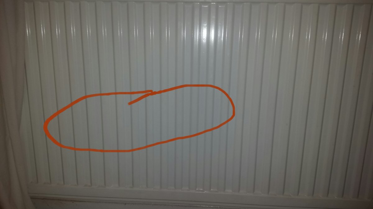

New CH boiler Gurgle and air created at 3 port valvr
I have seen orifice plate ( washer ) fitted in the return pipe connection at the boiler. This can help reduce noise ( cavitation. )
Have a look at your instillation information and check if it say it can/should be fitted, given your problem it's worth checking.
Thanks Pete, I will have a look. Although, the massive gurgle seems to originate around the 3 port valve travelling through the flow to the radiators...through them all ( incl downstairs ) ....can't hear it coming back to the return..plus any air that s left the autovent seems to let out...

When you say boiler stat, do you mean flow temperature ? It s now set at 60, so is the HW to avoid it switching off. REASON why it took so long to identify what it is was that boiler flow temp was set to 73 deg celcius and HW to 50. The HW was still heated by immersion heater on economy 7 at night
So, CH and HW on and then the gurgle randomly appeared after 1 HR..or 2 or 3 when HW reached temperature...
Massive gurgle to be heard downstairs travelleling through.
By putting both on nearly same temperature that doesn't happen anymore , apart from startup....and finish if on timer
If I switch of manually, I do CH first and then HW and all is well ....

I had a lot of gurgling in my system. One old radiator had blockages somewhere in the middle. When bleeding, a jet of water came out as if it were OK. I hit the radiator all over with a rubber mallet and was then able to release the air via the bleed valve. My Magnaclean picked up a load of magnetite from this!
I still have some rushing sounds and slight gurgles at start up and shut down, but most of the noise has gone. There is probably air trapped similarly in other radiators, compressing at start up and releasing pressure at shut down.

The only thing the valve is doing is adjusting the flow of water. Through the cylinder coil is a short path of low resistance. That through the radiators is far longer and has far more resistance to flow, probably due to partial blockage. The fact that the boiler overheats with the pump set to speed 1 further supports that. The blockage could be trapped air, or solid materials.
When the valve moves to radiators only, the pressure behind the pump falls significantly due to the increased flow resistance ahead of it, and is either pulling air in via the AAV / some other source (does this boiler have an air vent inside?), or causes cavitation.

...just another question please how does one identify where the potential blockage is ?
Like I said CH with HW all is quiet, all radiators are as warm as they should be and all is happy ....so, where on earth do I start ? Process of elimination ? If yes, how ?

As to the radiator, one of them has got a patch pretty much randomly in the middle that is much colder than the rest of it
PHOTO attached .
