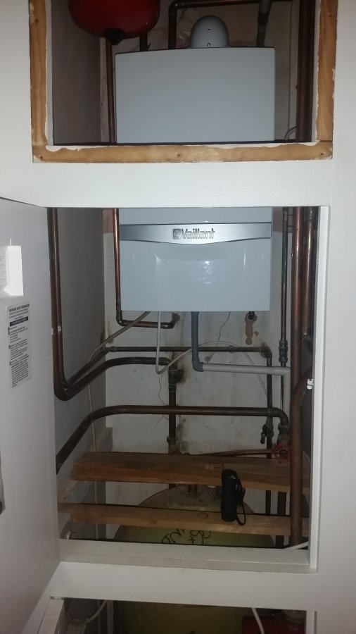

Pictures of the cylinder, pipework, valve, etc. may be helpful.

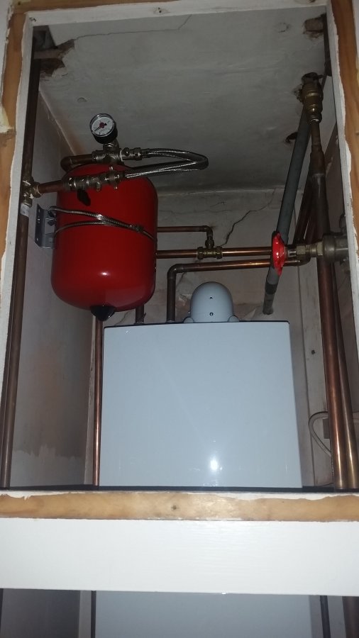

New boiler installed 3 months ago, sealed 2 months ago via expansion tank.Problem started as soon as it was running with new boiler, but it took us ages to now narrow it down. I will post more pictures when I get home .I also got video but not too sure if I can upload

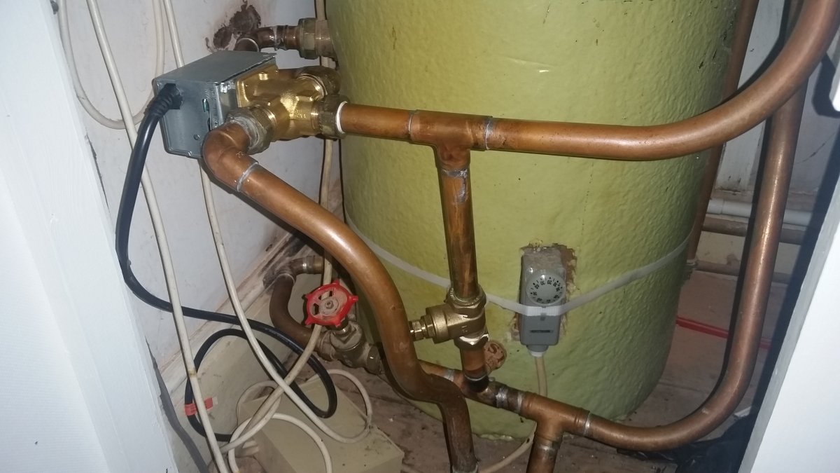

After looking at the picture Id suggest that airs being caught around the mid valve. If that was my job id have fitted one an auto air vent on either the a or b ports. I know its being fed from above via the pump id still have done that anyway.

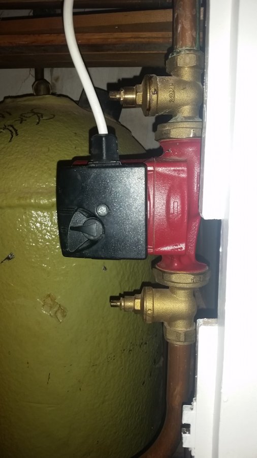

God help the person who has to change the 3 port valve head at sometime in the future. Try running the pump on speed 1, and turn down the boiler thermostat. Do you have TRV's? If so, make sure all are open and see if that makes a difference,

Boiler flow temperature is down to 63 degree. Tried pump on 1, but boiler then sends error message and shuts itself off too hot.

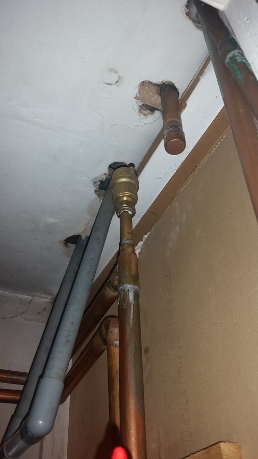

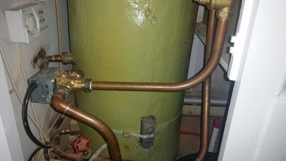

First (large) picture red head valve at bottom on cylinder return - have it almost shut and see what happens. Next to last picture of pipes and ceiling - auto air vent up high - has the little black cap been loosned?
Hi Nige, Black cap has been loosened , thank you very much.
If return gets closed and water runs solely through the CH that s when it goes loopies.
Same when 3 port valve shuts HW off because desired temperature is reached.
Plumber tried a system bypass between flow and return put with manual valve in case didn't work so we could close.
Well, it failed because the return was then so warm that the boiler didn't think it needed to heat anymore. If manually slowly opened at the start/ shutdown it avoids the gurgle but it then needs to be closed.If left partially open it itself creates that massive gurgle and air , so it is now shut. Potentially automatic bypass valve may be tried but fear is, it may cause the same symptoms.
It appears that somehow the flow / speed of the water hitting the 3 port valve is creating all this.

Auto air vent both sides of the 3 way valve ( belt and braces) and turn the valve so the box is @ the top while you're at it ( not technically necessary but makes changing head easier )(y)
