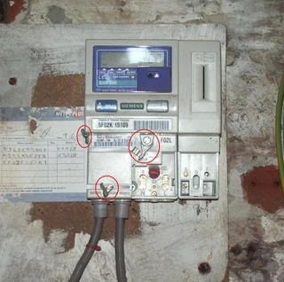

Well seeing as how its quiet on here tonight I thought I'd share with you the CU I installed for a customer today.
Before (Temporary builders supply)
During
Getting there
Almost
Done!
Very nice work. Is that an MK socket you used to terminate the meter tails onto?

The socket is an MK old logic range fed with 10mm² tails. :oops:
The property is a victorian mid terrace house in Bradford.
It has been gutted and fully refurbed. (it desperatly needed it)
Were the DNO involved... the tails seem to change from pic to pic? or looking at it, does that meter have a removeable out-going terminals cover?
Also the meter seems to have moved onto a new board
The meter has a seperate cover for the outgoing side of the meter, with contractors isolator switch.
The board the meter was fixed to was rotten chipboard and disintegrated, so I was left with little choice. No seals were removed in the process.
And the service fuse didn't just fall off the wall too? Its board looks in a similar condition (and being lower should be in a worse condition). Give it a bash and call YEDL to report an unsafe installation :wink: :lol:
The head was on a board of 'proper' wood. The screws had rusted away, but 4 stainless steel 3" screws soon cured that.
Still sealed :wink:
Very pretty, but I noticed that the numbering of the earth conductors doesn't correspond with those of the neutral conductors! (Naughty boy :wink: ) Won't look good when it comes to testing!
I can't help it if MK can't design their boards properly.
The fist six earth terminals correspond properly, as do the second set of six.
Why would you provide 16 earth terminals on a 12 way board?
Only pulling your leg! That's split-loads for you. And it keeps the prices down! :D
Rob, tut tut, norty boy!
Do I detect the sheath of twin & earths not quite reaching the inside of the board?
