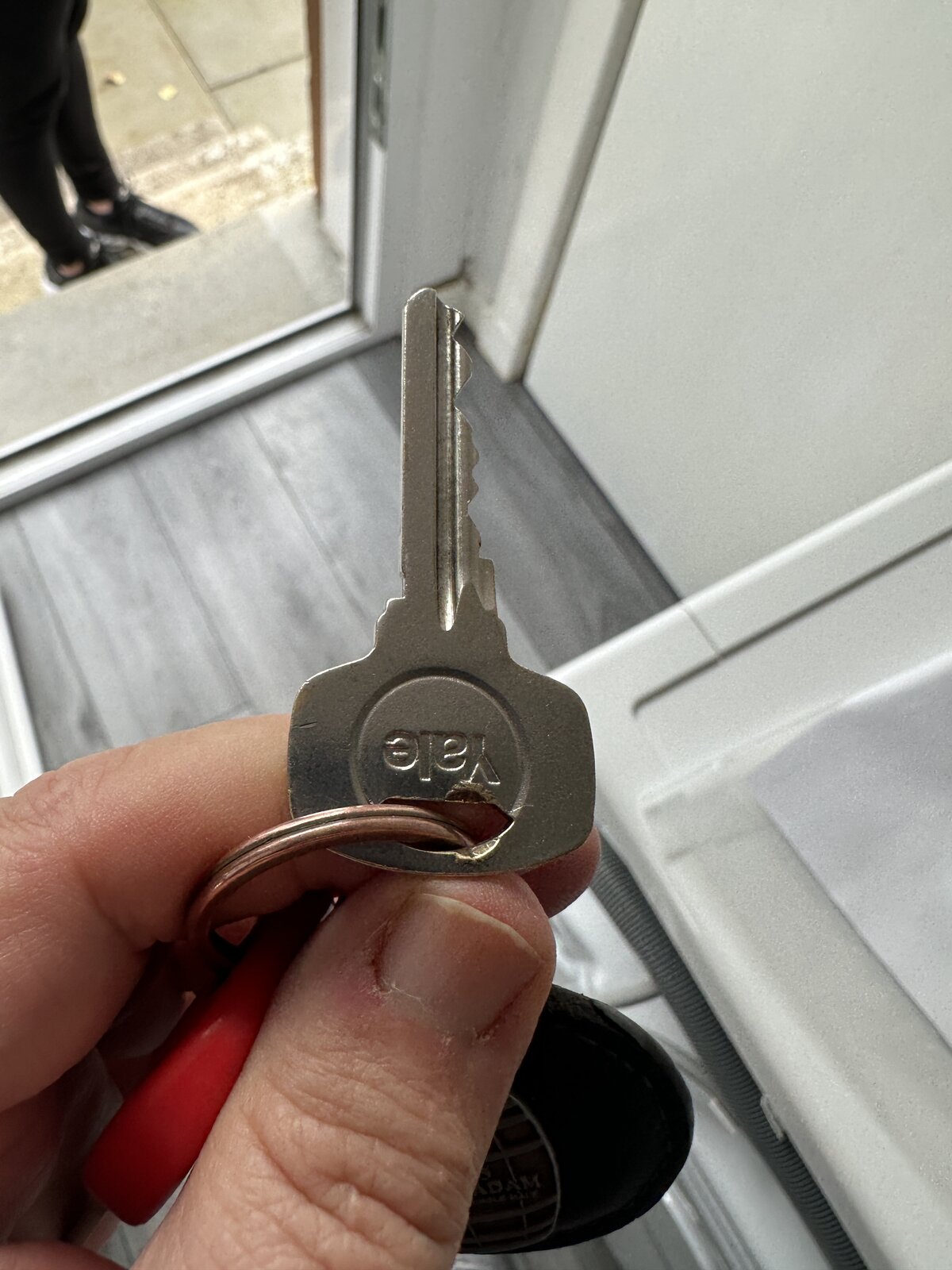

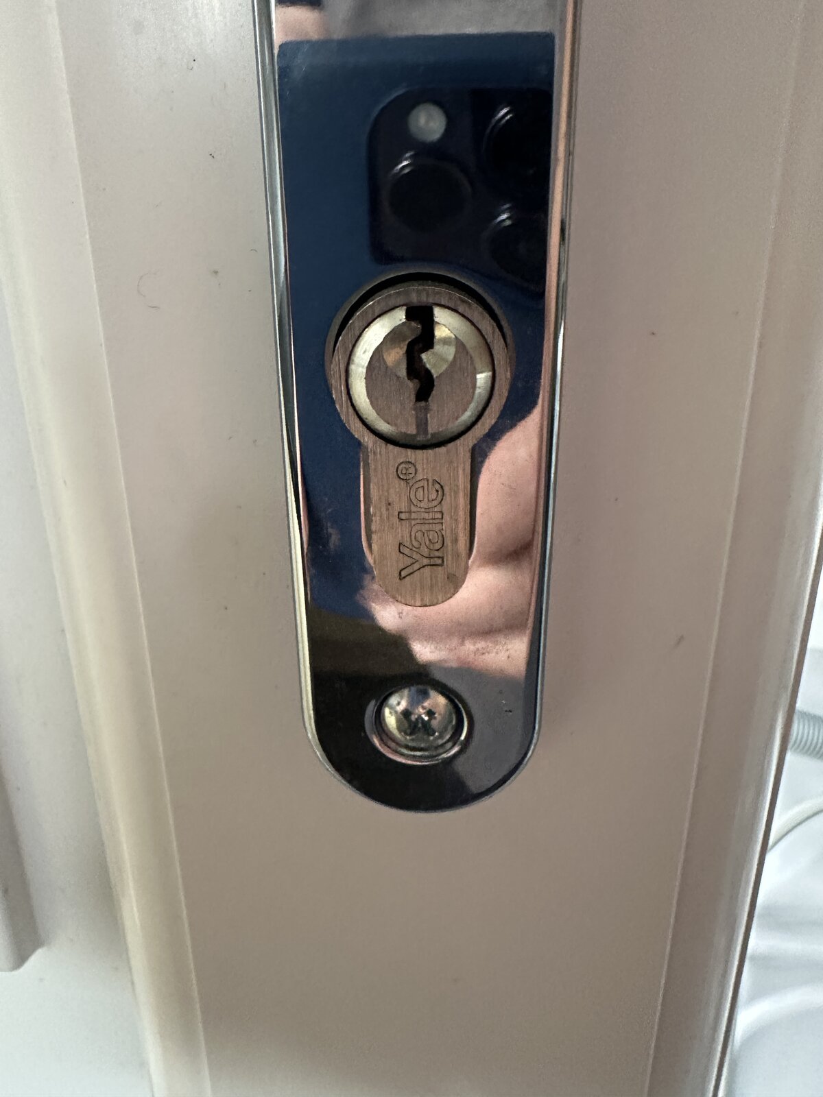

Hi my daughter has just moved and looking to replace the 2 doors cylinders, can I ask how do I measure replacements

I believe that you just measure the length of the cylinder. To remove them, take out the single screw that holds it in place (from the door edge). Put the key in an twist it slightly, that will let the locking lug move to the downward position and enable you to remove the cylinder. You don't need to remove anything else.
The lock type is a euro-cylinder.
eg https://www.screwfix.com/p/union-6-pin-euro-cylinder-lock-45-55-100mm-satin-nickel/5371g
The above is just intended as a guide and not a product recommendation.

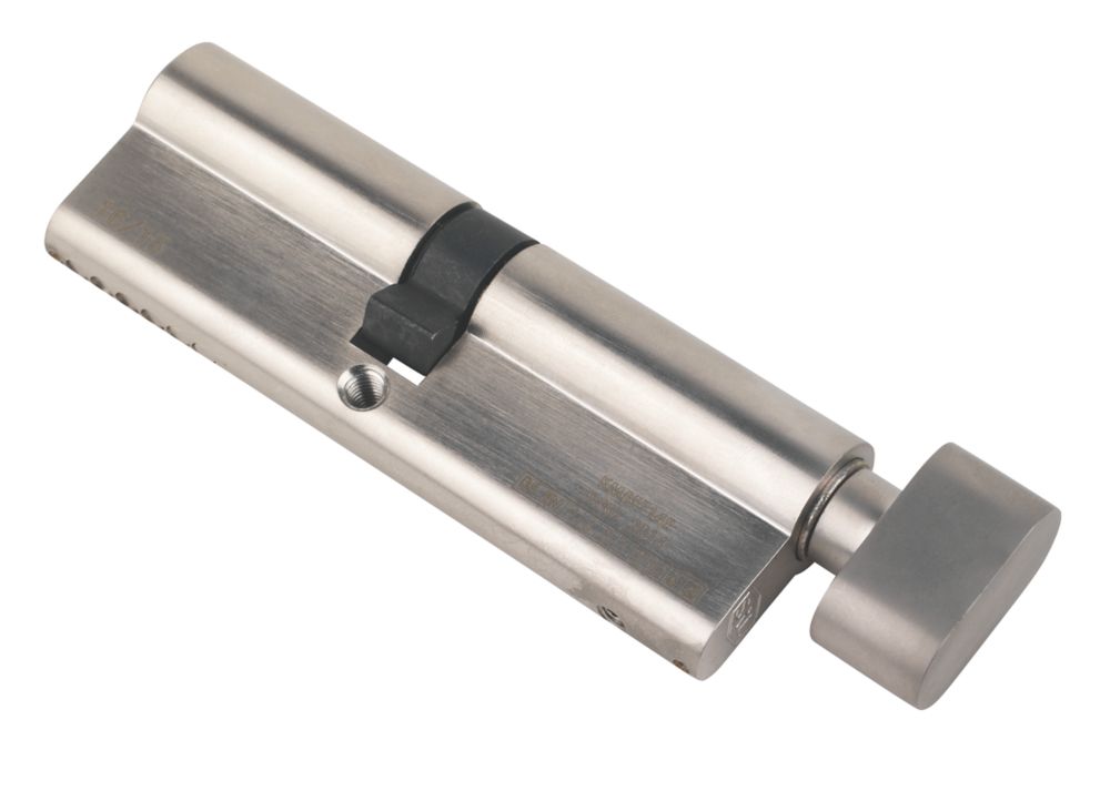

If it is a front door, does the inside have a thumb turn?
Again, just a link, measure yours first.
Thanks will go down tomorrow and measure it, don’t think it has the thumb wheel on the front door, although the back is key inside. Can I ask if I have to renew them any point in changing the inside from key to thumb wheel?
The thumbturn means it can be opened from the inside without a key
Useful in an emergency such as a fire

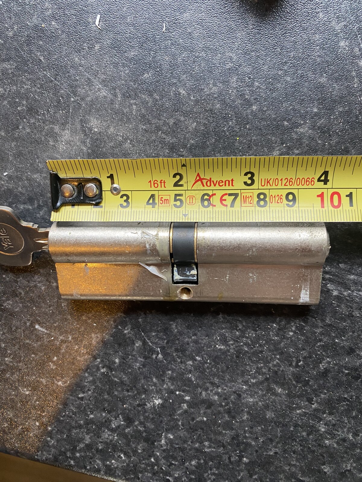

Sorry can I ask is this a 50-50 or a 45-45 ?

You measure to the centre of the screw so it looks like a 50-50 as listed at Screwfix as "50-50 (100mm)"
But if the end of the old cylinder poked out of the door, try to get a shorter one that will be flush with the escutcheon on the outside
(You sometimes see the 10mm central cam measured separately, then it would be a 45 -10-45)
