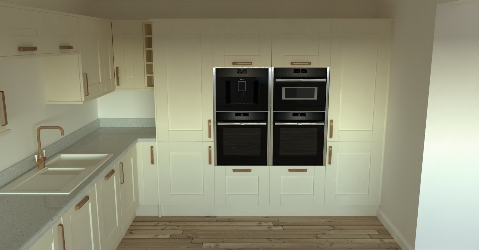

Hi All
Looking for some advice on first fix wiring for our extension, before connecting ang getting certification on completion.
Our new kitchen will have a bank of appliance...
2x single oven, 3.2kw/230-240v/manufacture required fuse 16
1x Combi microwave, 3.0kw/220-240v/manufacture required fuse 16
1x coffee machine, 240volt
The consumer unit is approx 5meters from the appliances.
Could anyone help by advising
- how many circuits (should the ovens go on separate mcbs, or one that is split),
- mcb rating
- cable thickness consumer-cooker switch
Any help would be great so that I can put the correct first fix in before getting a qualified electrician
Neil

The 2 ovens and microwave can all go on a 32a MCB fed by 4 or 6mm cable. You will NEVER have full load on all of them at once. The coffee machine can be plugged into a 13 a socket on the kitchen ring.
How do you comply with the manufacturers requirement of a 16A supply when putting in a 32A supply?
If you wanted to comply you could fit a 3 way consumer unit in the kitchen cupboard above the oven.
Personally I wouldn’t and would fit 3 dual pole isolators in the cupboard
The 16A supply would presumably be a minimum requirement for effective operation, but more likely is just the usual circuit to which it would be connected in Europe, and merely a translation, and not really related to the requirements of the appliance.
Do I take it that you do not apply diversity to cooking appliances where it would contradict the manufacturer's stated amperage or wattage?
