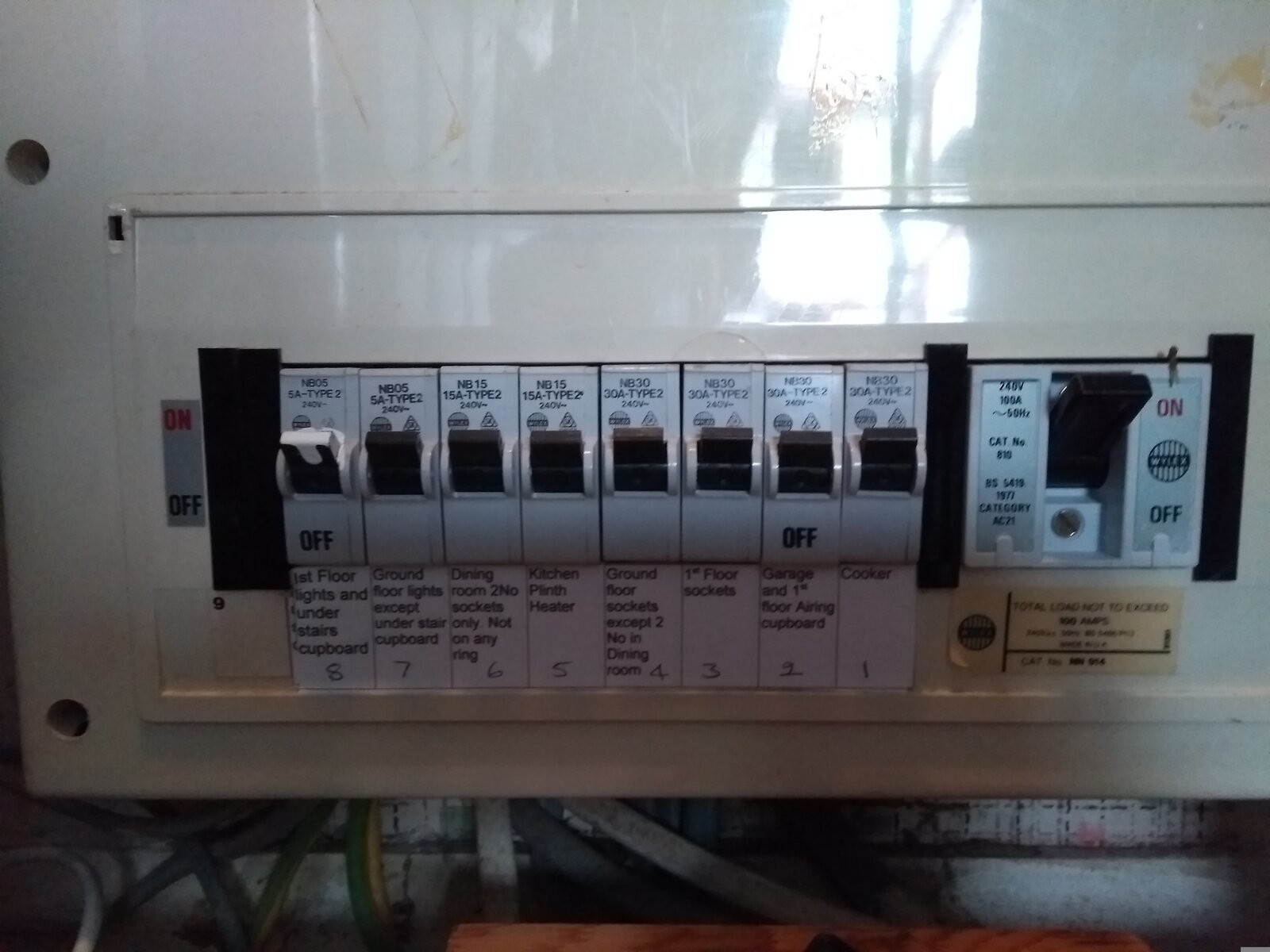

Hi
I'm having a new Kitchen fitted in a few weeks with all new appliances. My current unit is as photo.
Am I right in saying that if a new connection or any work needs to be done I must have a new unit fitted with an RCD, but if everything can be run off the existing fuses there's no need to change anything?
You may advise a new unit anyway but as the electrician won't come until the old kitchen has been stripped out I don't want to be bounced into making a decision with everyone waiting to get on with the job.
If you don't make any alterations to any circuits, and don't have any new circuits installed, and keep everything exactly as it is now, then in theory you can keep that 30+ year old obsolete consumer unit for as long as you like.
More realistically it's a couple of decades overdue for replacement, new kitchen or not.

BS7671 does not give a whole lot of guidance on to what extent existing installations must be upgraded when carrying out alteration works. However afaik most electricians start from the principle that new work should be to current regs. Some electricians are likely to be stricter about this than others.
The problem is the regs don't say consumer units must have RCDs, they say that sockets rated at 32A or less, domestic lighting circuits and most concealed cables must be RCD protected. That means if there is no RCD protection in the consumer unit then it's NOT the consumer unit per-se that is non-compliant but the stuff fed from it. In other words if the electrician doesn't take steps to add RCD protection then any additions or alterations made will not comply with current regs.
I'm pretty sure that CU is from an obsolete range that is not compatible with current products. So modifying it without replacing it (or at least replacing everything inside it, but at that point you may as well replace the whole CU) is problematic.
There are certainly ways that RCD protection could be added without replacing the CU
* A RCD in a seperate enclosure could be added "upfront" in the feed to the CU, the problem with doing this is that it leaves the whole house on one RCD, which is not ideal from a nuisance tripping point of view.
* RCDs in seperate enclosures could be added in a "downstream" on the circuits that will be modified. This would work, but it gets messy the more circuits are involved.
* A second smaller CU could be installed and the relevant circuits moved to it (but nearly half your circuits are feeding stuff in the kitchen, do you want to do half a job?)
But ultimately replacing the CU is generally the sensible option.

@plugwash has given a very good reply, when mothers kitchen was altered when she became disabled there was a problem with the house electrics, the house needed rewiring, but dad put his foot down and said I am not living in a building site, you can rewire it when I'm gone, so needed to find a way around the problem.
The method used was a steel wire armoured cable fed from a large MCB in the original consumer unit and a second consumer unit in the kitchen which just powered the kitchen.
There is always a way to do it, but not always what we really want, in mothers case there was no option but to fit a new kitchen as work services too high for wheel chair use, but had she not lost her leg, then the rewire would have come first.
