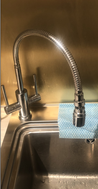

    Post a picture of the tap.

    That's a high pressure tap.

    Would you be able to send me link of taps which are suitable please?
    If the problem is the tap, how do i find a similar one which accommodate 0.3bars?

    Turn off supplies, disconnect flexi's from rigid pipework, I'd then fashion a shower hose or something to the open end of the hot supply then turn supply back on, check that runs clear and flow/pressure is as expected. Remove flexi from tap body, blow/look through it to ensure clear, reassemble, restore supplies. Check operation and for any leaks. If pipework is clear and situation doesn't improve, then probably new tap time.

    There are quite a few low pressure mixer kitchen taps around,
    Did you purchase that tap, do you still have the specification for it, so you can see what the MIN/MAX pressure is
    0.1 / 0.5bar is lowish pressure - whereas a lot of those flexible taps need a high pressure.
    for example, this is MIN 1bar (OUR mains pressure is around 1.5 , so this is quite high pressure , so i would look for 0.1/0.3 which we used all over the house, although the 0.5 worked OK for us, reduced flow
    https://www.toolstation.com/waddesdon-pull-out-mono-mixer-kitchen-tap/p56086
    Others can be as low as 0.1bar
    have a search for low pressure kitchen mixer taps, huge choice and price range , then look at the specification and MIN pressure - BAR , maybe 0.1/0.3 ish - can always post back here
    BUT as stated it maybe a block, EVEN looking at the PTFE , maybe some covering the pipe hole itself & reducing flow.
    as mentioned/asked before - FLAT , House How high is the TANK from the TAP
