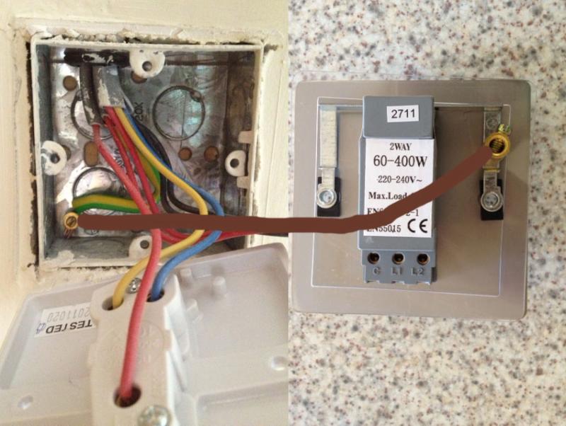

I was thinking of switches like these (not my photo), whereby a metal faceplate presents a danger from a loose live wire. I wrongly thought the faceplate was earthed by the metal strip as seen in this photo, but as you say there's no earth terminal so it wouldn't work. I will be running a correctly-sleeve earth wire to the metal backbox as I've done on switches I've replaced over the years.

I was thinking of switches like these (not my photo), whereby a metal faceplate presents a danger from a loose live wire. I thought the faceplate was earthed by the metal strip as seen in this photo.

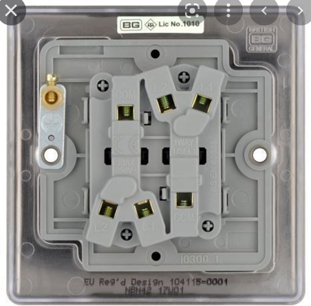

Well, not really. The faceplate is earthed by the earth wire.
I cannot see the point of that metal bar.
Is that a plastic faceplate?
This is the more usual arrangement for metal faceplates:

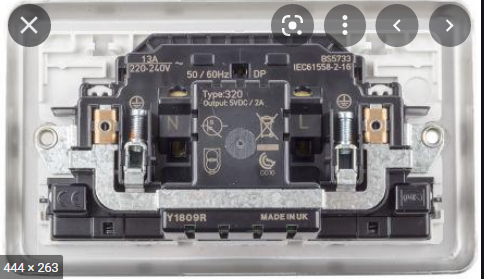

as opposed to a socket:
I won't be relying on that for an earth though, and will run a correctly-sleeve earth wire to the metal backbox as I've done on switches I've replaced over the years.
How could you rely on that if it were not connected to an earth wire?

Absolutely. I'd probably remembered the bar being connected directly to the faceplate, though. If that was the case then that would be a way of earthing it would it not?
Yes, but the point is the socket needs the earth (wire) so that the plug can connect it to the appliance, it is then connected to the faceplate by the bar for your protection.
A switch does not need an earth (wire) but one is necessary to protect people so is connected directly to the faceplate.
