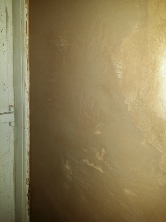

Ive taken some photos.
You can see the were the render scratches through the multi finish is this because the plaster is still wet and once it dries you wont see them? Its the lines where he's
used a render scarifier?
You often see the lines grinning through , feel them if they are they flat? You are only supposed to give a light key not go to deep, I hope you haven't paid him yet look at your skirting line its terrible and the walls have great big fat stains on them
Im having new skirting 7" so should cover that. The marks are water marking i suppose from when he was trowelling the plaster smooth.

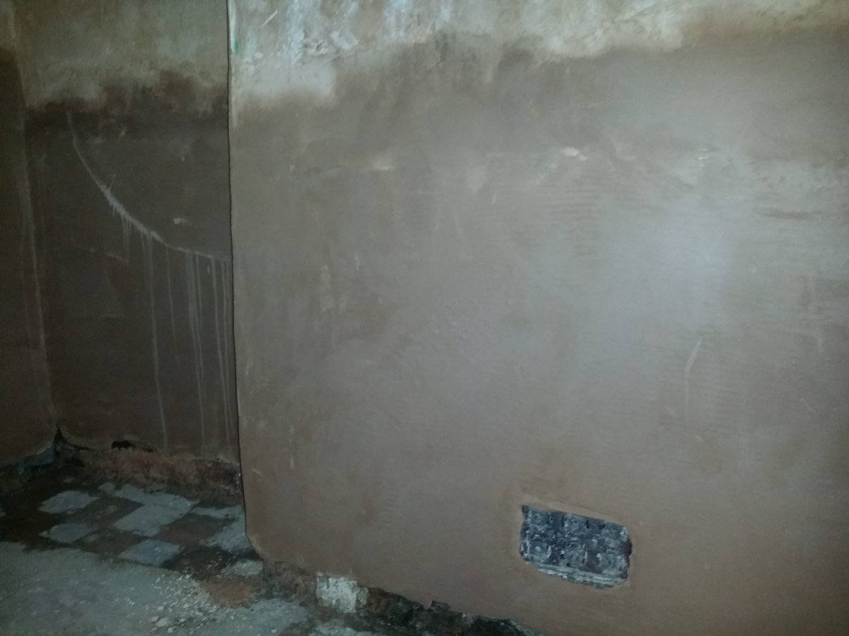

Watery fat stains dripping down the wall have you measured the distance for skirting? Should have got it tighter than that a good spread with have cut it in a straight line about 2 in from floor
It is what it is Steve you pay peanuts you get monkeys!! Obviously he got a monkey!!!!
Ive paid good money for this hes not cheap. Yes hes left around 4-5 inches from the floor and skirting is 7inch so should be all good. Ive tried putting a piece of skirting against the wall and looks flat against the wall.
There's going to be hardly any backing for the skirting to sit against making it awkward Adam I feel for you mate you have already paid out good money once and now you have again and tbh its not great you can see from the corner angle its not straight , its not very nice for us here at diynot either to see this sort of thing, you can see not much effort has been put into your job the bottoms are awful and the sloppy fat that's not been troweled off, corners not straight ect we say it as it is here at diynot we've seen it all from really bad jobs and some good jobs sadly yours falls into the 1st category
