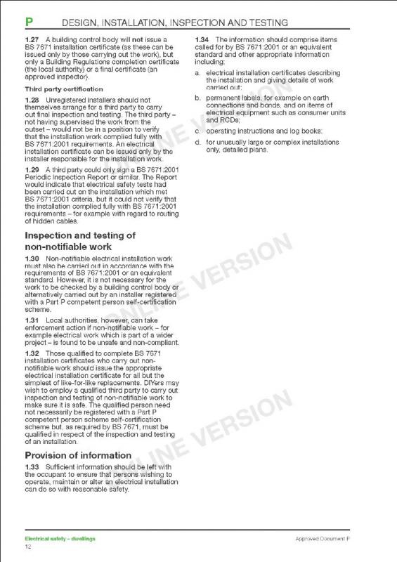

APPROVED DOCUMENT P The Building Regulations 2000
Page 10 Paragraph 1.9
Page 12 Paragraph 1.32
oh and page 22 of The Electricians guide to the Building Regulations under the heading
Additional notes from Approved Document P
Non notifiable
Those documents are only guidance tho :cry:
The law is as BAS states - the law doesn't say like for like, it says " (b) replacing a damaged cable for a single circuit only"
