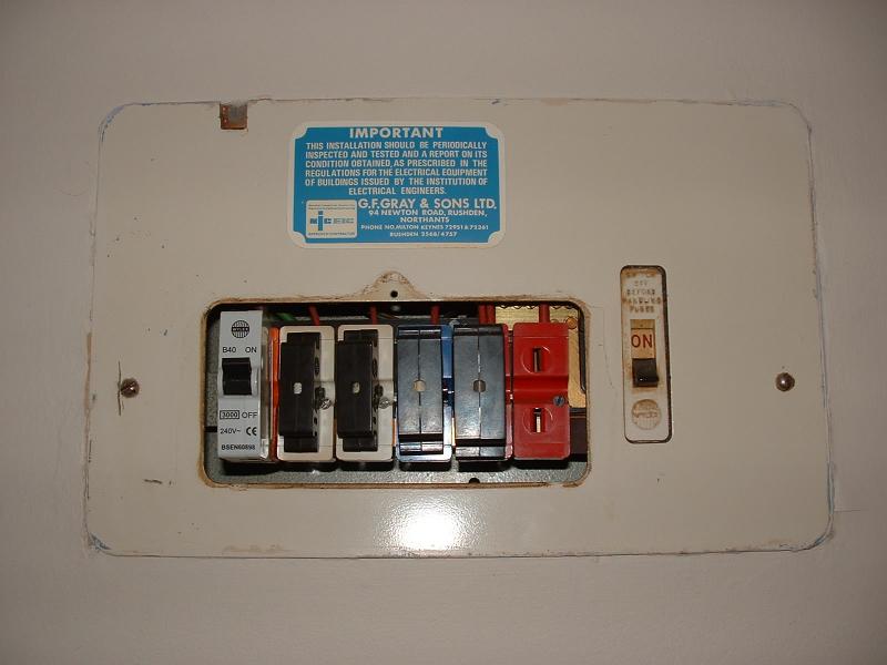

Our fuse board cover has been cut so that an MCB can be fitted. The MCB says WYLEX B40 on it.
The pull cord switch hasn't been replaced.
Is the MCB good enough or is an RCD required also?
I'm still concerned that our CU might not cope with the high current draw from the shower. Where before the fuse was protecting it a little, a 40A breaker is going to give less protection isn't it?
If you had a 30A overcurrent device before and now have a 40A overcurrent device then as you stated you have a high current needed to trip the 'MCB'. It's a push in unit which are sometimes used instead of fuses but is not a proper din rail mounted unit (not possible in your fusebox).
You say the fuseboard has been cut? Is that picture how it currently looks? If so then it is unacceptable to leave it in that condition. Exposed conductive parts are on show with no protection. As stated you have no RCD protection, which will most likely be a requirement of the MI for the shower and is a requirement of all new circuits in bathrooms.
If I were you i'd be turning the shower off and not using it until you've had a competent spark round to check out the work that has been carried out. It would also be a good time to get the fuseboard updated! Many of the older style fuseboards are not built to take more than a 30A fuse - I don't know enough about this particular board to say if this is the case here. I'll bow down to the experts on the site as I am not a spark myself. :lol:
OOI have you had a look in the shower pull switch? It may be the 'fishy' smell is coming from there - i'd still get somone round to check the installation though...
To clarify, the fusebox has a cover which screws on top of what you see in that photo. Because the MCB is bulkier the cover has had to have a rectangle cut out of it to let the MCB fit. If that makes sense.
It does - if i'd looked closer I would have seen that. :oops: However, cutting the corner out of the fuse cover to get it back on is poor workmanship.

Ideally you would have the CU replaced with a new one containing RCDs & MCBs or RCBO (both functions combined in one unit). If this isn't an option then the best idea would be to use Henley blocks to split the main tails then have a separate mini CU just for the shower (with a 40A MCB/30mA RCD). This would avoid the existing fuseways being overloaded. But you would also have to install an isolator after the meter and before the tail split to comply with existing regs and allow you isolate the entire system at one point (it would be more prudent to have the new CU, IMO).
