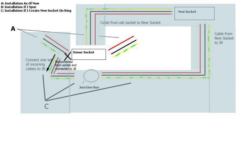

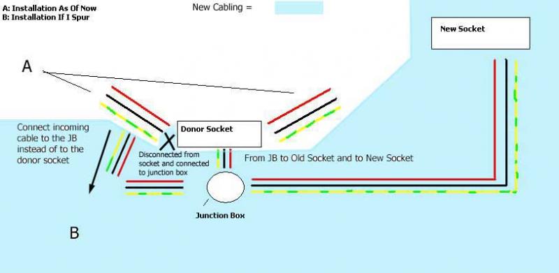

I've been reading a bit and having failed to entice the electrician round today, I thought I might give this a shot myself.
I've concluded it is a ring main as I've tested by removing a socket from the wall. It had two sets of wires going into it. I removed and tested it with the multimeter saying there was no resistance.
What I was thinking of doing was to either 1) create a spur from a donor socket nearby that has 2 sets of wires (so this should be ok to spur from?) or 2) create a new socket in the ring by disconnecting one set of wires from the donor socket and have them connected to the second set of wires that will be connected to the new socket.
First off, is 2 feasible and the correct way of going about doing that? Is it preferable to just creating a spur (why create extra work for myself etc)?
Further, I was going to use a junction box, which would be located approximately two inches below the donor socket within a plasterboard wall, and screwed to the baton. It will still be accessible once the donor socket backbox is removed (it can be unscrewed and lifted outwards of the socket hole and worked on there).
I was going to use it for creating either the spur or the new socket on the ring. In the case of the spur it would house one connection from the donor coming in, with two connections coming out: 1 to the spur one to the donor. In the case of the new socket on ring it would house the return from the new socket and the old wire that was removed from the donor (i.e. it would just act as a connector between them).
The reason I preferred the junction box is that the wires are quite thick and it seems tricky to get all three in without them coming loose or breaking, and the backbox seems pretty cosy as it is!
No resistance between which points?
Not necessarily - with a ring final circuit there's no guarantee that a socket with 2 cables isn't a spur with another spur from it.
Don't forget you then need to connect the new socket back to the one from which you removed the cable.
It's preferable to maintain the ring.
And it's preferable to avoid joining cables if you can.
Can't get my head round that - maybe it's just late...
Ah. I was under the impression that if the continuity test confirmed the socket (donor) was part of a ring, it could not be a spur? How can I test if the donor socket is really a spur (with a spur attached, which I thought was a no no).
Thats what I refer to when I mention the junction box acting as simply the connector between the wiring back from the new ring socket and connecting to the wire removed from the donor socket.
Great, thanks. Would it be too much to ask the reason why? I understand if you think it would be way over my head/too much to explain on here! Edit:ignore that, I sort of understand the reason why. Something to do with the wires being able to be thinner due to the load being split. One question though, simply out of interest: what is the difference between single phase and three phase circuits?
Ok cool. However, how can I then connect the return wire from the new socket to the removed wire from the donor socket?
lol. I'm sure my explanation is probably crap. What I meant is probably best described by a diagram, but in short, the junction box would act as either connector (as explained above) or as splice (is that the correct term) for the spur.

Ok. Got some images up. Have checked them for accuracy and they seem ok. But, as you've mentioned, it's kinda late!
First image is here:
This represents the changes if I spur.
Second image is here:
This represents the changes if I create a new socket.
I hope they make sense.[/img]
