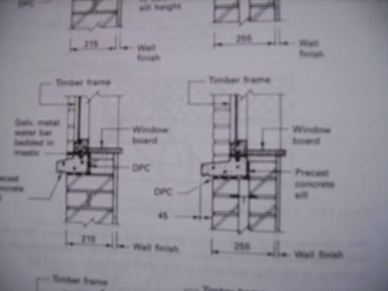

apologies for rambling....... 2 questions i have are: are 2 concrete lintels enough support for a window opening of approx 2ft?
What is the best ways of making good regarding a DPC for this kind of wall (9"no cavity brick)
thanks in advance :(

I am intending on installing a " new" stone sil to keep in the appearance of the property. would this need a dpc above or below??

its a upvc unit thats going in, would anything need to go in above the lintel too?
As it's a solid wall you don't put in a tray, but you can get a solid wall catnic lintel which will show all brickwork on the outside.
