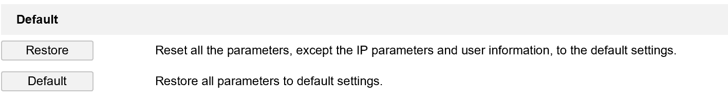

if you can log into the camera you can default it in the maintenance menu, but you could try the camera on a POE switch or a different channel. It does sound like something has gone or a setting hasnt reset.
if you default the camera successfully then it should reset completly.

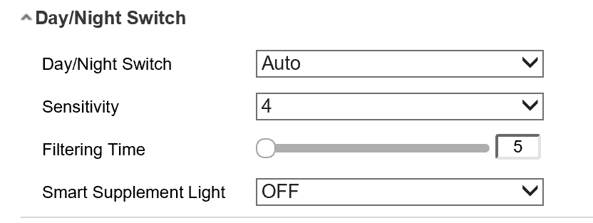

Even if the factory settings hasn't fixed it, just take a moment looking into the camera settings where you'll find the Day/Night setting. Just make sure it hasn't latched up at the Day setting, which means the infra-red is switched off. It should be set to Auto.

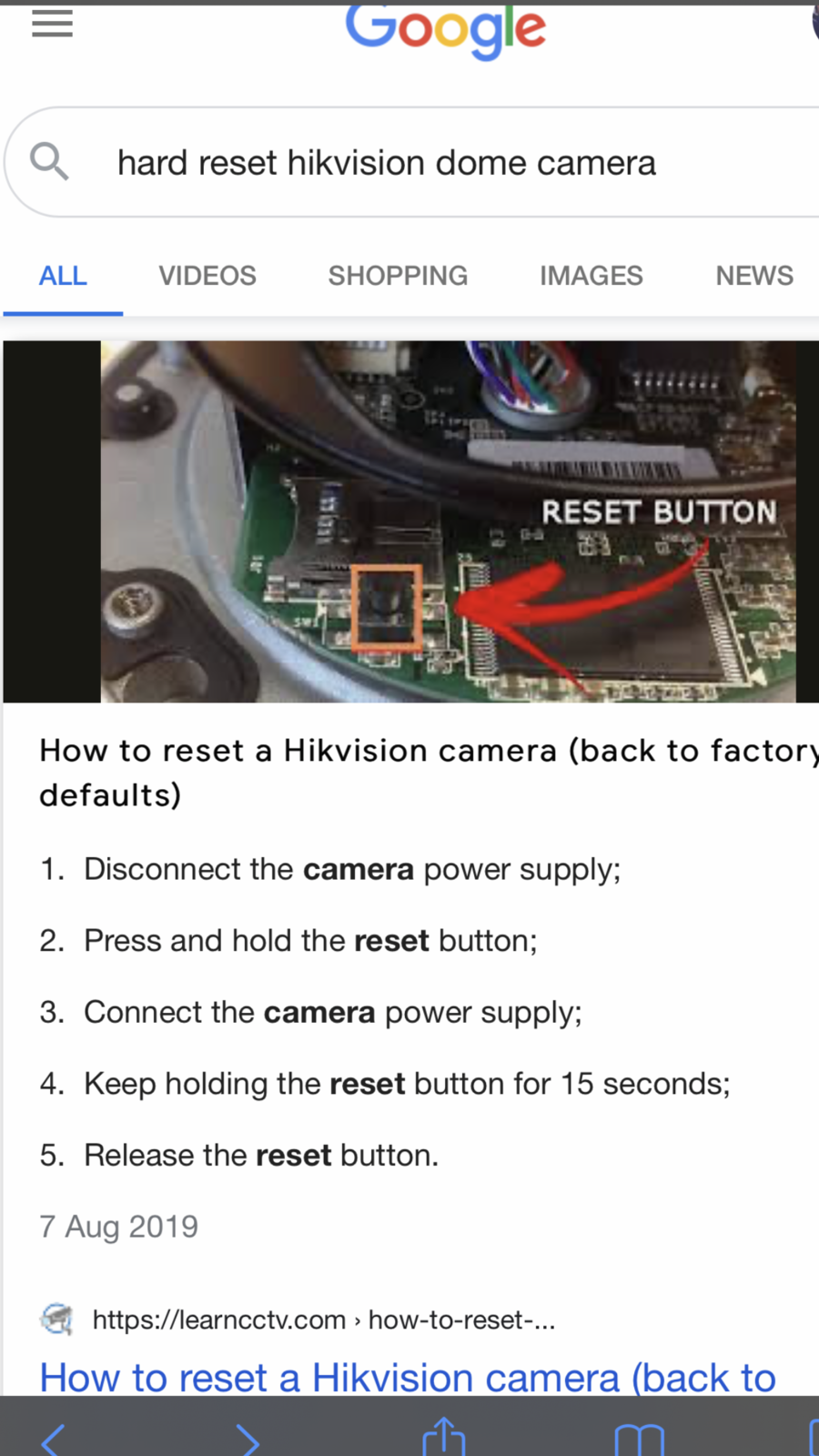

I think my previous attempts of holding down the reset button inside the dome hadn't worked as the camera name never defaulted back to "camera1". I have now tried both of these options:
On each occasion, the camera rebooted and the name defaulted to "camera1". Unfortunately, the night vision is still not working.
This is set as follows by default:
This is not enabling the infrared lights. even if I set this to "night", it isn't having any affect.

I have since come across this:
This hasn’t made a difference too. I welcome any suggestions that you may have.
