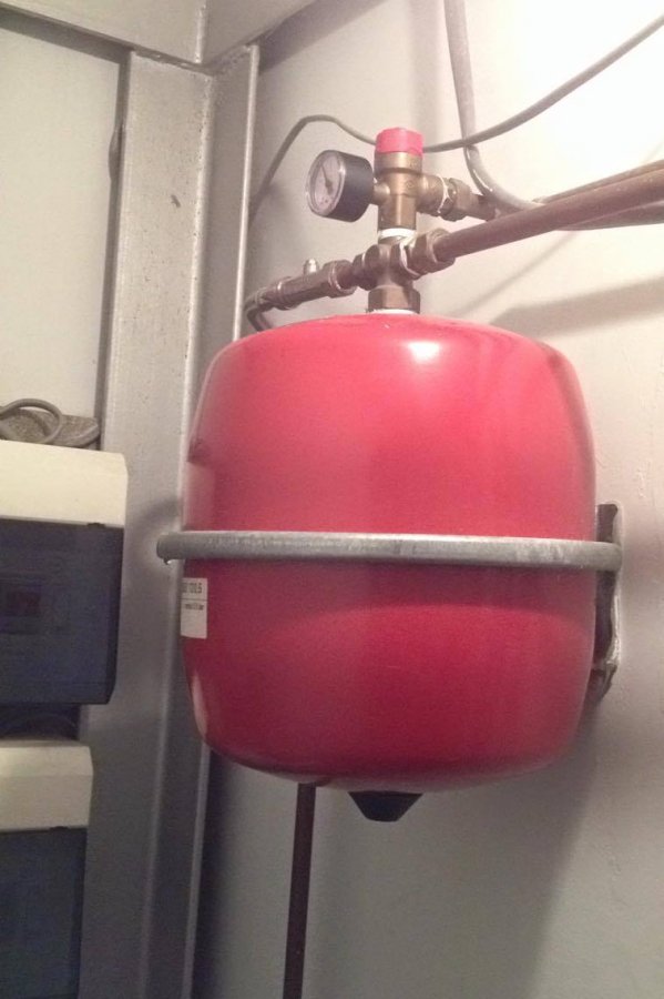

Hi everyone,
We are having problems with our Megaflow. The heating is working fine however there is no hot water and hasn't been for around a week.
Firstly here is some images of our setup so you can see what we are dealing with;
be8eq472z
pcs903q3f
boz7v6d3v
nrmo6oo2j
In terms of information we get back the boiler shows as below when working (currently only heating shows this);
mff2z13a3
And when we try the hot water this;
otfe90b8b
So far we have tried;
  • Simply turning it all off an waiting for a day.
  • Regenerated the air gap.
  • Fixed the pressure on the tank.
Still however we have had no luck. Please save us internet.

Hi Dan thanks for the reply.
I had to use an image hosting site to share the images. If you right click and open the image in a new tab it should work, let me know if it doesn't.
Wow, do you think you could have possibly made those images a bit smaller? I could have viewed them through my microscope then...they don't quite fit the slide at the moment :rolleyes:
OK, Image 2 - turn the dial up and down. Do you hear a click? If you do, turn it up to 60 then go to Image 4 - two silver boxes on the pipework with wires coming out of them. Turn the heating on, wait ten seconds then see if the lever on one end can be moved by hand with no resistance. Now turn the hot water on, wait ten seconds and see whether the lever on the other one can be moved by hand with no resistance. Report back - this should give us some idea of where to start

Muggles - we followed the steps outlined could not move the lever on the box on the right hand side. It is this box that leads the water to the boiler which appears to be the problem.

You have an S plan and Muggles will sort you out
The two silver valves, the way they work is that when your programmer or stats require heat then they have small motors in them that open the valve, the valve then sends power to the boiler and pump to request them to come on, it sounds like the synchron motor in your hot water valve has failed , quite common, but could be other things but that is the most common if you are competent in testing electrical components its easy to test, if not shouldnt be too expensive to get a pro in
The two silver valves, the way they work is that when your programmer or stats require heat then they have small motors in them that open the valve, the valve then sends power to the boiler and pump to request them to come on, it sounds like the synchron motor in your heating valve has failed , quite common, but could be other things but that is the most common if you are competent in testing electrical components its easy to test, if not shouldnt be too expensive to get a pro in
This, pretty much. An electrical test with a multimeter will confirm, but it's quite likely to be a valve head issue. Either replace the motor or the whole valve head, 30 minute job including drinking the tea!
From what I can see the problem is with the Honeywell Synchron valve that is for the hot water going to the boiler (the other is for the heating). Unfortunately I don't have a multi-meter to test it. I opened the cover and there was what appeared to be a reset button, after pressing that I can now move the lever between auto and manual which was stuck before. Trying the system again water flows, the valve motor gets hot but it doesn't appear to be heating the water.
In your second picture (of the thermostat) there is a red button. This is to reset the over heat thermostat, is that what you pressed?
If not then do so that might fix your problem.
