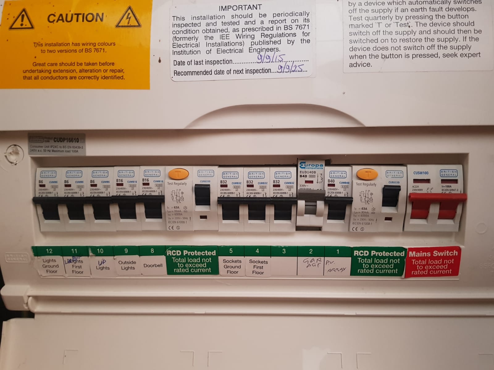

I was wondering if anyone has any advice for me. All my lights for upstairs suddenly went off yesterday night. That includes one bathroom and 3 bedrooms apart from the shower room which the light and extractor fan is still working. Before it suddenly went off my bulb flickered and then it went off completely, my daughter noticed exactly the same thing in her room exactly the same time. Today my partner replaced all the bulbs for all the bedrooms and checked for any loose wires in the celing fittings and wall sockets but they is no power coming into them whatsoever apart from the shower room which is still working. We checked in our RCD board the 2 bathrooms and 3 bedrooms are on one circuit but strangely only shower lights are working and the others are completely dead. This incident didn't tripped anything on the rcd board but they is no power coming through. Any help, advise would be appreciated. Especially at the times of lockdown and kids are at home. No current coming through and it didn't tripped either. Any advice would be appreciated.

A picture of the consumer unit would help to identify what is there. Is it one or two RCD and several MCB or all RCBO
RCD have a maximum current rating, a test button and a value 30mA printed on them
MCB have only a current rating
RCBO ( MCB and RCD combined ) have a current rating, a test button and a value 30mA printed on them,

I have reset it already but no luck. My upstairs lights are on socket 10. This is 3 bedrooms, 1 shower room and a family bathroom. At the moment all lights are out apart from the shower room which is strange. Upstairs landing lights are on a different socket no 11 which is working fine.

Some worrying things in that fuseboard....
i). Garage MCB is the wrong brand and has been bodged to fit the board.
ii). Garage MCB is a B40A - is the cable feeding the garage really suitable for that current?
iii). PV array is also a B40A. Thats one big solar array if that is correct!
iv), Outside lights on a B16A - I hope it isn't wired in 1.0mm2.
v). Doorbell on a B16A - thats gonna be one loud doorbell at 4kVA.
I suggest that you get a qualified sparks in to have a look - there are some worrying signs here.
