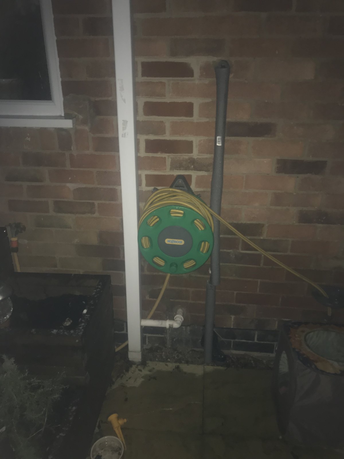

Are you certain that the PRV pipework outside is not dripping ??
Are you thinking of leaving the boiler inoperative for a total of 24 hours and totally isolated for the whole period Graham ?
Yes leaving for a total of 24 hours
I lagged an outside copper pipe and they said know need to do that
I have cable tie a latex glove to that pipe
It was dripping but the ideal fitter replaced a valve to stop it dripping 2 weeks ago
Have you checked it today ,the PRV pipe outside ,is the glove still on ?

The grey flexi pipe below your boiler ( takes the condensate to a drain) can you see where it goes to Graham ? Where / what is it connecting to ?
I will check that in the morning
If it’s the heat exchanger faulty would it be dripping out the grey flex hose
If not where would the water be going

In a nutshell ,yes it would. With the boiler in it's isolated state ,as is now,nowt should be coming out . when the boiler is running the condensate is evacuated via that pipe .

I think the flex grey hose goes behind the units
Not sure until tomorrow how I can access the end of the hose but I bet it goes into the waste pipe
It’s a shame I can’t disconnect the hose near the boiler

Be advised that the condensate pipework is part of the flue ,and as such you shouldn't really mess about with it. But if you can find an open end of it ,that would be good. These days its more common for it to terminate internally . Years ago it would run externally ,until they started to freeze up !!
