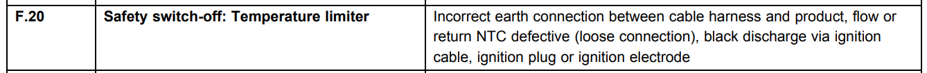

That boiler has an auto bypass valve, so it should not matter if all the rads are off as the bypass should open. The F20 code apparently indicates a separate wiring fault, which has presumably cleared.
