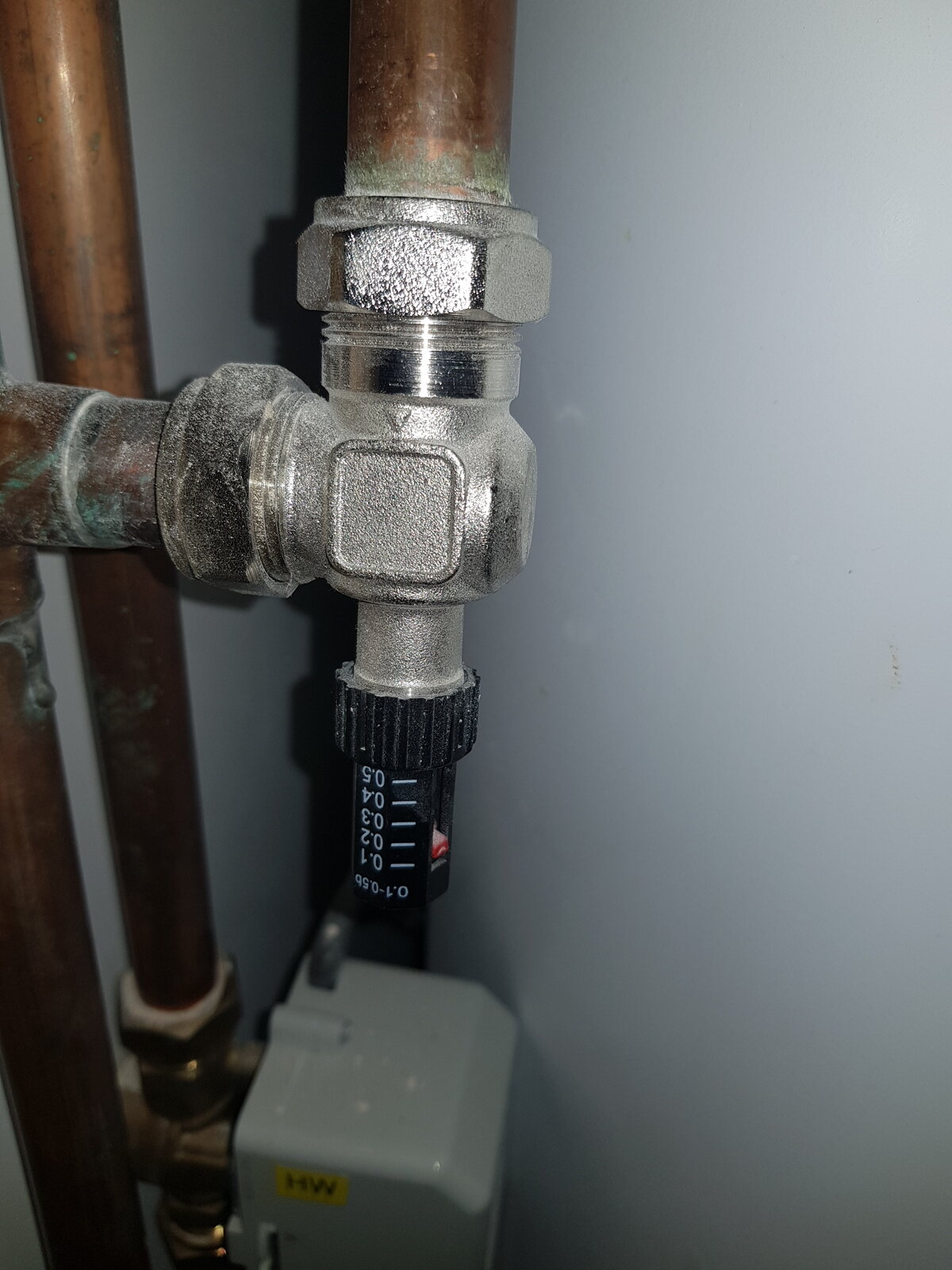

A year ago I got house completely re plumbed with new pipe and heating system.
I got system boiler with unvented cylinder. Issue is when heating goes on and when goes of we can hear a very noise on some pipe like TRRRRRR DUDUDUDU ( not easy to explain) This was noted t the plumber last year and he reduced the pressure next to the cylinder and all was good for a while. Turned heating on this year and noise is back. pressure is already to 0.1 and can`t adjust lower than that. Does anyone knows what`s wrong?

Can you post a pic of the valve you are twiddling with?

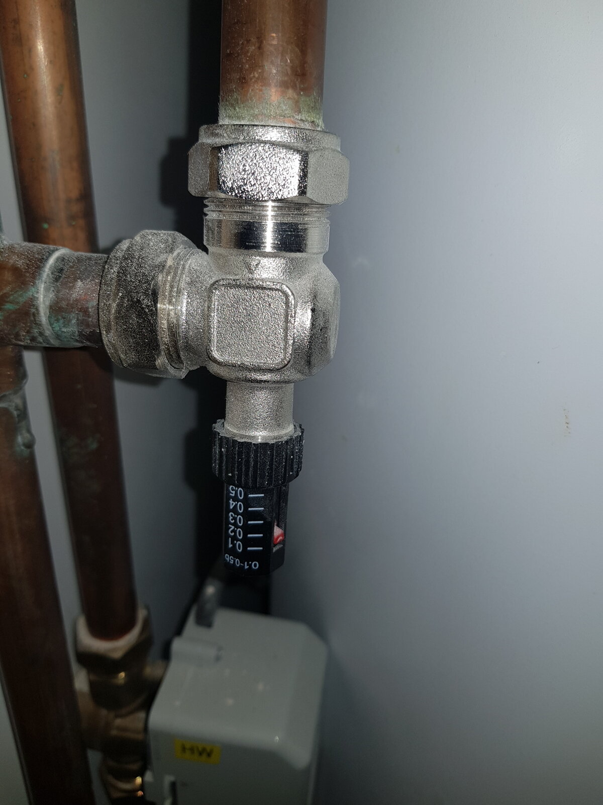

That is an automatic By-Pass put it back to what it was origionally set at and leave it alone, it has nothing to do with your sytem pressure
A bypass valve set to min may be open more than not. This could explain the lack of heat input to the HW tank in the other thread.
Plumber put it to that minimum saying noise in the pipe will disappear

Sounds like ******. The data sheet (myson) tells you to turn it down if noisy but then again, myson would assume your system is designed and set up well.

If the system is run of a ErP pump, then that is perhaps a variable speed pump and probably working on a DP or CP basis which makes the automatic bypass valve you are fiddling with utterly useless. I dunno about the boiler, but if it has its own internal bypass, then you don't want a ABV at all as it will just cycle the boiler outlet through the boiler without distributing heat anywhere else? (Probs why the plumber had this at MAX).

it is on an S Plan so an ABV is required
My hot water is on 24/7 and every night after I had had my shower and got into bed, about 15 minutes later there was a single bang/thump on the system like someone had bashed a pipe with a hammer. Took me weeks to find out what it was and it turned out to be the ABV opening - I confirmed it by holding on to the thing and waited for the bang - I could clearly feel it too. That was on my old boiler when I had no inhibitor in the system. I don't know if inhibitor has lubricating properties but when I added it to the system, the noise disappeared so I assume it was just slightly sticky?
