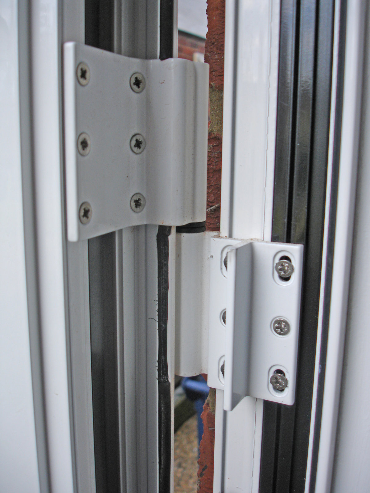

One of the 3 hinges on my side door is making a loud noise as the door opens and shuts. Hard to describe the sound, but looking at the hinge I think it might be the 2 washers in the middle rubbing against each other. It's not a squeak, but a much lower pitch almost grinding sound. I squirted some silicone sealant between the washers which alleviated it a bit. I thought the hinge might be binding, so I tried undoing the screws which attach it to the frame to see if that freed it up but it made no difference. There doesn't seem to be any adjustment on these either, no screws or allen bolts, the hinge pin is just plain flat top and bottom. Any ideas what might be wrong and if there is a way to adjust please?
Good old fashioned 3 in 1 oil trickled in is the best bet. Those bottom screws are on slots to adjust door up and down. Trouble with silicone and wd40 is they only provide a thin coating that is soon worn away oil tends to stay around more.

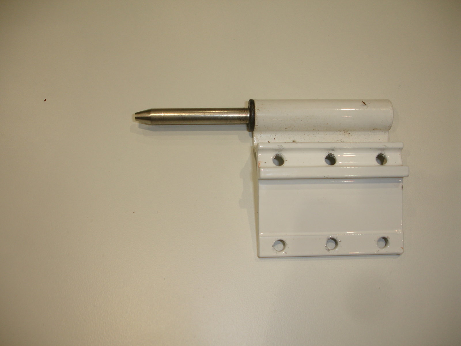

Well it took me a while but I finally got around to taking the hinge off (oiling it had no effect). The 'pin' in the hinge is clearly bent so I imagine it is binding when the door moves, causing the noise and vibration. I assume it's not really viable to straighten it, is it possible? If not then given that the vendor is out of business does anyone know where a replacement can be found? I have googled myself to death but can't see any that match this one. Many thanks.
photo of the hinge, dismantled, please, and the pin.
I unscrewed the part that is fixed to the door and pulled it out with the pin, please see photo. I hadn't realised, but the bottom half of the hinge has some kind of black plastic liner which the pin slides into. It was completely dry so I put some 3 in1 oil on the pin and put it back in. Door now opens in silence.
So I am grateful to JohnD for making me dismantle it, and to footprints who already told me to use 3 in 1 but I had just done it from the outside thinking it would seep in.
Maybe this was all that was missing from the original install, I've no idea if it's supposed to need lubrication or not, but it has certainly solved the problem now.
