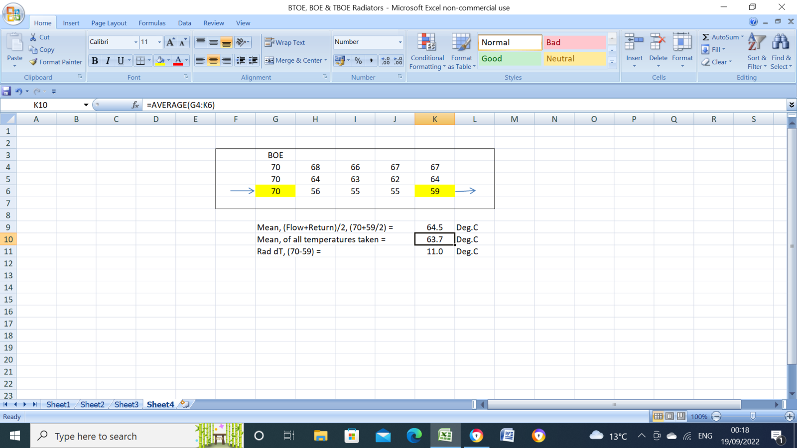

Here is a screenshot of various temperatures I took from a 1.7kw, 1400X400 Rad a few years ago.
The rad is plumbed normally, ie BOE, (bottom, opposite ends for flow/return piping).
You can see the temperature gradients in 3 places on the 5 vertical planes, you can see the water shoots straight up in the first column, then moves along the top and falls to the bottom.
The TRV was fully open for these tests.
