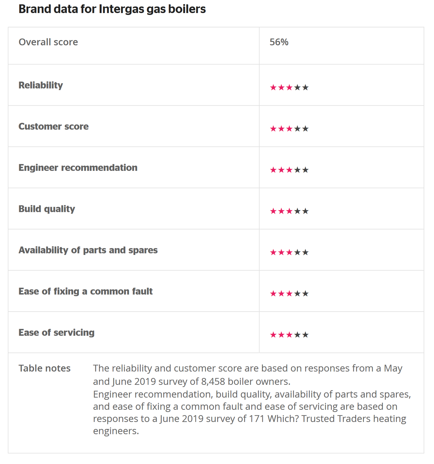

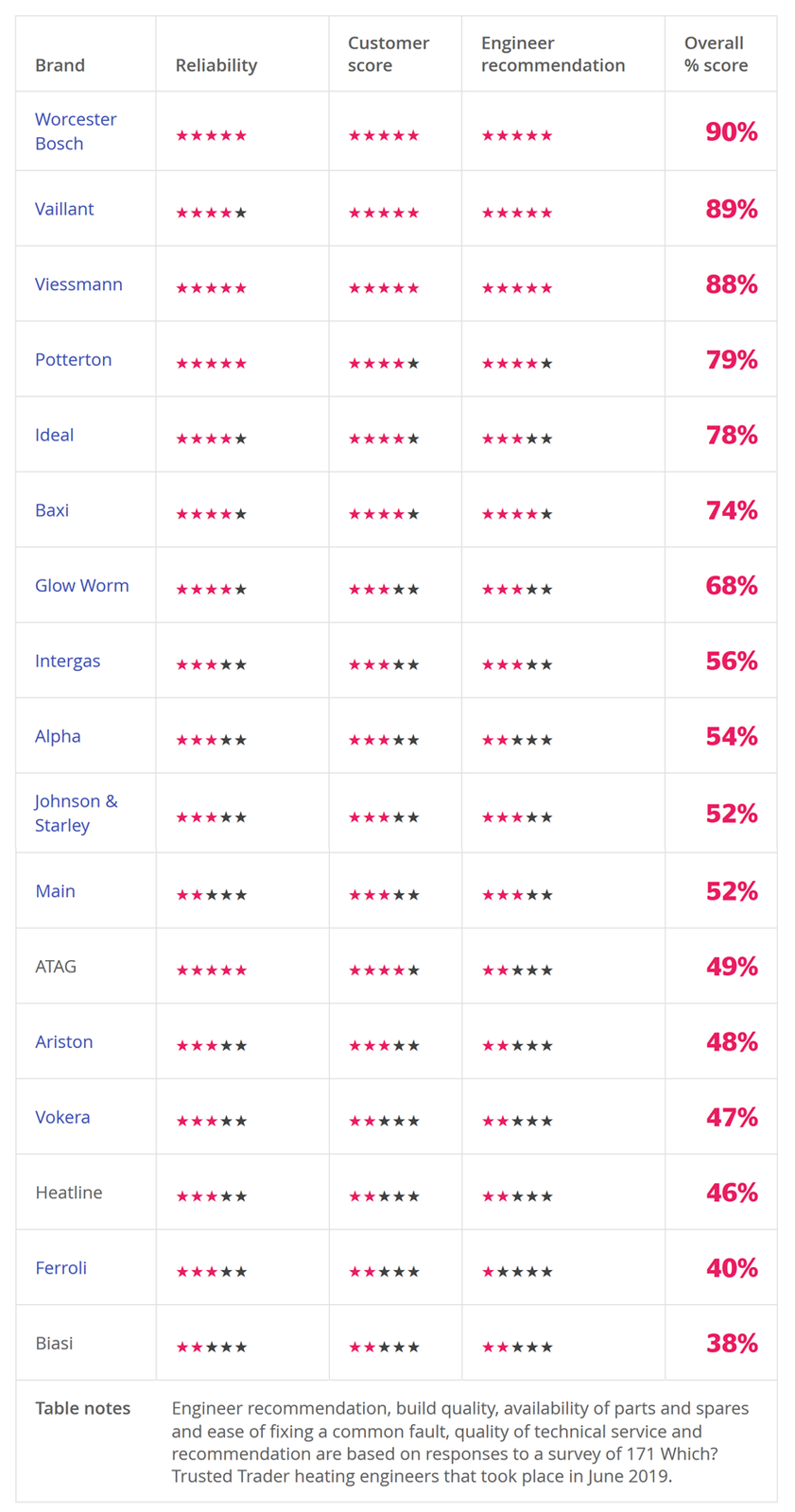

I think I need a new boiler, and what I want to ask about is the Which? tables - whether anybody strongly disagrees with what they say.
I know everybody has their favourites, but it's comforting to see that there's not much to separate the top 3. Unless the table is rubbish.
Also interesting that I've seen quite a few votes here for Intergas, and yet

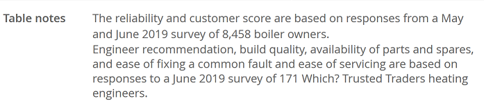

And this comment
veissman are good, but dont let the which magazine fool you they are not bullet proof.

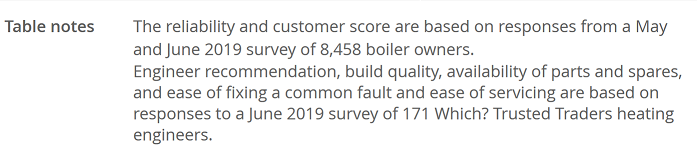

Which magazine gets there ratings from gas engineers, they do not do any of their own testing on boilers.
The problems with asking gas engineers is that none of them are impartial and will choose a favourite of there's, and there is many reasons they have a favourite, some is because they know they can just bodge something in and the warranty will sort it, some because they get extra discount or a rebate, some just because they like the service they get, etc etc.

Very little. As they admit to in their small print, the overwhelming majority of their research, and resultant points rating, is from asking customers/owners what they think of their boiler. Customers/owners by and large just see a boiler as a white box on the wall and don't understand the engineering differences between brands and models. They have no frame of reference to compare their own boiler with anybody else's, and so are not a reliable source of information on the build quality and technical ability of their boiler. Add into that some clever multi-million pound marketing by the larger manufacturers creating a "rose-tinted spectacle effect" and you get a very skewed view of what's good and what's not. I've also heard from reliable sources (although not seen evidence myself) that there is some money changing hands between those manufacturers who are recommended and the magazine in question, which gives obvious rise to concerns about impartiality.
As for recommended/accredited installers, what qualifies an installer to attain accreditation does vary from brand to brand, but almost universally do not take account of the quality of the installation. I know that WB installers accreditations are done on number of boilers fitted in a year, so a Gold installer will have fitted more than a Bronze one. It might be that the Bronze installer is less of a pushy salesman and takes more time and care over each installation, thus fitting fewer boilers in a year but actually doing a better job on each install. Not that I'd recommend you have a Woofter, they're overpriced, full of plastic (and rubber in some cases) and a pain to work on - literally, they're well known for having sharp metal edges inside which can easily cut your hands.
Don't they ask, like they do for cars, "how old is it? How many times has it broken down?"
Having thousands of customers answer that question might be informative.
Reading the responses would be more informative I think.
When I queried their modus operandi I got the answers to that years survey, the brand I work for had, I recall, 55 responses from the 70,000 boilers we sold. We got a 'not recommended' I think that year. The answers were often irrelevant, along the lines of 'the installer left a leak, I was unsatisfied' for which we got a negative mark.
I asked for the names and addresses so we could follow them all up, WHICH refused, confidentiality. I suggested we send them stamped addressed envelopes that they could forward to their respondents to allow them to contact us if they wished, WHICH refused. They also mentioned it would not be worth my while writing to them again as they had no intention of answering.
Much can be learned from looking at advertisements in other WHICH magazines like Travel or Money.
All true, but I expect they know how often theirs had broken down, and whether the engineer could get spares easily.
I'd be very surprised - they would be dead in the water forever if they ever got found out.
That type of rating failure is common to all review sites. I once saw a review of a restaurant, on Michelin's website, which gave the place one star for food, one star for service, one star for ambience and one star for value. Only thing was, the guy had rocked up to a small, popular restaurant on a Friday evening in peak season with no reservation, and they were full, so he couldn't get in, and never experienced the food, the service etc.
It would have been better for them to take legal action.
