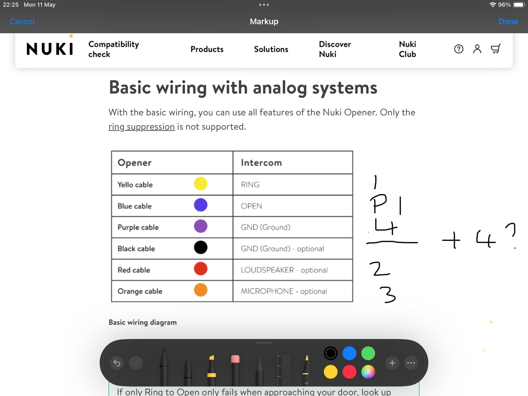

I wanted to connect Nuki Opener to my intercom but it is not working because of my connections
I tried several setup with the Vox 2000 wiring but It seems it is not sending the signal to open the door.
In the Vox 2000
wall (red) -> 1
wall (white) -> 0
top 4 (blue) -> C of P1
wall (purple) -> bottom 4
wall (pink) - > 3
wall (brown) -> 2
wall (gray) - > P1
I did the following connections
yellow with red to 1
purple with purple bottom 4
orange with pink to 3
red with brown to 2
blue with gray to P1
black with blue to C of P1
The Nuki is specifying what is shown in the black images, I didn't connect the clamp as I have no clue what other cable I should connect it with.
I chose the correct intercom, Comelit Vox 2000, but Nuki is showing that I have S connection and I don't so I don't trust the Nuki notes or I don't trust the choice of Vox 2000 on the Nuki App.
can any one tell me what should I connect where?
I found this link which include some specifications about the same intercom but being a noob I don't know how to benefit from it. https://www.scribd.com/.../Comelit-Vox-2000-5-Zica...
As below
