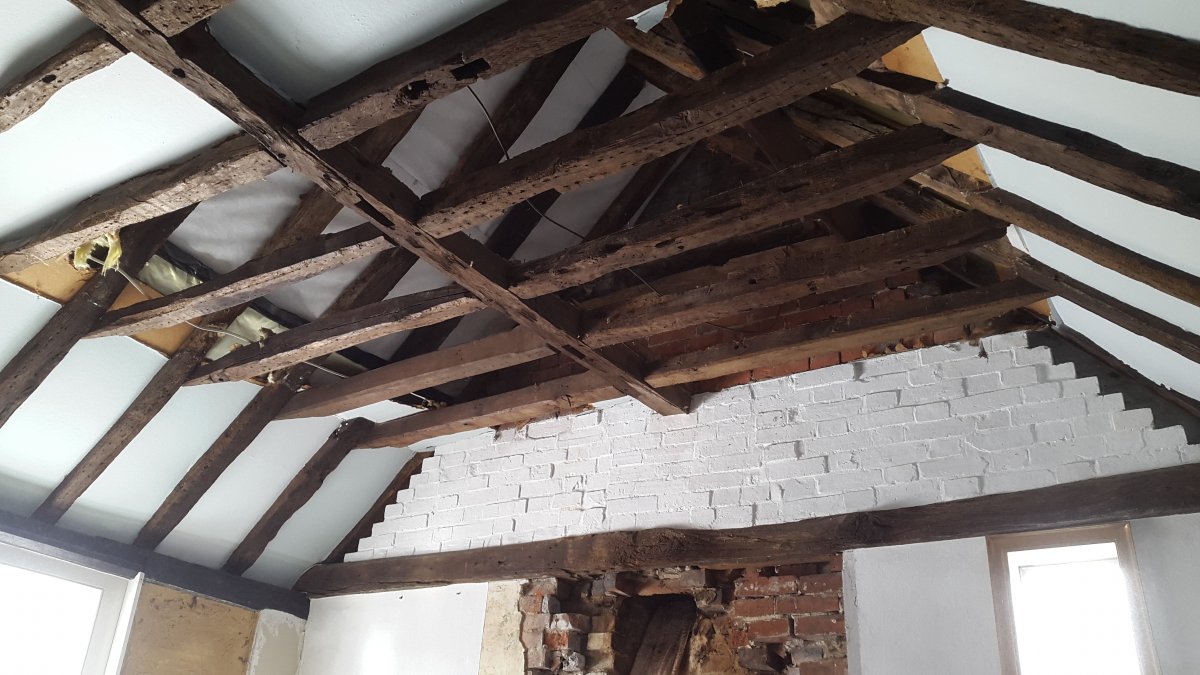

I've just taken the 1970's ceiling down in our 1780's cottage... it was quite shabby and the insulation above was old mattresses and sofa cushions!
So we're now wondering how to reinstate the ceiling without disturbing the breathability of the room... if anyone has any thoughts I'm all ears!
Thanks in advance!
Fyi the white between the beams is roofing felt.

Thanks for the comments...
After a chat with the wife we want to try and open it up and have the ceiling follow the roofline... so we'll end up with the horizontal beams floating in the room. The idea being that we can install hidden lights on top of the woodwork shining upwards to light the room. Oh and she wants as much woodwork as possible on show!
This means I now need to find a way to provide insulation and finished surface between the rafters...
Sheep's wool would be great but think I need to maintain an air gap below the felt?
It needs to be breathable...
Done a bit if googling and think a bit of wood fibre insulation squeezed between each joist with a bit of lime plaster may do it?
I'm really stabbing in the dark so all help appreciated! Thanks

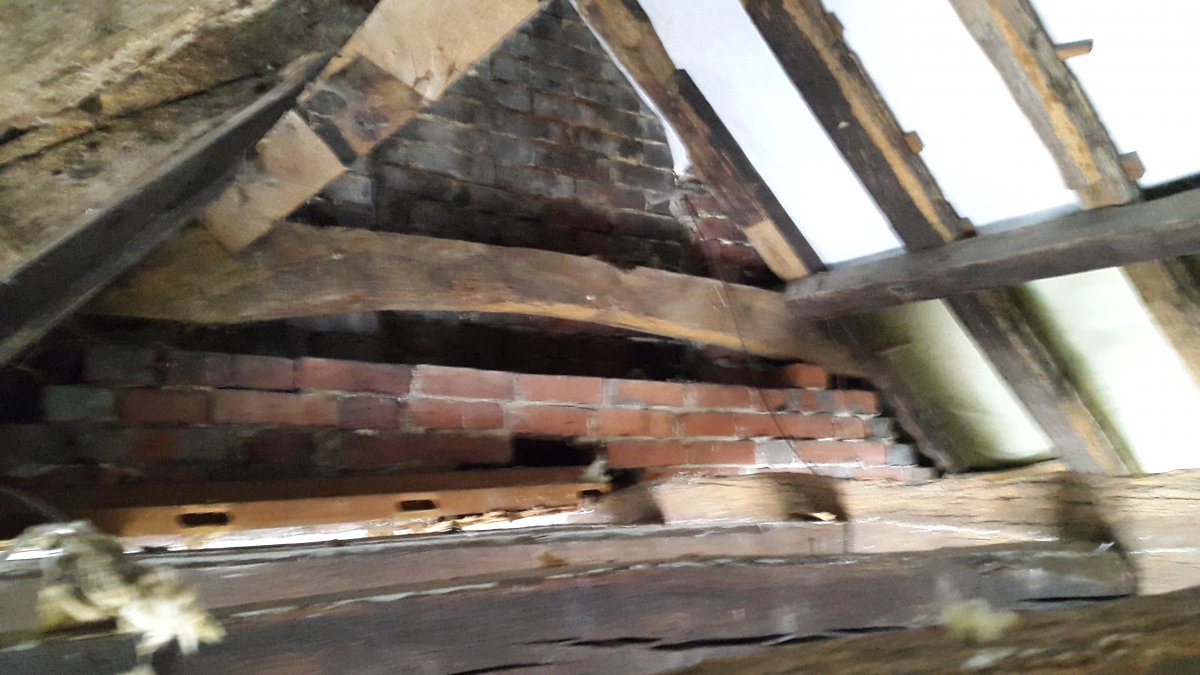

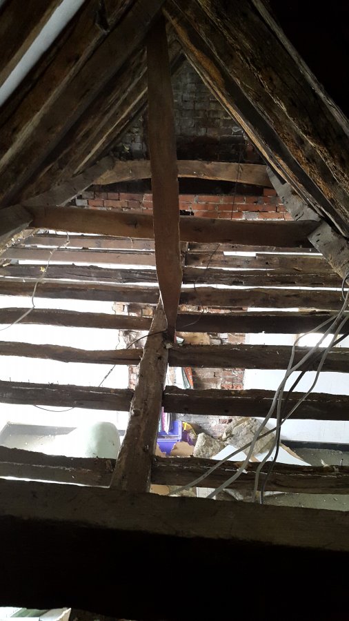

Here's another pic part way through ceiling removal from below... To help you understand what we're aiming for :)
There's not enough depth in the rafters to fit any meaningful insulation. You'll end up with a cold room - although the apex of the roof will be nice and toasty with all the available heat rising!
There already appears to be insulation between the rafters, so you can't really make the breathability any worse...
Yes there was (but not any more!)
That's partly why I've gone for the slightly more drastic option of taking it all out, whilst there was insulation packed in there was also an air gap at the bottom of the ceiling slope to the outside world! So there was no risk of condensation etc as when the wind blew it blew straight into the room! I want to replace it all and make the room airtight - but to do this and avoid problems we need to maintain/reinastate a breathable ceiling.
Unless I'm wrong on this?
