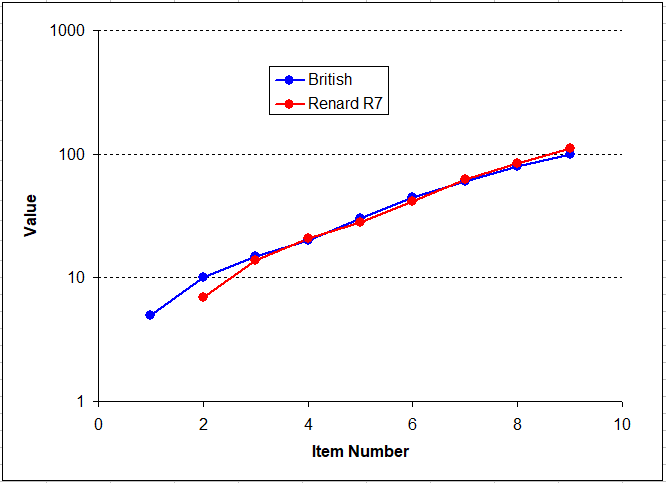

Afaict It's a traditional British Standards vs EN/IEC standards thing.
Products designed to traditional British standards tended to use ratings of 5A, 15A, 30A, 45A, 60A, 80A and 100A with 10A and 20A being less common intermediate values. BS1363/BS1362 are a bit of a strange exception with their 3A and 13A values,
Products designed to EN/IEC standatds OTOH tend to use ratings of 6A, 10A, 16A, 32A, 40A, 50A, 63A, 100A and 125A.
Indeed - they generally use the Renard R10 series which, rounded to whole numbers, gives:
6A, 8A, 10A, 13A, 16A, 20A, 25A, 32A, 40A, 50A, 80A, 100A, 125A ....
[ the mathematical basis being that each number is approximately 1.259 (the "tenth root" of 10) times the one before ]
Most of those numbers are familiar in relation to electrical items - whether as the In of MCBs/RCBOs/fuses and/or as 'maximum current ratings' of other things (RCDs, switches, JBs etc.), the two main exceptions (in those contexts) being 8A and 13A (although 8A and 13A MCBs do exist, although seemingly rarely used). The latter is, of course, very familiar in relation to BS1362/BS1363,and I can but suspect that 8A was considered to usually be too close to 6A and 10A to be 'useful'. Some manufactures do, of course, produce 45A MCBs, which does not exist in the R10 series (but does in the R20 and 'higher' Renard series), I guess because there was a 'perceived need'.
Curiously wikipedia claims that the "most rounded" ISO renard series contains 12. Despite the fact that 13 is closer to value of 10^0.1 than 12 is.
I wonder where the british values came from. Were they also Renard values but just rounded differently.
Having just looked, yes, you're right - and, as you say, it's not really mathematically logical (aka 'correct'!). However, I think you'll find that it' the "least rounded" Renard series that is used for most purposes - and the figure then is 12.5 - which, at least in my book, definitely rounds to 13!
I would have guessed that it was probably based in perceptions of what 'round numbers' would be useful/practical figures to use, rather than any mathematical series. However, if one takes the 'British' figures (including 10A and 20A) which plugwash cited, those figures are (at least, from 15A onwards) very close to a hypothetical "R7" Renard series [ i.e. increments of "x 10^(1/7)" ], although it escapes me as to why anyone would have chosen that!

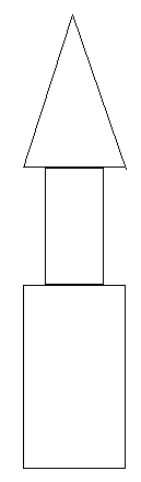

Secondly doing some homework with my grandson yesterday he was doing areas of shapes involving π, answers to various sig figs or d.p's.
The homework is done on a school Ipad so instantly marked, they get 2 chances to get it right, then a second set of figures and 2 chances and a third. after 6 goes it will be classed as incorrect.
He made a calculation and rounded the answer 78.498... to 2sf as 79.0. I stopped him entering 79.0 but 78.0 was marked as incorrect as was 78
A different set of figures gave another answer marginally les than a 0.5 and same thing happened.
For every question there is a tutorial available.
After going through the calculation several times and several ways (which involved finding the total surface area of a shape consisting of a cone on a cylindrical pole on a larger pole:
And getting the same answer each time.
I gave up and looked at the tutorial, one of my methods was bang on the nail, right up to the point they rounded 78.4989.. to 79.0 their method showed:
78.4989 rounded to 78.498+0.001 = 78.499, to 78.49+0.01 = 78.50, to 79.0
...., I was always taught it's multiplied by 1 1/6 but only some values used. I've not looked anything up or done any calculations and never given it a thought until now however just the glimmer of a thought and I think that has to be very incorrect.
Are you talking about the 'British' figures? If so, a 1 1/6 ratio is 1.1666..... but that is appreciably less than all of the 'differences' in the common 'British' figures, so I don't think that what you suggest would be a credibl;e explanation.
I still think the most likely explanation is that they (particularly 5, 15, 30) were simply 'very round numbers' which were 'pulled out of the air' as being appropriate for purpose.
..... I gave up and looked at the tutorial, one of my methods was bang on the nail, right up to the point they rounded 78.4989.. to 79.0 their method showed:
You were right, and they were plain wrong! What they have done, by repeatedly rounding, is to invoke what is known in the trade as the concept of the 'propagation of errors'.
To avoid such errors, one must round 'in one go' on the basis of the entire figure to be rounded - that way, one only gets a 'rounding error' once, rather than multiple times. In other words, ANY number less than 78.50000000000000000..... rounds (to 2 signif figures) to 78 - and that includes 78.4989 and even 78.499999999999999999999999...
Quite frankly I don't know which system, it's just something from the mists of time which I hadn't given any thought to until this thread, my initial intent was to correct/augment your information but even without making any calculations I realised it was way out of kilter with both, however seeing your table everything apart from the 80-100 step is based on multiples of 1/6; ie 12/6, 9/6, 8/6. I'm not trying to clutch at straws with this by any stretch of the imagination.
Maybe the explanation to me was wrong or I remember it wrong but I don't even recall were I got it from.
I'm sure that was the original case and not only in UK, I think your list, or something relatively similar, was fairly universal.
That's mathematically true, but probably a 'co-incidence' and/or 'red herring', not the least because, as one moves through the values, the number of multiples of 1/6 goes repeatedly 'up and down'
It certainly seems like the most probable original explanation (of the 'British' system). I don't think there is any doubt that what we now have is based on a Renard R10 series.
