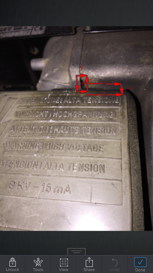

...but I was in the utility just now (with the light off) when the boiler fired and when I looked down at it I could see the boiler flame through a couple of gaps in the "solid metal" riello burner cover !!
Is this normal or (as I suspect) does me being able to see a flame through gaps in solid casings mean that a seal has failed or has not been replaced properly during the service? The 2 guys I have had look at it so far thought the illegal tigerloop was fine so I Am seeking more up to spec/higher guidance.

You need to get the fitters back the gap can let carbon monoxide out which ain't good.Show them the gap and get them to sort it.
Carbon monoxide was my initial worry but I have a carbon monoxide alarm and according to it the boiler is burning very clean (also according to the emissions analysis) so it is almost as good as new.
Managed to add Picture highlight the points where. Flame is visible when the burner is firing. My thoughts are that if I can see a flame through it the fumes (albeit it carbonmonoxide free) can escape and could be what is causing my smelly boiler problem...

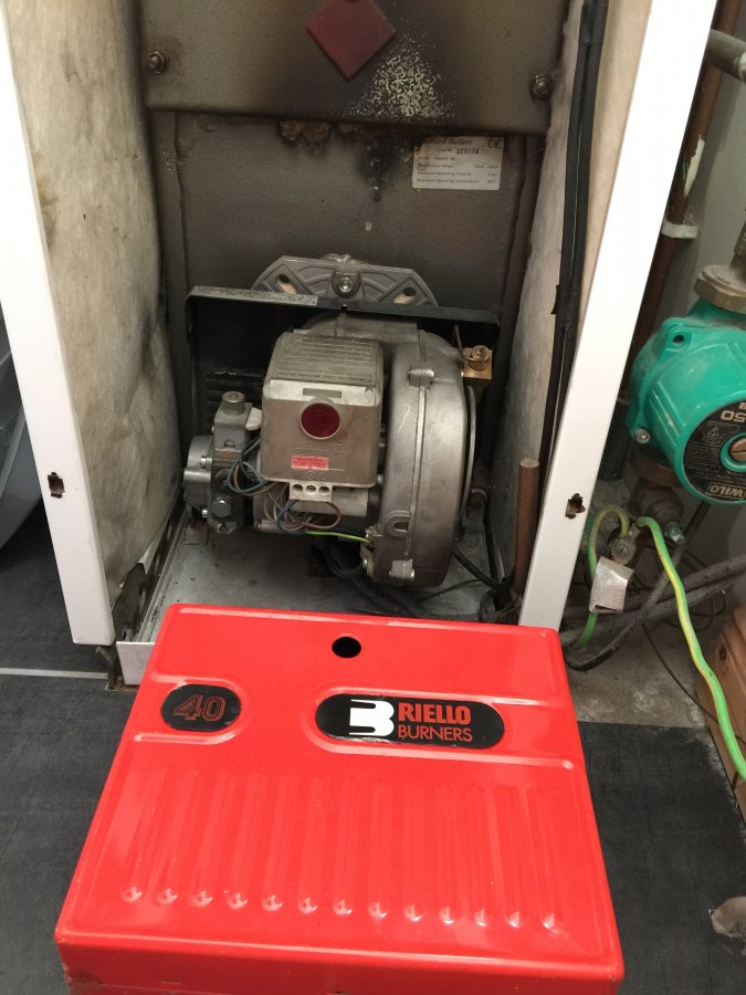

Sorry to be a pain, but just give us a shot from a bit further back, will you.....I was expecting to see a Riello RDB burner with a bright red casing.
For sure there is a foam seal (heat resisting) between the burner and the boiler which could be adrift but I can't identify the problem so far.
John :)
I'll take a pic and post it now. But you are right, I was advised to leave the red box cover outside to air for a few days as it got a some oil on it from the leaky o ring on the piston. Having the red box on makes no difference to the fumey smell though.
Cheers burner man, The spot I can see the flame though is obscured in the picture but I have highlighted it again to try and make it clearer.
On a mectro burner there is no a seal between flange and burner it's metal to metal with an o ring on some models,it looks like there is a leak of gas from the top of burner,means you prob need a new flange and heat proof gasket plus new o ring.Part no B-GSK and B4501 and 3007178 from
