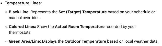

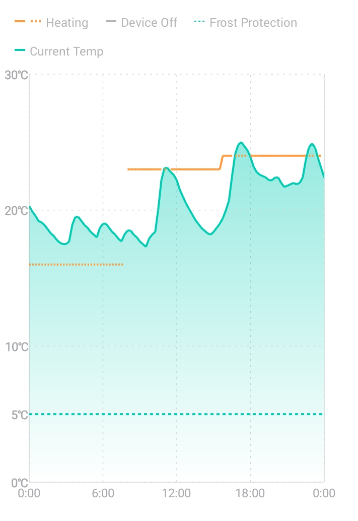

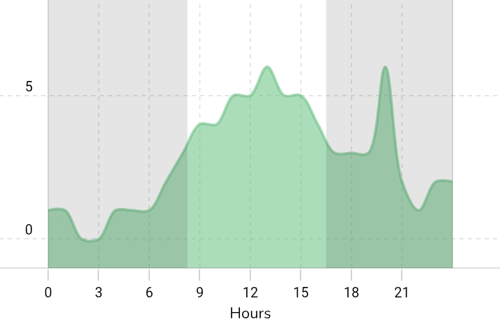

OK, the system works, and is reasonably cheap to run. But the hysteresis is rather high. 1768777989087.png1768778288983.png1768778350088.pngIt took some time to work out what the graphs are but 1768779625402.png found it in the end, the green bit (last graph) is outside temperature, green line actually temperature, and black line the set temperature. The first graph is from the Kasa TRV head, and does show the hysteresis, which looks massive, 18.2°C to 25°C, but this is under the window, where we sit it not as much variation.
But the question is with an on/off gas boiler what should be expected.

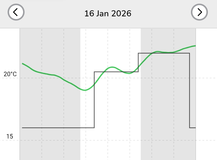

The green line, suggests the heating came on, before the black line suggests it should have done. That it over-shot the 21C setting a little, but there was less over-shoot when the target was increased to 22C.
I doubt there would be much difference from an old on/off gas boiler, or even a modern modulating one, but a more modern modulating boiler, which included some clever controls, would be able to avoid the over-shoot, and under-shoot.

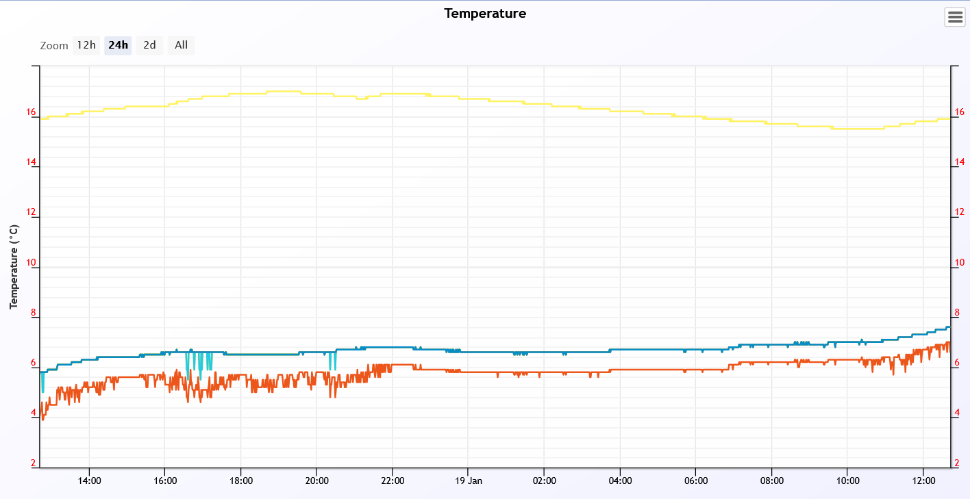

Here is mine, which includes the 'clever controls', note there are no wild oscillations in temperatures... The yellow line, from 10am, when the set temperature was changed from the night 14C, to 18C, in the coldest area of the home.
Thank you, @Johntheo5 that's what I wanted, basically to know what was normal. In my mother's old house with a modulating boiler, set the TRV to 20°C and the room was (reported at the TRV head) 20°C +/- 0.5°C and once room was at temperature the radiator just stayed warm, there was to all practical purposes no hysteresis.

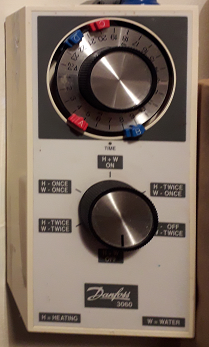

I found wiring and a programmer, 1768826345416.png but found the triple and earth changed colours end to end from red, yellow, blue to brown, black, grey and one core open circuit, not a clue where joined, so it was how does one control heating and DHW with two wires, and power the boiler, my answer was to use a local supply to boiler, and used Nest Gen 3 (happier with only 12 volts on those wires) so the main house hard wired and controlled from the thermostat in the hall, this did not work very well, hall cooled too slowly. So heating worked now, but needed improvement.
