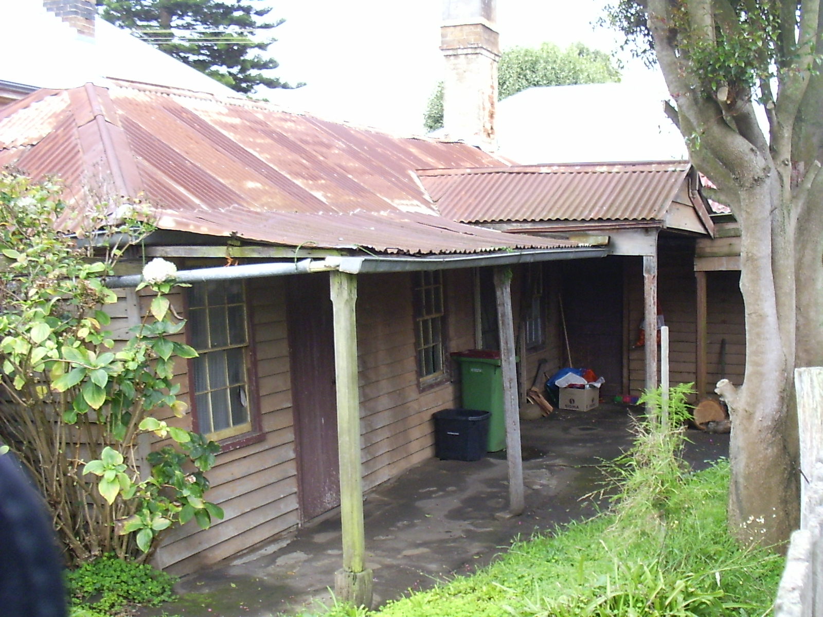

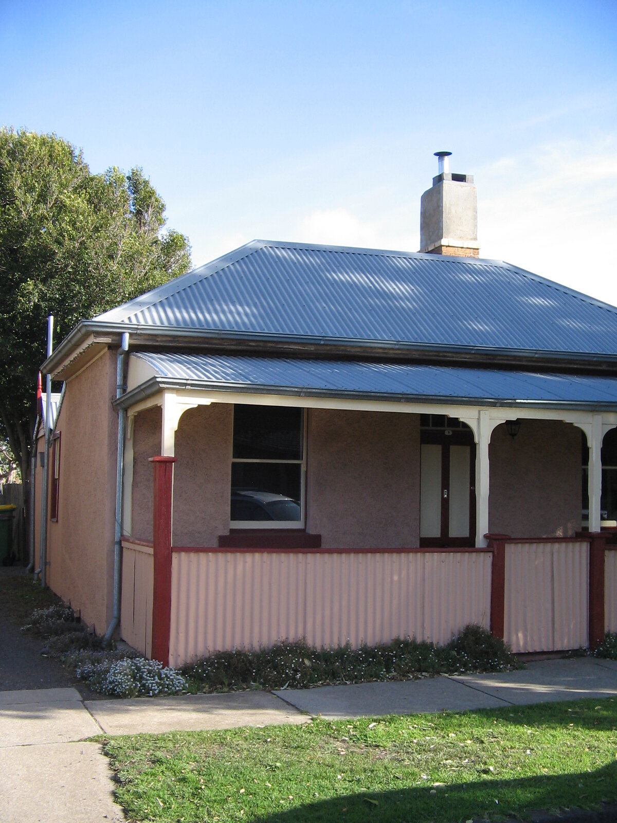

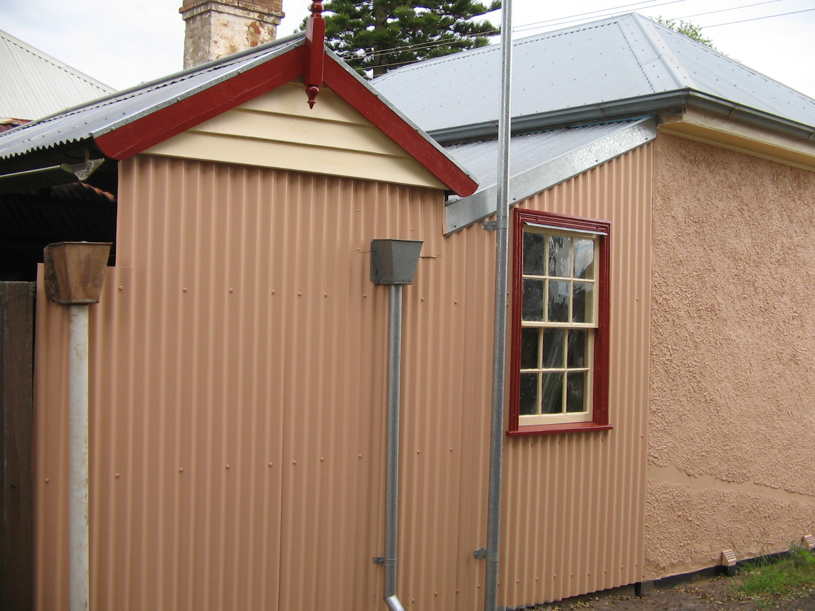

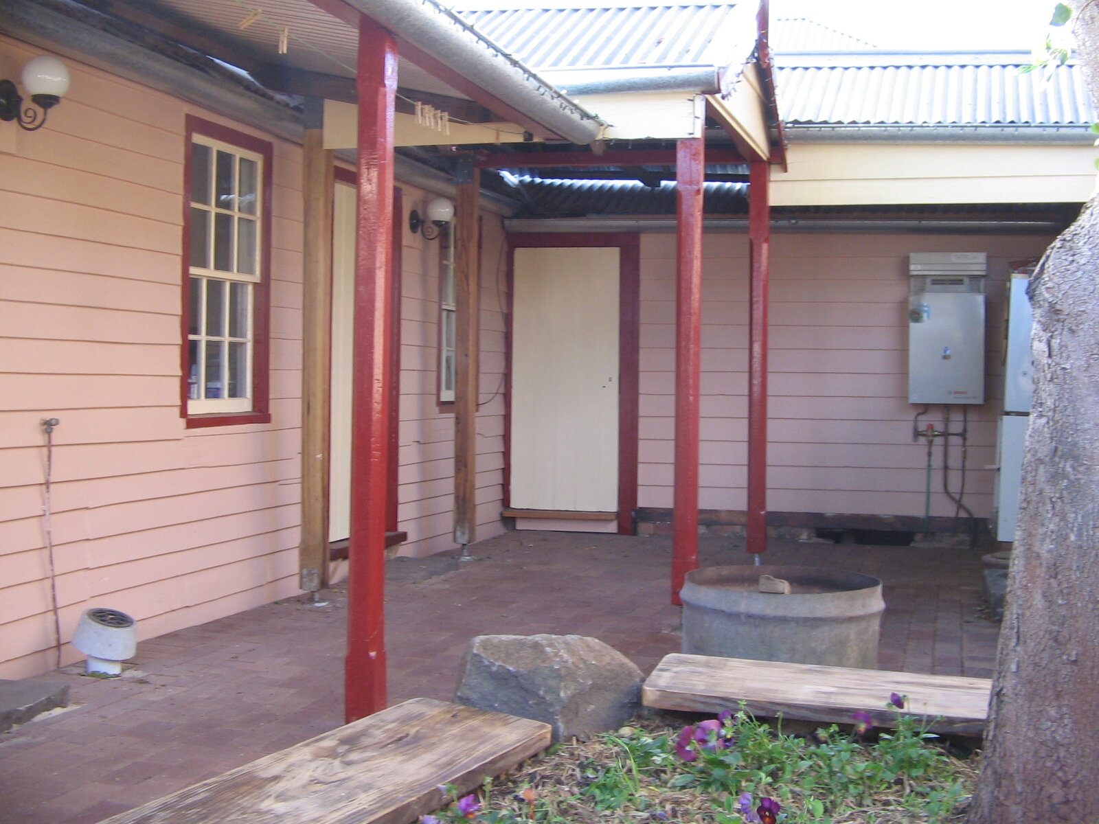

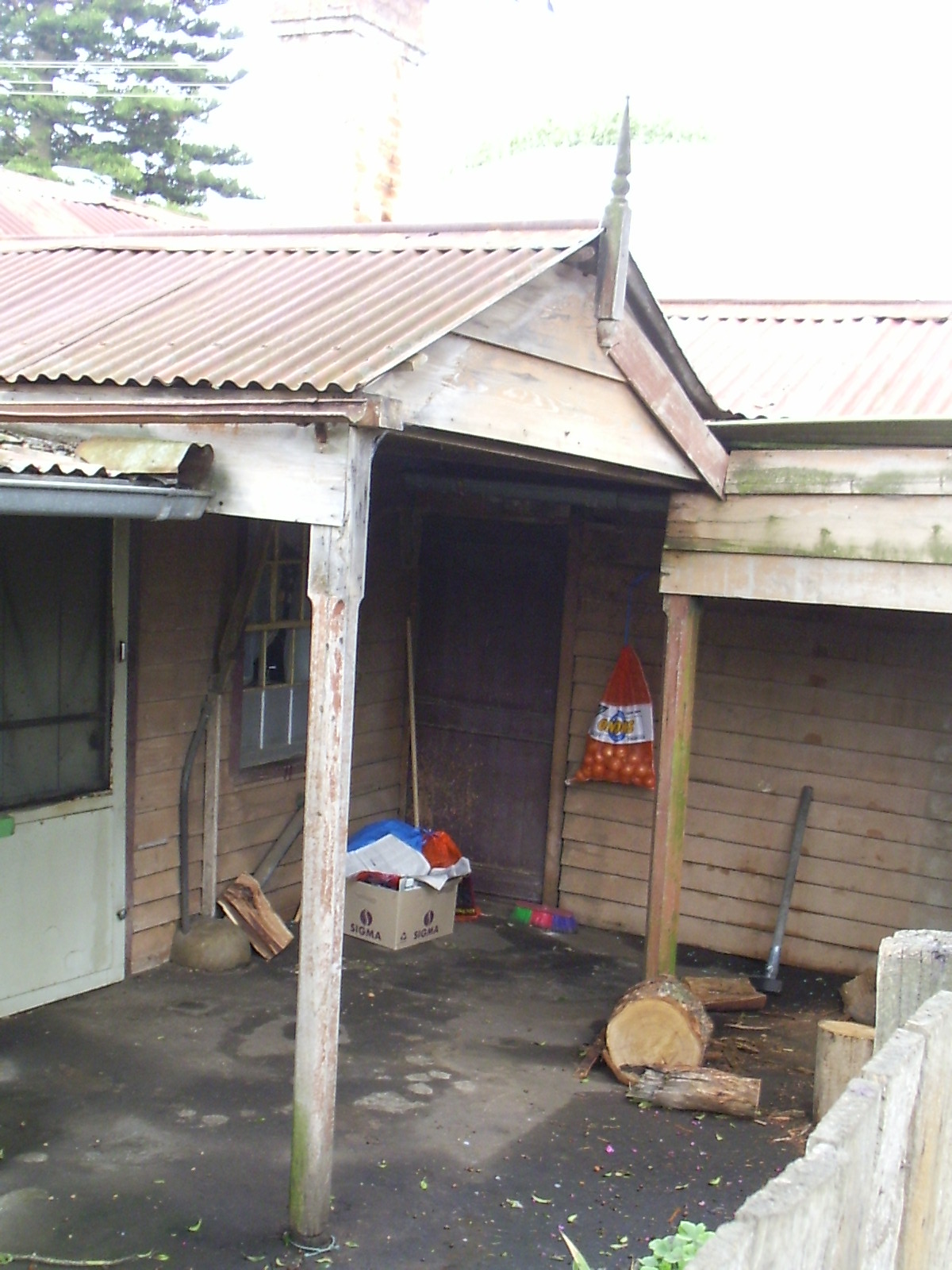

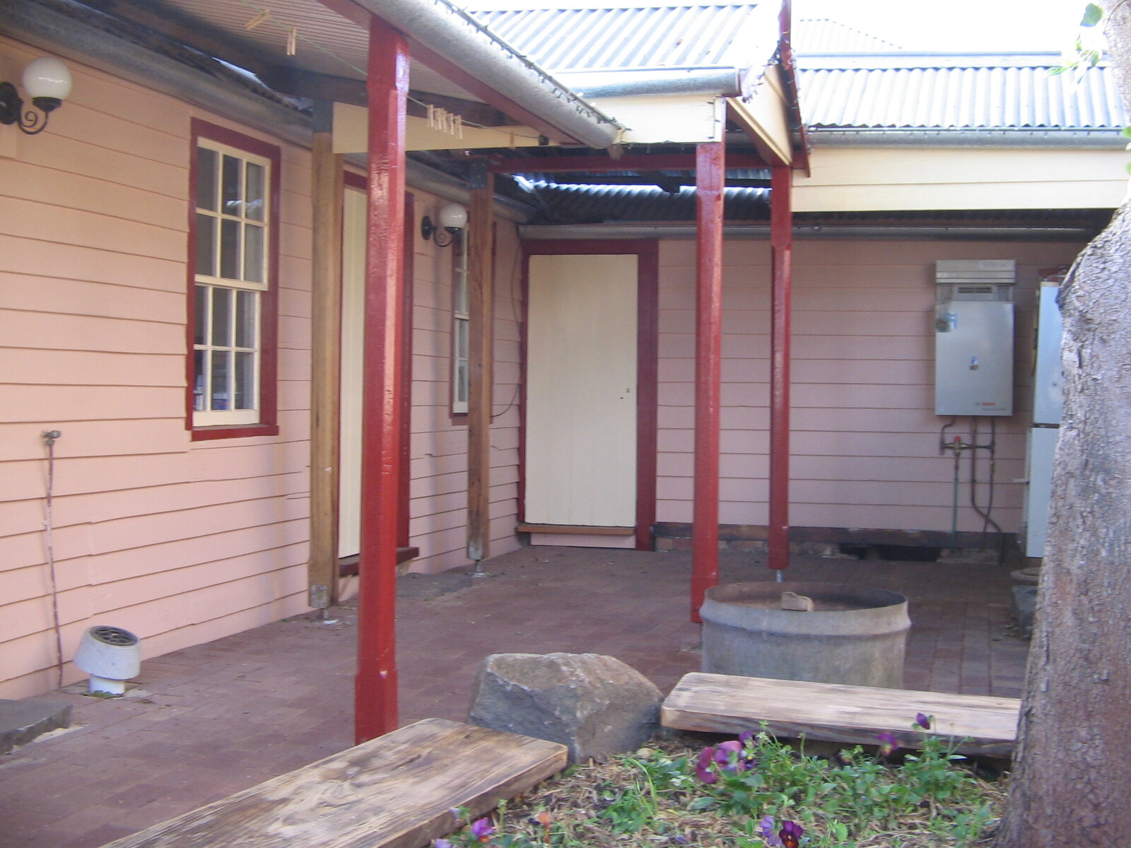

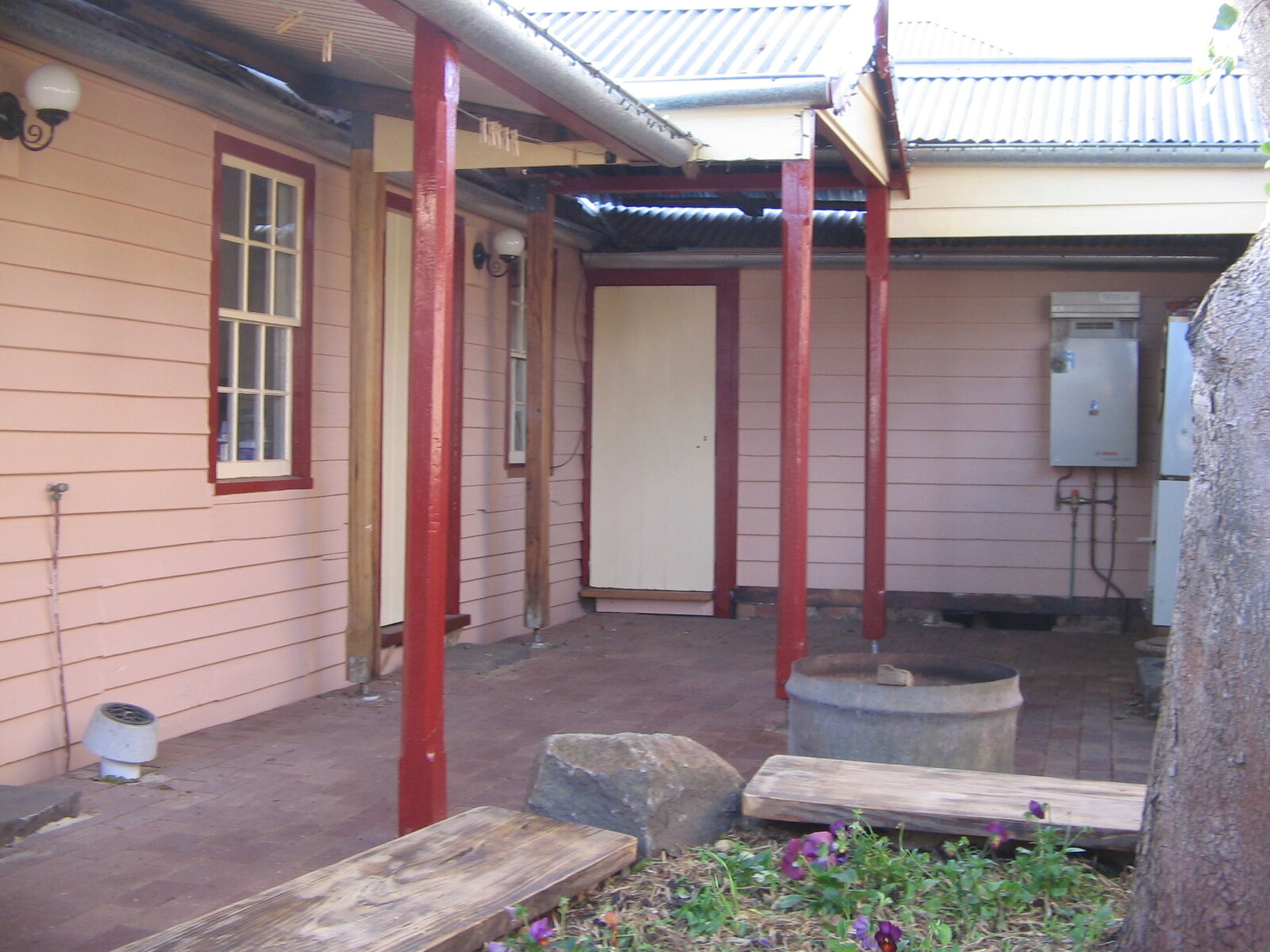

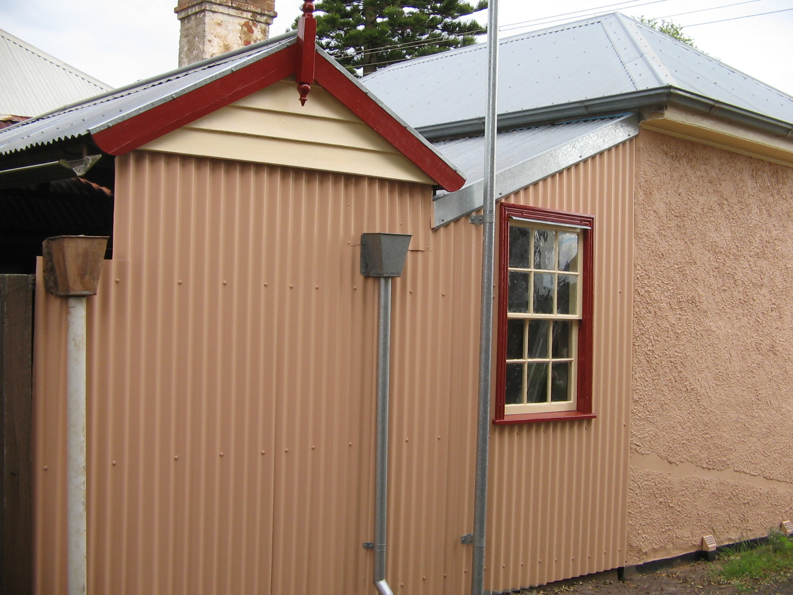

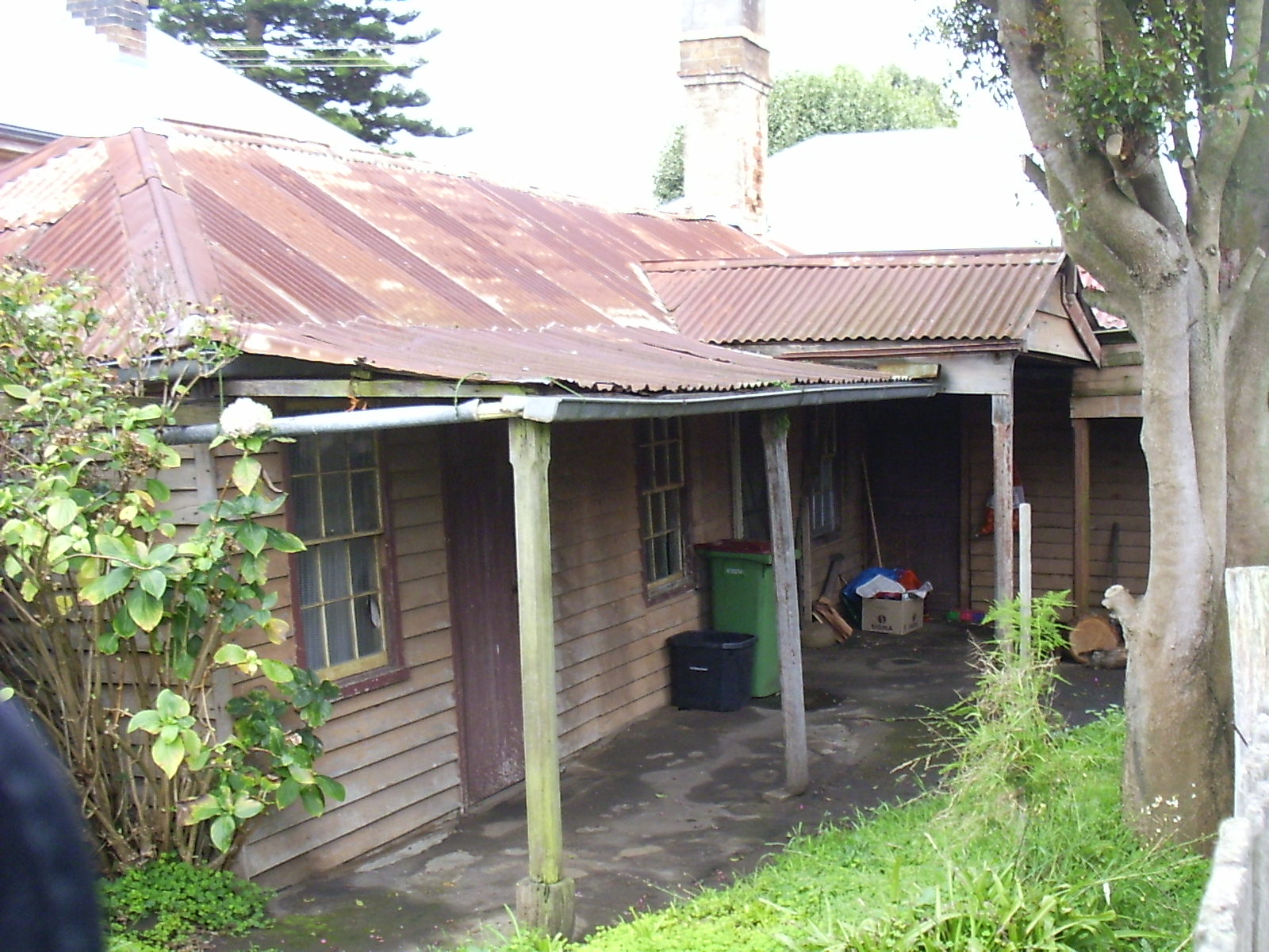

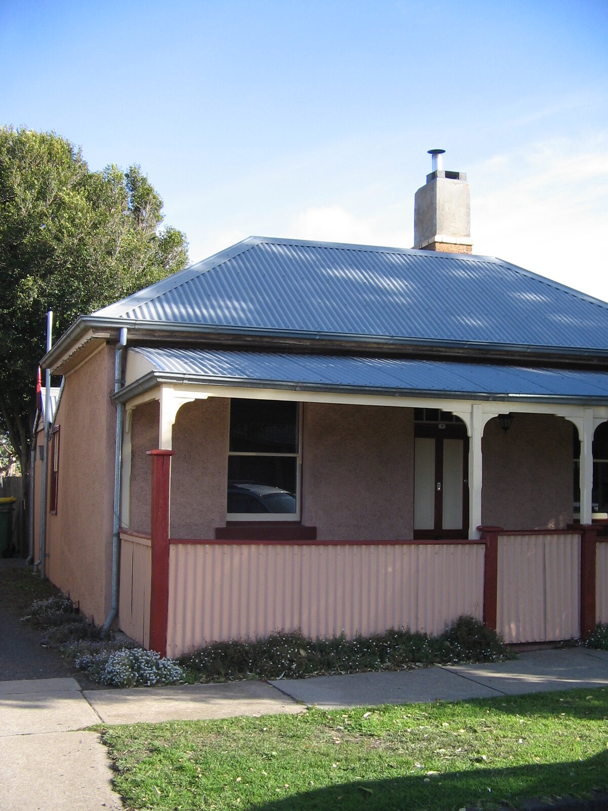

OOI, some pictures of my BiL's historic (listed) house in Australia
9 Tyers Outside6 (1).JPG 9 Tyers Outside7.JPG 9 Tyers Outside15.JPG 9 Tyers Outside20.JPG 9 Tyers Outside17.JPG
That house looks great. Houses with tin roofs might work well in places in Australia with low rainfall, but living somewhere with lots of rain it must be quite noisy.
