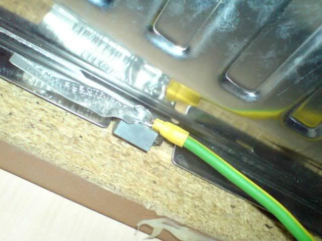

I found this today on a rewire signed off by BCO.
The job was done to the 17th Ed., according to the paperwork.
More like 15th, if you ask me!

I can see it is meant to be a earth to a kitchen sink.
The only thing I can actually see wrong is the fact that the aluminium clamp warning plate is folded over the connection.

It has not been a requirement to install supplementary bonding in kitchens since the 15th edition regulations, which were superseeded by the 16th edition in 1992.
Many folk still do it though.

I am updating a shower room and about to tackle the issue of bonding. I thought I read on a recent RF post that bonding is no longer required in a bathroom if all incoming circuits are RCD protected?
If that is the case, does it imply that people are now RCD protecting lighting circuits? (mine aren't - only the Fing)

My understanding of the 17th is that no bonding is required in shower/bath room as ALL circuits must be RCD protected - power and lighting.

Not everrone is yet, but the bathroom light will be compulsory once the 17th take over, not neccesarily the whole lighting circuit though.
I dont think the supp bonding can be just dismissed,or removed.
Only if certain other regs etc are also taken into account and comply,can that be considered.

Well if that's the case, will manufacturers start making split load boards to allow 3 splits? One side for cooker, immersion etc - one side for RCD sockets, one side for RCD lighting? (excuse my ignorance if they do already)
Afaik
Existing boards could get round it (An rcbo on the non rcd side just for the bathroom light on a radial is one way)
However makers are all coming out with newer boards, taking various combos of rcbo's and various rcd's etc.
